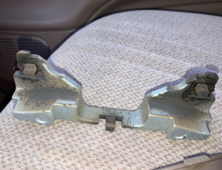

    I’m posting here because this thread came up when I was searching for clues about what turned out to be a much simpler problem.
    If the clunk is more of a metallic clank, and it feels it’s coming from inside the wheel rather than somewhere down the column, it’s likely to be a failed vibration damper. This definitely happens on 2003-2004 Tundras and Sequoias, and I’ve heard of it happening on 05/06.
    Note: Be sure to disconnect the battery and bleed off any capacitance before opening the steering wheel!
    Removing the failed vibration damper is a quick fix with simple tools, and there seems to be no adverse effect. I recommend doing this, it’s much better than leaving the broken part floating inside. On my truck, it started to jostle the clock spring and fire the horn when I was parallel parking. Not cool.

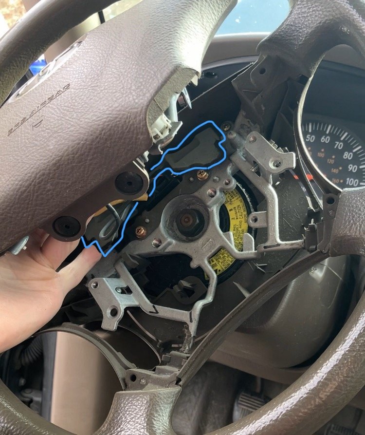

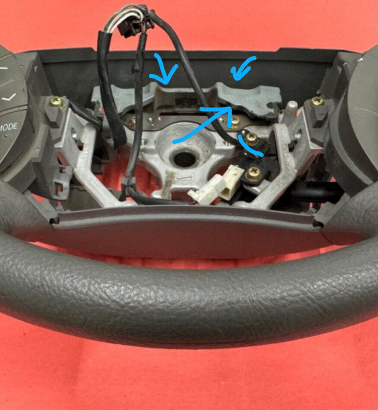

    Over in the steering wheel info dump thread, you'll see some pics in the specific reply I just linked. Seems like the later year 1st Gen Sequoias and the 4Runners had the weight. My 2006 Access Cab didn't. Super weird.
    And lemme tell you, they must've threadlocked that SOB weight in there, because the damn thing WOULD NOT come out without some butchery. Total pain in the ass. There's one other member who had the clunk you mention, in another thread, because their weight detached from its metal bracket.
