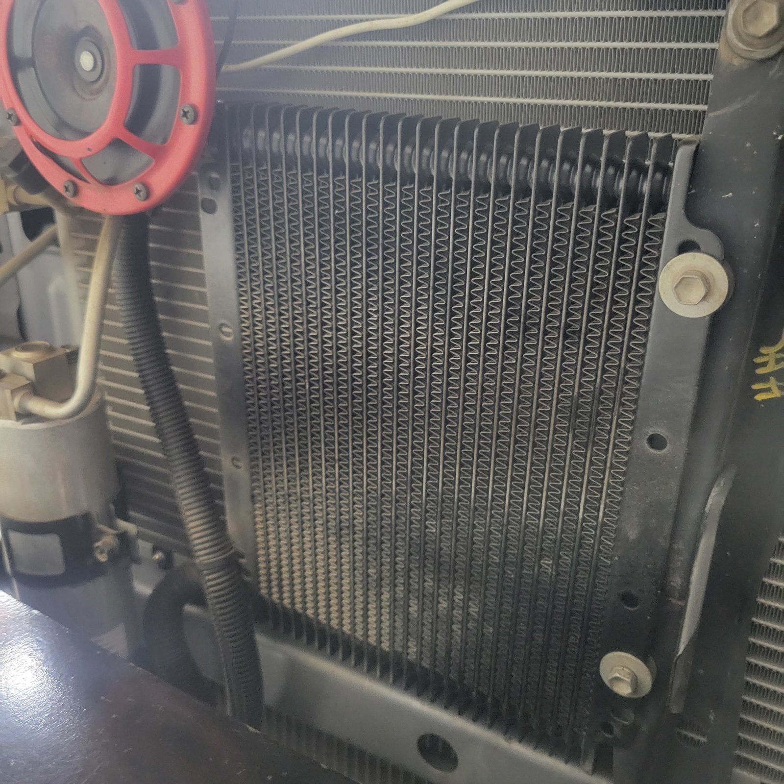

    Install an inline oil cooler to reduce the heat. Heat is what breaks down the seals quicker.

  10. Jul 18, 2024 at 5:43 AM
    FrenchToasty
    Sep 15, 2019
    #36156
    18,385
    Mo
    The SoAz….. big surprise
    Bone stock
    It should already have one
    Cruzer[QUOTED] likes this.
  11. Jul 18, 2024 at 6:03 AM
    Cruzer
    Cruzer Wheeling Full Size
    Oct 12, 2020
    #53461
    3,246
    Cruz
    Sunnyvale, CA
    Build Page: Cruzer's Re-Build for the Rubicon
    Can never be cool enough :cool:
    bmf4069 and FrenchToasty[QUOTED] like this.
  12. Jul 18, 2024 at 6:11 AM
    FrenchToasty
    Sep 15, 2019
    #36156
    18,385
    Mo
    Bone stock
    It definitely isn’t anything fancy, could upgrade for sure
