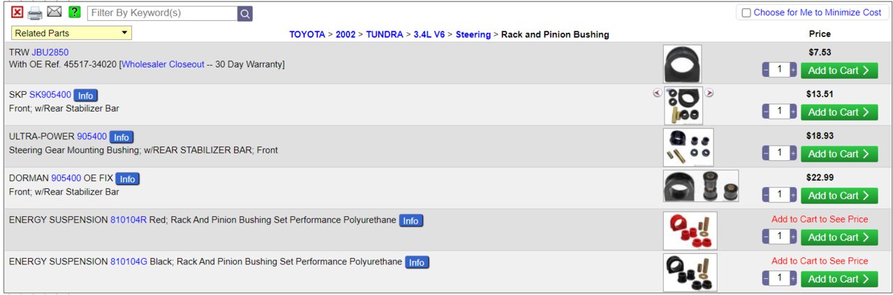

    I was searching for a post I saw. But could not find it. I’m redoing front end. I saw red bushings,polyurethane. For steering rack. Just cant seem to find it. Can anyone send me company link something.
    I have a 2001 tundra V6 4x4 automatic access can
    TIA

    @Mhagha You need a build thread to keep all this stuff about your truck in one place. Anyways... this link will take you to RockAuto, and then you can decide on whichever of these bushings you want.
    I have the red energy suspension bushings on my 2002 V6 2WD.

    Go with Energy. I've been using their stuff forever. Poly is great, just make sure you give a little lube at install to cut down on metal-to-poly squeaks. I prefer rubber, it's smoother, and no squeaking, but poly is, like, lifetime longevity.

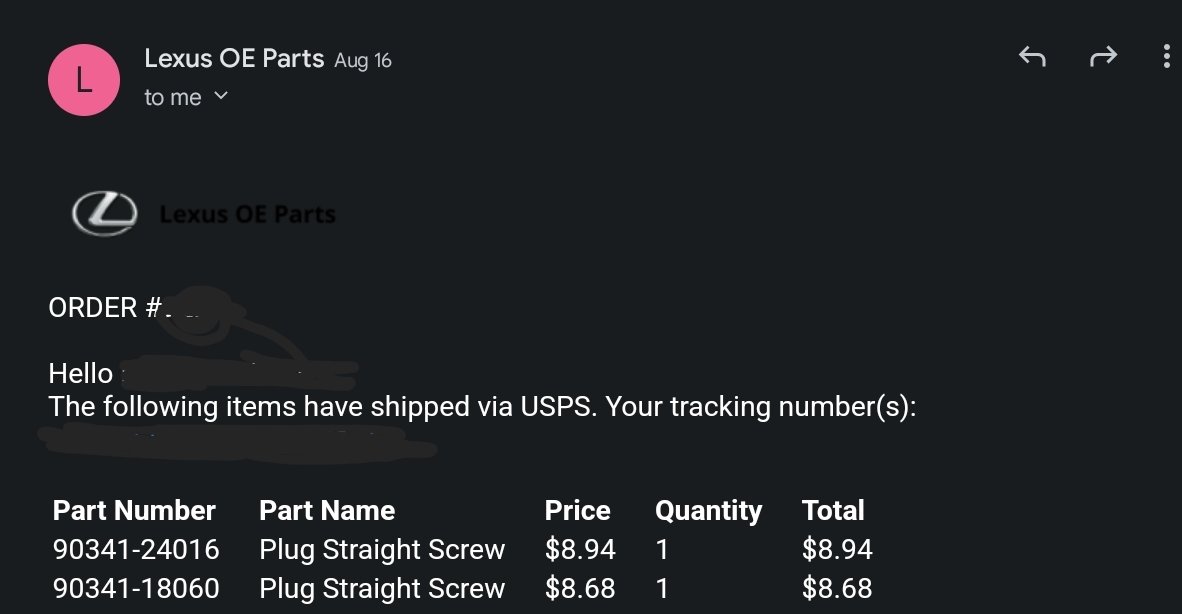

    I see that some guys changed the front diff plugs to Lexus drain plugs. Is this good to do? I’m about to drain it out and wondering if I should get new ones?
    And I do know to try top plug first.

    It's better because it won't strip out as easy as the 10mm hex head when it gets stuck in there. I didn't know it was a thing when I did mine or I'd have done it.

    Correct. I got these part numbers from @des2mtn. You'll have to order from a lexus dealer like I had to, or maybe a Toyota dealership can get them if you call, and ask.
    I could not get the drain plug out so I have not installed either of them yet. They look like they'd fit though.

    I also thought each plug had a washer ?

    I think each plug has its own washer. I can't remember for certain right now, and I never opened the package I got from the Lexus dealer.
