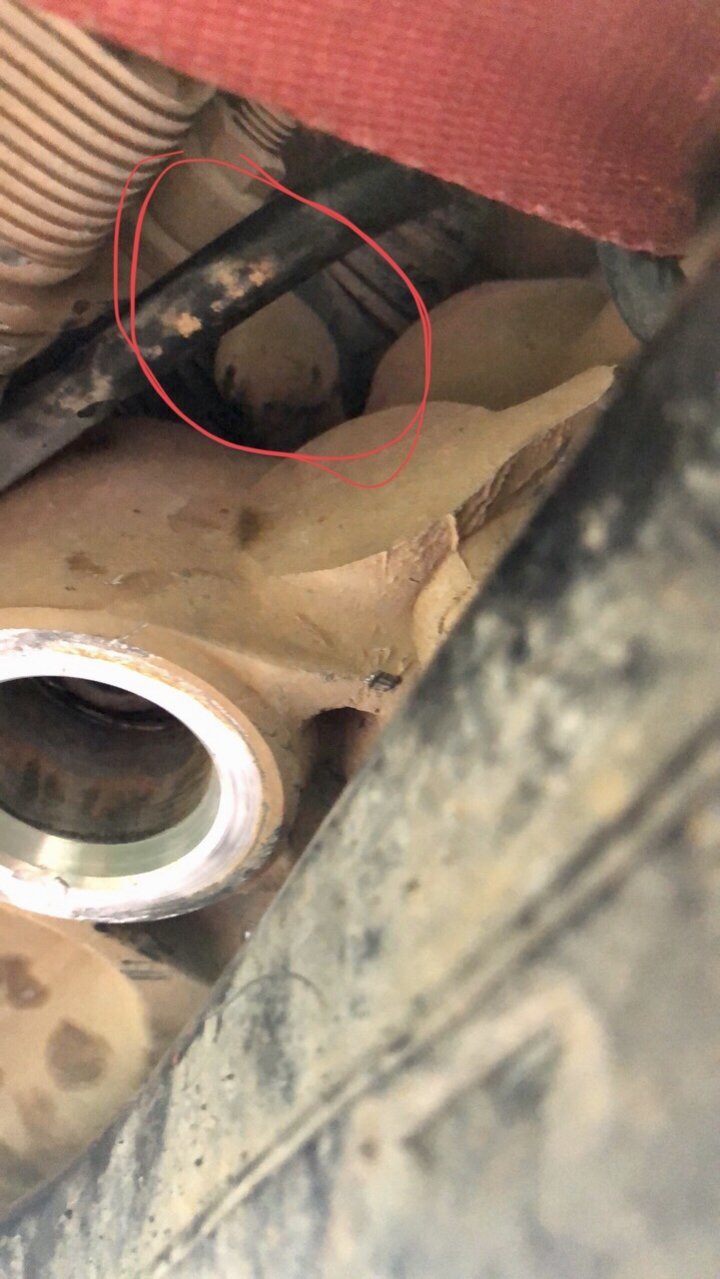

    I’m having a hard time getting the upper driver side bushing out, it’s hitting the oil filter housing. People that have done this before, how did you get it out?? Need HELP!

    Woooo! Just got the last one out without taking the oil filter housing completely out! Really didn’t want to take it all out. I removed the cap and filter and the bracket on the motor side that goes to the block and it gave me enough space!

    Just a little bad... also I feel like a fiddler crab after swinging a 3lb hammer up that many times

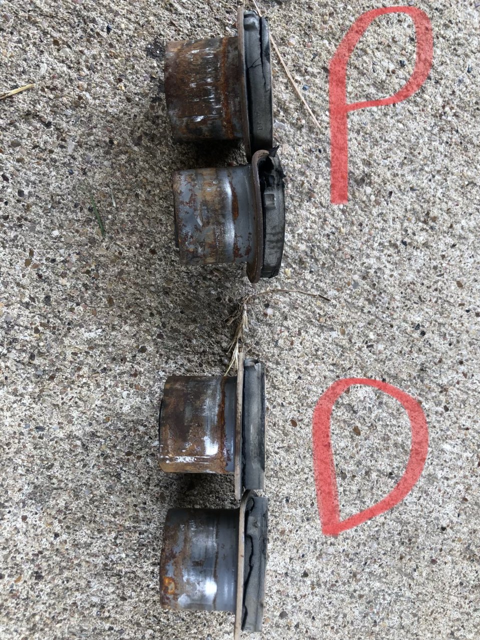

    The 3rd pic is the little bracket I removed to get the upper driver side bushing out. Also make a real good mark of how the steering linkage was so you get it back on right, and pay attention to not turn the wheel or you could destroy your clock spring... :anonymous:

    Had some popping coming from the front end so jacked up the front and shook the tire side to side and whole rack was moving with it
