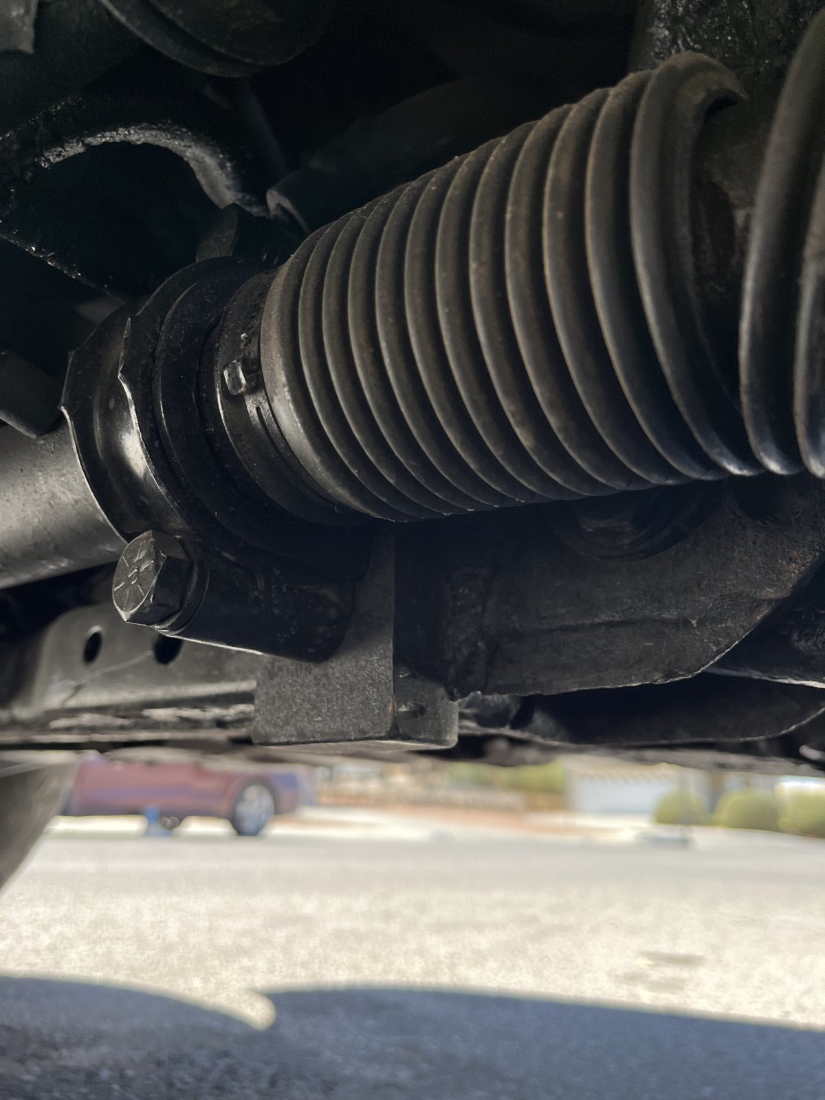

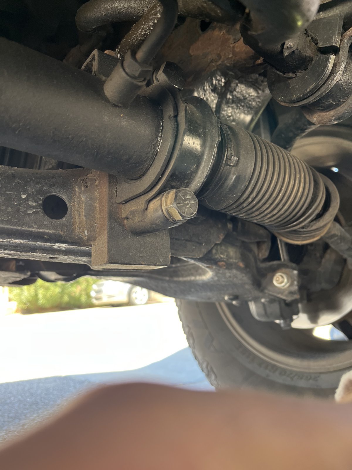

    I ended up buying a new horse shoe clamp, bushing, and bolts. I found a piece of metal about 3/4 inch thick for the bracket and cut a rectangle out of it. After I got it machined threaded correctly for the clamp and bolts to fit, I welded it to the frame. Once I grinded some of the rust off I realized it was strong enough to hold, and it has been holding strong ever since! I’ll take a picture tomorrow!

  16. Apr 24, 2024 at 10:58 AM
    YOUNGBUCK34
    YOUNGBUCK34 [OP] New Member
    May 19, 2020
    #46814
    24
    Rico
    2005 Double Cab 4x4 SR5 V8
    Little late on the photos but here they are! Ignore my disgusting underbelly as I have some leaky lines and a rusty frame. Only thing I would really do differently is cut back the little nub on the bottom but I have been off-roading plenty and have never scrapped up on it. Holds like a champ, good luck!

  17. Apr 24, 2024 at 11:07 AM
    kentuckyMarksman
    kentuckyMarksman New Member
    Jul 24, 2023
    #100837
    524
    2006 Tundra SR5 Double Cab - 4.7L V8 4x4
    Nice job on the repair. Looks solid to me.

  20. Apr 24, 2024 at 12:18 PM
    starlord128
    starlord128 New Member
    Mar 21, 2024
    #114045
    7
    03 Tundra AC SR5 4X4
    Bilstein 5100 front and back, ICON wheels
    Looks like a job well done! Definitely looks better than the splatter job I got done hahaha it holds though so can't complain for a first time welder
