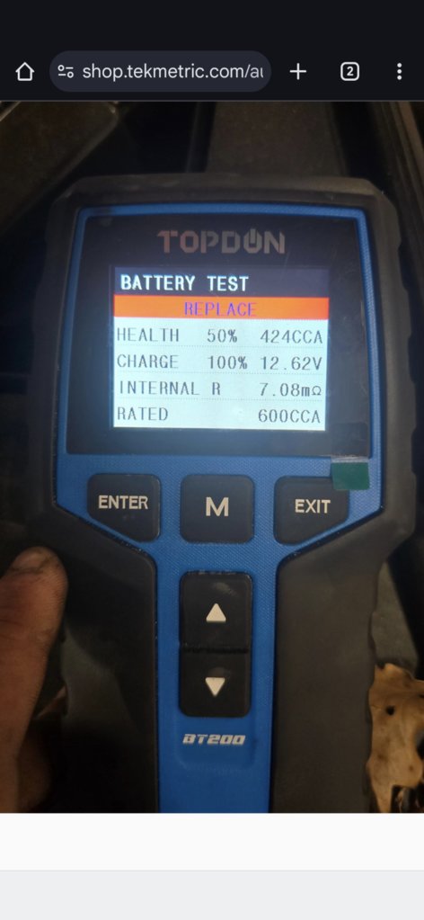

    Well I'll be damned. I ran the full battery diagnostic, and even though the battery was purchased in April, it's only putting 54% CAs. Looks like I'm taking the battery back. In case anyone is curious, it's a Duralast Gold 27 series from Autozone. Now to see if they honor the warranty.

    At least you lucked out with the easiest fix.
