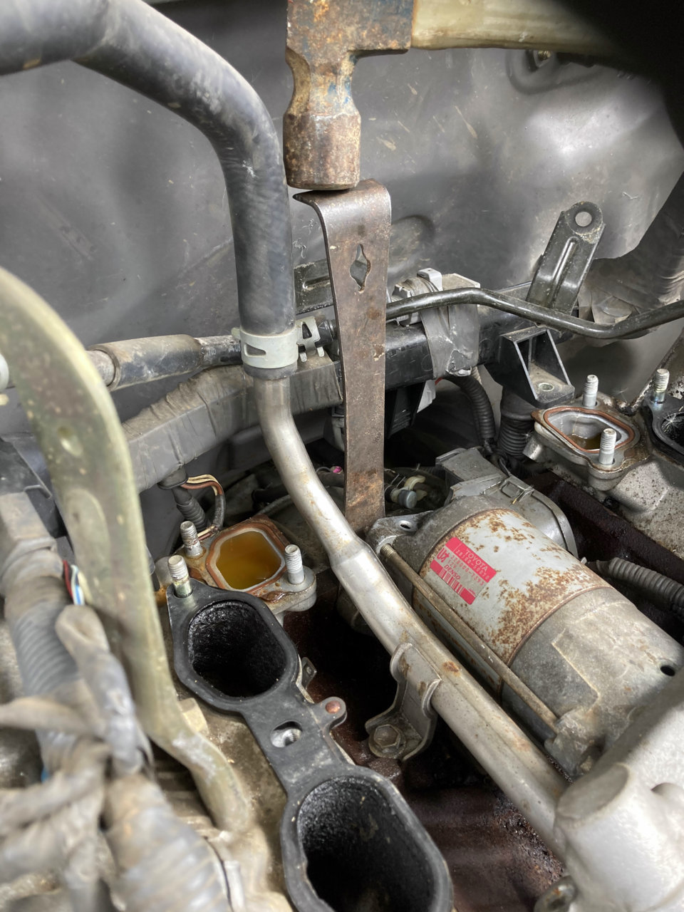

    Removed the 3 bolts on starter and unable to pull starter out - will not budge.
    Any tricks to loosen it up - already spray it with Blaster penetrating oil a couple of times?

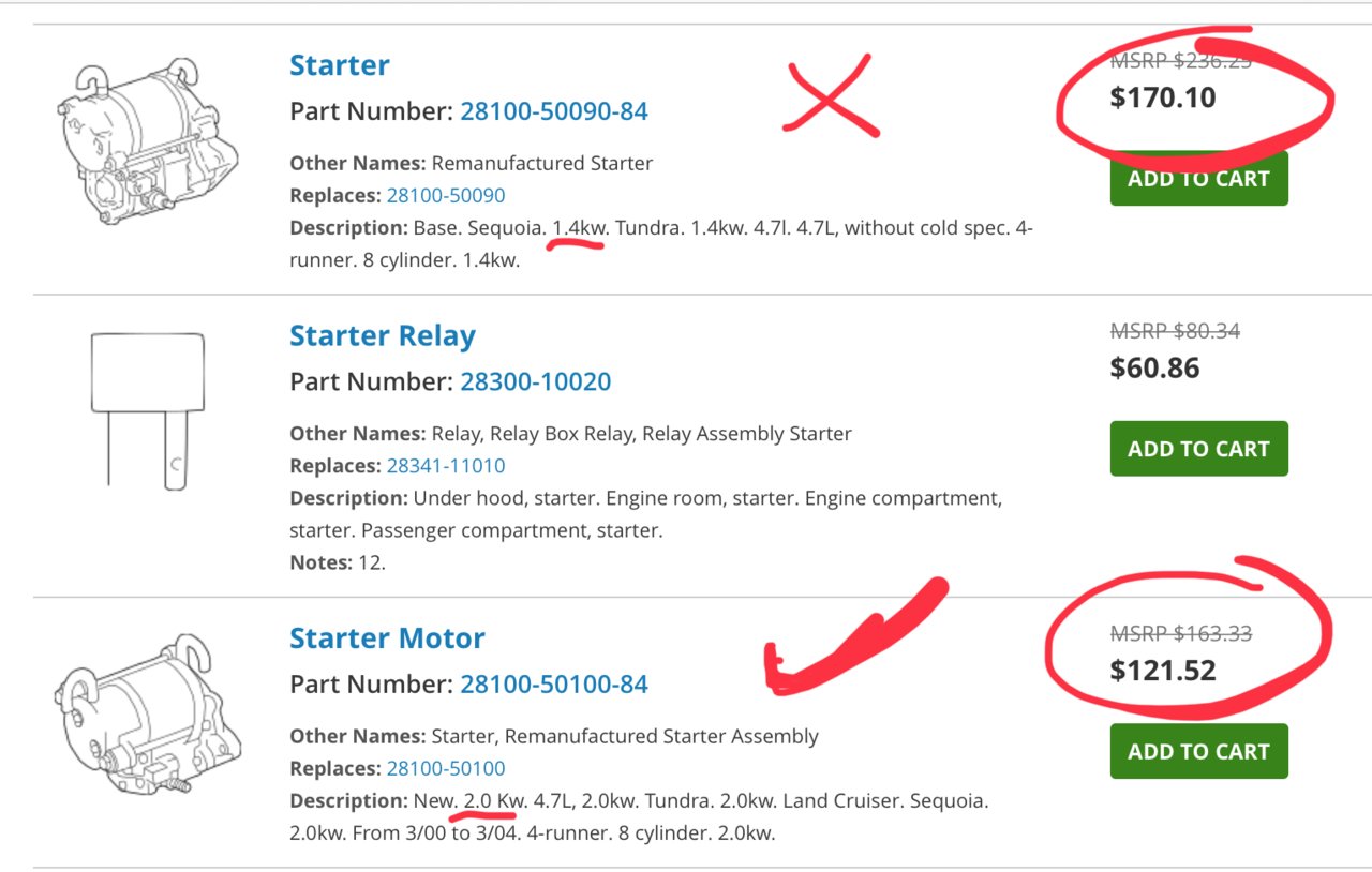

    Hoping you get the old starter removed. Suggest upgrading to the HD Denso Starter which actually costs less than the light duty.

    Thank you, sprayed it with more Blaster penetrating oil. Have a friend who is a mechanic said electrolysis between the cast steel and aluminum head of the starter - probably welded them together. Used a thin pry-bar and hammer open up a pinch - still will not move. Already had purchase the 2.0kw starter for $99.89 from Napa with lifetime warranty.

    Yes, had the ports cover with two towels took them off for the photos. Only can get to one of the ears, the other one has a plastic cover over it - will see if I can get it off tomorrow.
