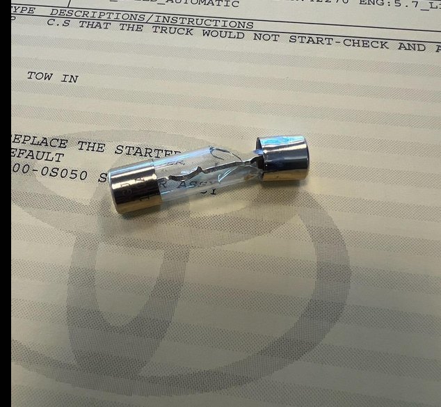

    Here's a good laugh:
    Just got off the phone with the service advisor (I am at work and getting off by 4PM, need to drop wife's car for her to take the kids to other activities, so I haven't seen the guy in person)
    He said master tech said I had an aftermarket AMP installed and the fuse was drawing 100W, thus, killing the fuse and starter as well.
    But, a. I don't have aftermarket amp, I wish, but nope. and b. what kind of fuse would allow up to 100W?
    The only variable I know is the GM diode that I installed for the AGM battery. They are insisting that I take it out and replace before releasing the truck to me.
    None of the above make any sense, except somehow/someway I blew the GM diode without knowing how and it in turn killed the starter..... fun times.

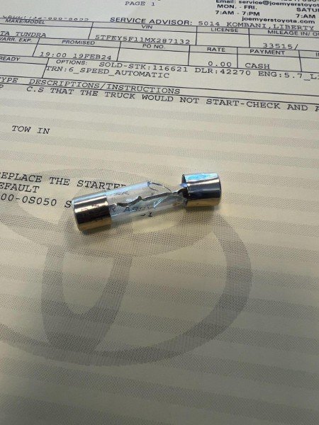

    2nd update, it was a 100 "amp" fuse that snapped..... or by the picture, the casing snapped....
    what on earth is this fuse doing?

    so that fuse was the fix?

    Where is that fuse at? That's like a 1950 fuse. More details please.

    ^ same. I highly doubt that fuse was in a stock truck.

    Where is that fuse located??

    It was between the battery and no idea where. Two 100 amps fuse..... Not even something you can buy at auto parts store....

    Look, I ain't calling BS but they didn't tell you where it was located at? That doesn't sound right. Also, just because it's a fuse from the 50's doesn't mean it's not available. You can pick those up pretty much anywhere or order them.

    This story makes less sense with each post. Not blaming you in anyway OP - just bizarre. They offered no insight on what caused it to break?

    So looking behind the fuse at the paperwork the dealer is going to charge Toyota for replacing the starter? But they only replaced a fuse that doesn't look like a fuse on the Tundra? What's this Dealers Name? Capitalism at its best I guess.

    Yeah, my OCD got the better of me and I ran outside to my truck. There is NO 100amp fuse. The biggest was a 50amp and it wasn't a 1950s fuse. OP must have had 1 to many today when writing this thread.

    You ask "What on earth is this fuse doing?". It's posing as an imposter. That's what it's doing.
    A glass fuse rated for 100 amps? No way. A glass fuse in a Tundra? Same thing. Unless you happen to add additional electrical equipment to your truck in your sleep.
    These glass cartridge fuses only go as high as 30 amps. Speaking of high, that's how I would describe the tech that's spewing this load of BS.

    Replaced the starter. Threw in the glass fuse for kicks as a test for the service advisor.
