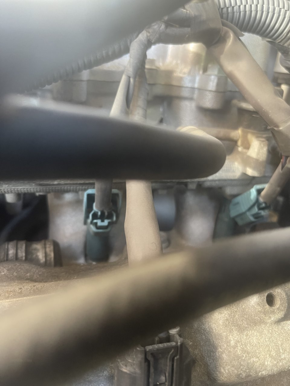

    Bummer, but it looks like you should be able to slide an extension between the rear intake runners on the driver side to smack the starter.

    Just wanted to give an update/followup post, as it drives me nuts when people leave threads like this without end resolves/results.
    @Mr.bee you were correct about being able to put eyes on the starter. Daylight is helpful. However tapping the starter housing did nothing for me.

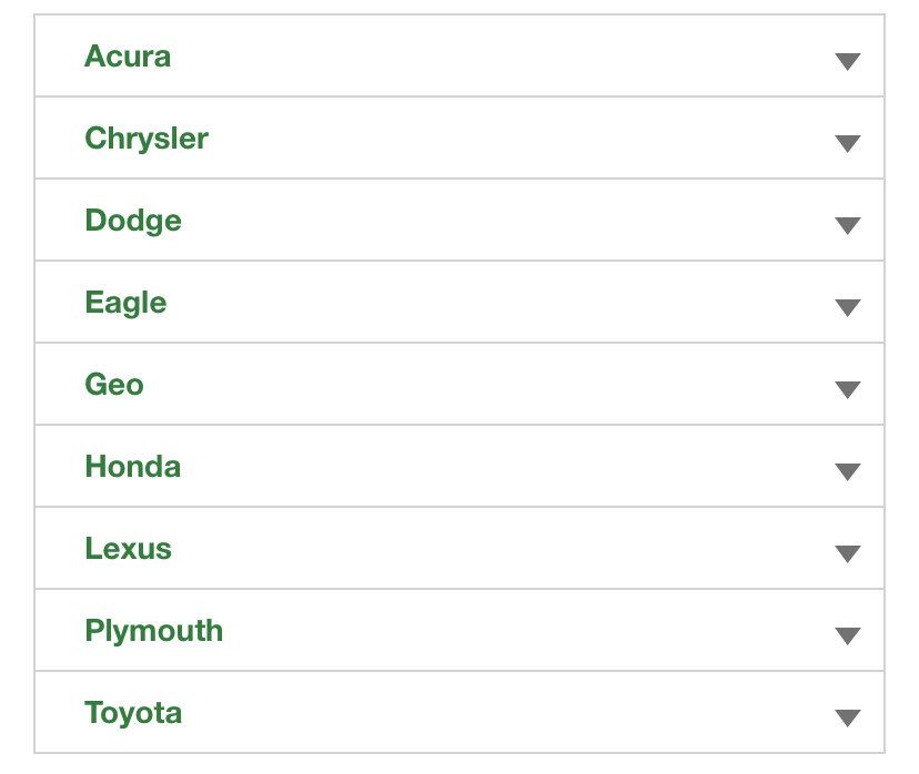

    Then bought a repair kit with the contacts, which are surprisingly universal for many makes and models. Upon opening the starter, it didn't appear to be worn to the point of failure. When something fails, I want to find broken parts, so there's no doubt. The contacts were definitely worn, but not gone.
