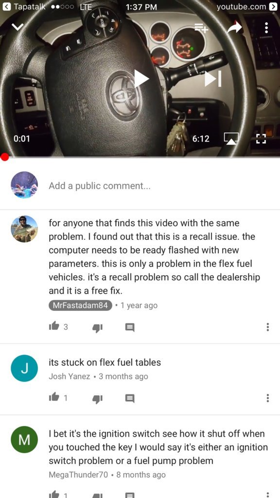

    Read the first comment on the video you linked.

    Bwa ha ha ha derp wonder if thats the same fix for the 2017 vs the 2012 guess ill find out =) thanks for being the smart one... Sometimes I just gotta read.... lol

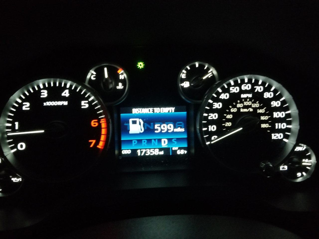

    Definitely will do man. I think they definitely did something. I have never been able to fill my tank as much as i was able to.. and also the average fuel economy setting would never change it stayed stuck all The Time and now it' actually giving me different numbers so we will see how it goes. That really sucks that yours is so new with only 6800 miles on it and they are charging you for maintenance I would tell Toyota to shove it!

    That is normal for when they disconnect the negative on the battery. You lose all your fuel data and it resets to the factory settings displaying over 600+ per tank. I have had mine disconnected several times from installing various items and it always does the same thing. It will take a few months to get back to it's normal state where it doesn't change much.

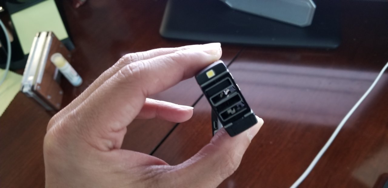

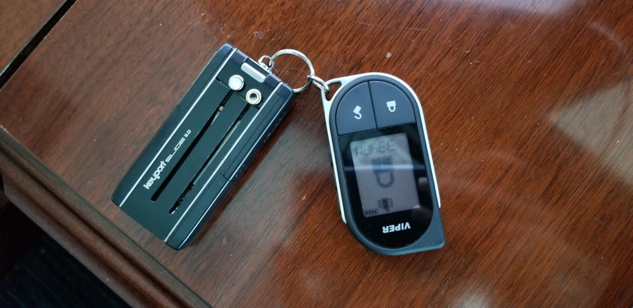

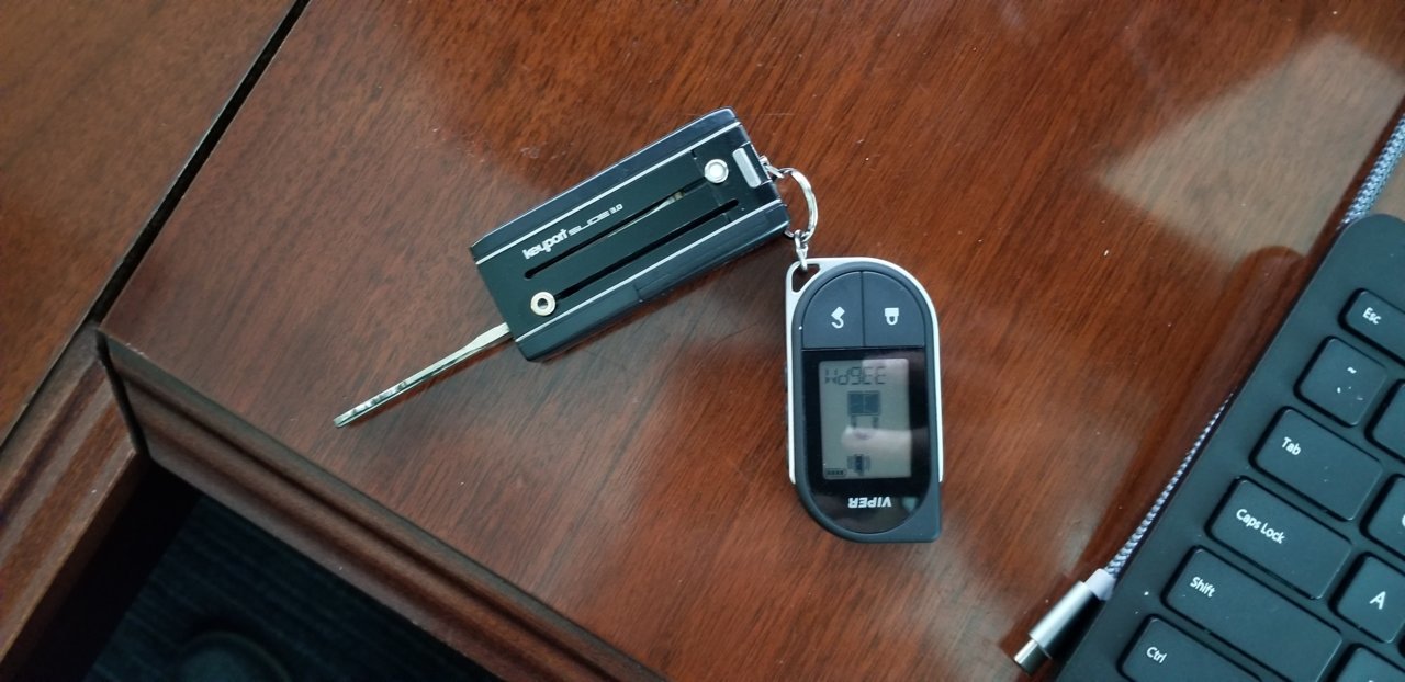

    I found my issue to be different from some of you guys... I have a custom key for my tundra, I sent one of my original keys to have Cut and Chip removed... Turns out the Chip was not lining up properly and causing the Anti theft cause my start up problems... I had to adjust the location of the chip on my key and now all is working! yay!
