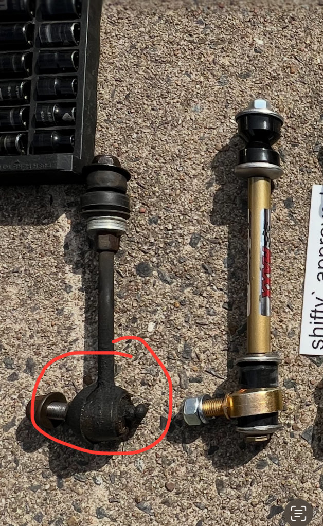

    This lower greasable ball joint portion can also be corroded, worn, and have a deteriorated boot. Likely will coincide with the upper bushing failure. Hence why most will replace the whole unit at once. If yours looks tip top aside from the upper bushings, just replace the upper bushings.

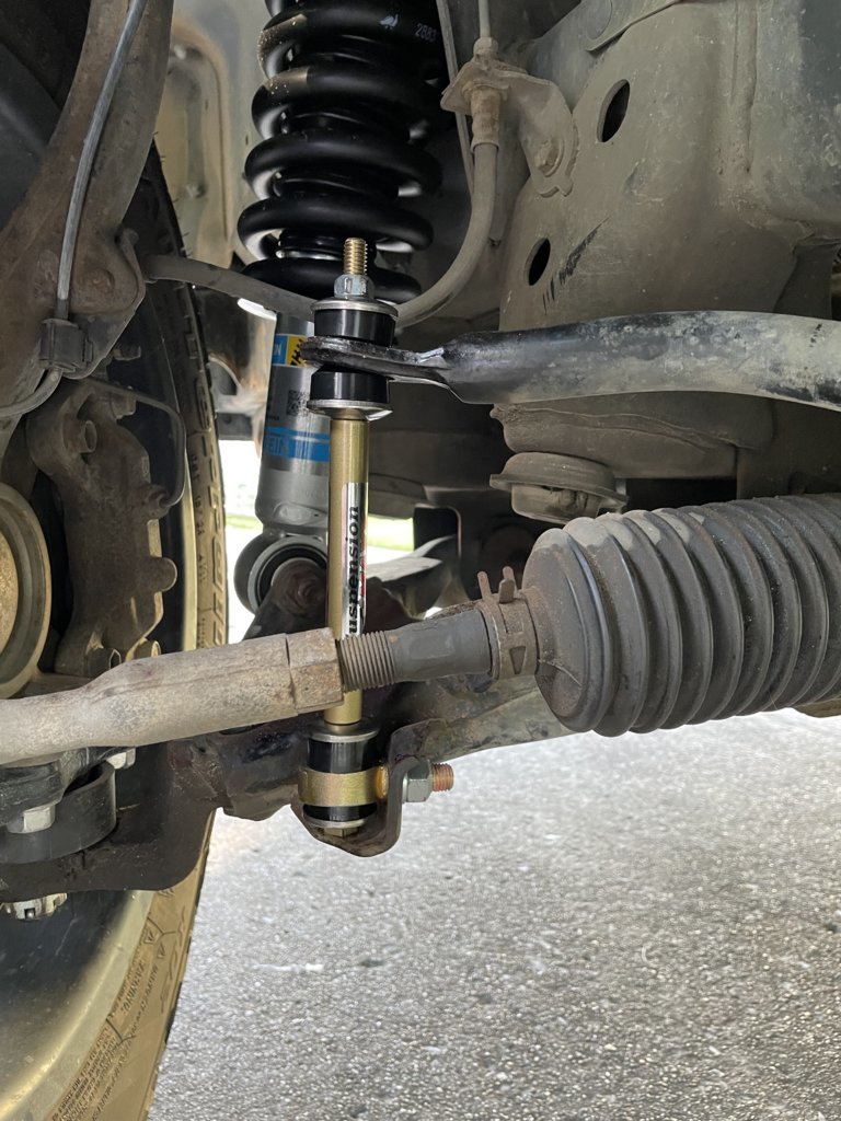

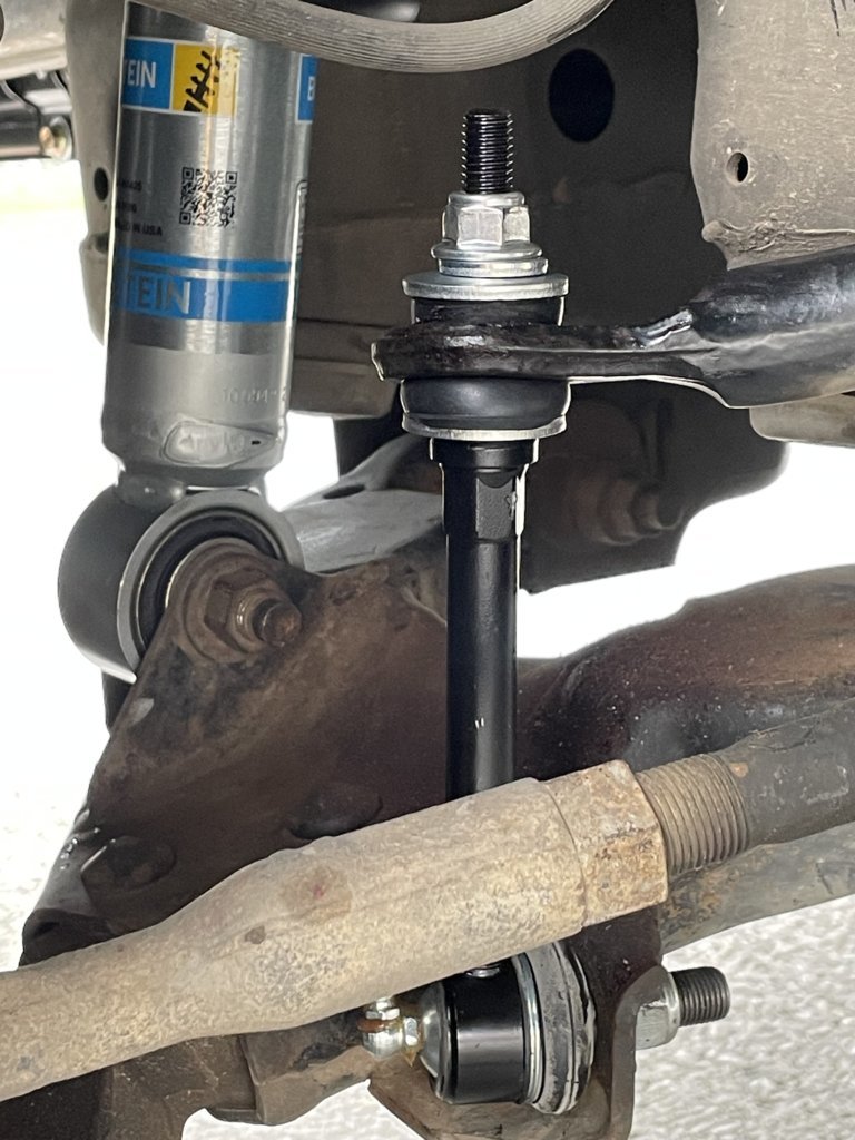

    I kept my old ones just in case. If you switch to Suspension Maxx note that bottom nut is a pain to tighten. The instructions came with the torque specs which were not very tight at all.. Here is before and after:IMG_2170.jpg IMG_2182.jpg
