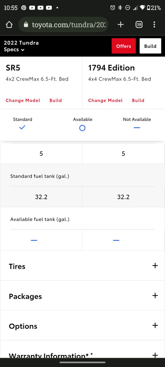

    DC 8’ bed and CM 6’ bed get 32 gal tank
    This is for DC6’ and CM5’
    This for DC8’ and CM6’

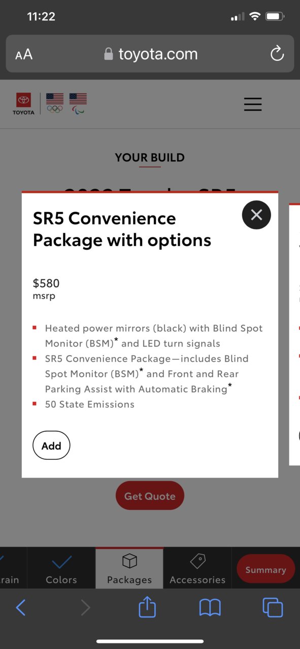

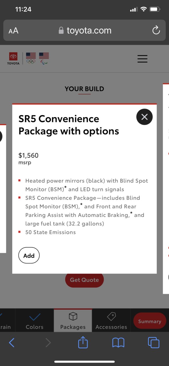

    that’s odd I only get the 580$ Convenience Package on my builder. None of the options listed even mention the larger tank.

    I think because they came with 32 gal tank, the upper pic show 32 gal tank but those are with shorter frame. same option the bigger tank is almost 1k

    As others have said, CM with 6.5 ft bed has it as standard

    How do you know it's the smaller tank? It's not a '23 thing, the CM/6.5 bed has had the 32 gallon tank since the debut.

    Crewmax with 6.5 bed has the 32gal standard.

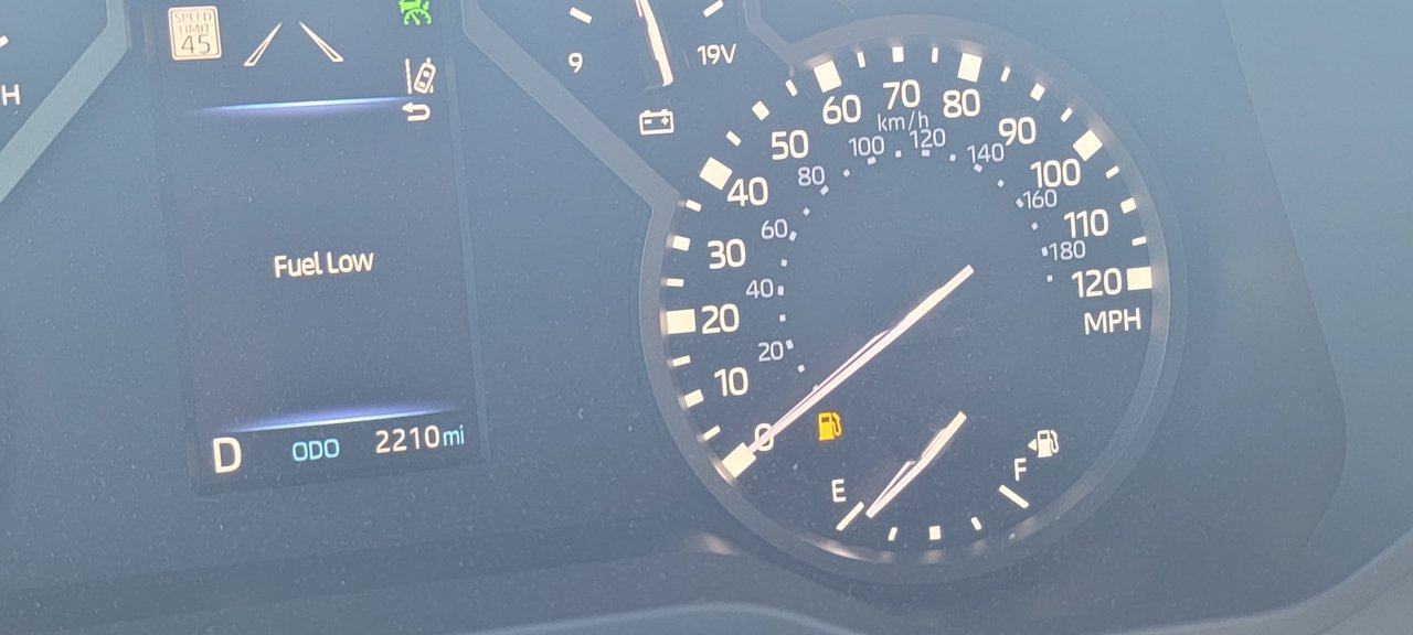

    I'm starting to think the small tank is actually more like 24-25 gallons. Twice now I have put in over 23 gallons with the range showing about 50 miles left and no fuel light on. Does this truck even have a low fuel light? Have never seen it. The first time I just figured the gas station was ripping me off, but it happened again today when I was at around 500 miles on a highway trip. I only fill to the first click too, so I don't think I'm overfilling the neck.

    I don't remember seeing a light but once you driver long enough with 1 mile to empty it'll switch to "low fuel" in the cluster screen.

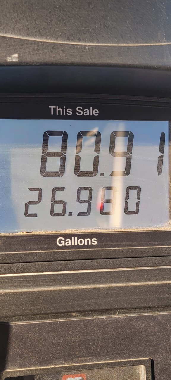

    Just filled my baby up. She took 23.5 gallons and the dash told me 88 miles until empty. I'm supposed to have a 31 gallon tank. I'm too chicken to let that needle drop any lower, but surely there is more than that left in her.

    Low fuel light came on just after hitting 24 miles left on the tank.
    Drive a few more miles then filled up.
    She took nearly 27 gallons. Cluster read 13 miles remaining just before it auto reset.
    I think I've been cheated out of a larger tank.
    Has anyone seen the truck take all 31 gallons???

    This is normal. Would you rather it alert you when it's near sucking fumes? Worst case, you don't pay attention to it. Got on a highway that's desolate. Then the light came on and you had an actual range of 10-15 miles. That may not make it to the next stop. BUT having 4-5 gallons in reserve, you panic when the light comes on but you start looking for the next stop hoping it's within the next 75 miles. You can drive for a while after the light comes on. In my 19, it stayed on 0 or 1 miles till empty for a couple miles and then just said low fuel. If you wanted to see how far you can go, get a 5gal jug of gas and record how many miles you go till it dies.
