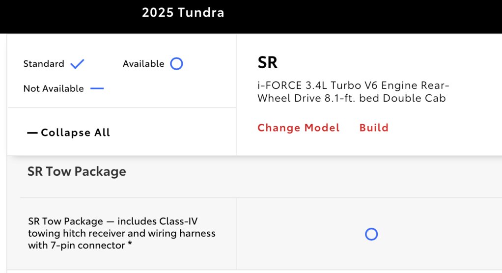

    Anyone have more info on this? Took my Sr to the dealer and they said Toyota does not make a hitch receiver you have to buy an aftermarket one. Really??? Anyone done this.

    (For 2025 at least) It's part of the SR Tow Package. If yours did not come with one, you cannot just add this later at the dealer, unfortunately. The only option would be to order an aftermarket unit (plus 4-Way Flat Trailer Connector, as needed) from the 3rd party provider.
