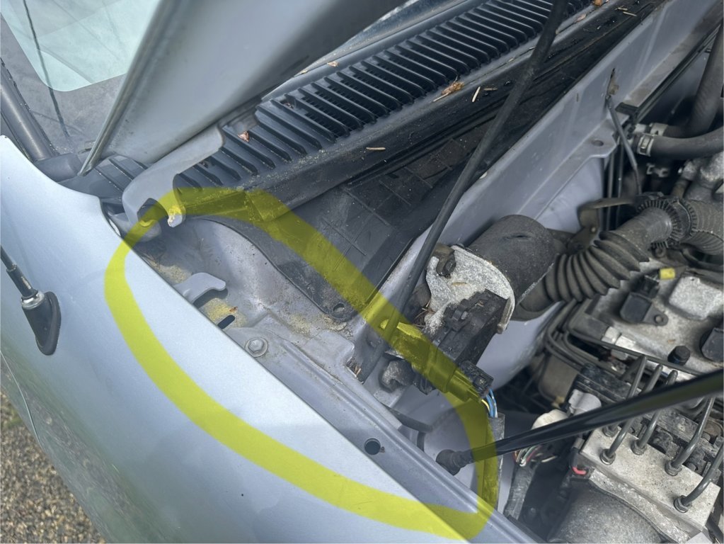

    Dear new friends,
    First post and unfortunately I have to cut right to the chase. A life may be at stake!
    There is a squirrel in my truck, and I think he’s stuck in there. I think he’s a baby and his momma abandoned him because he got stuck. For the sake of urgency, let’s assume that I’m correct that the squirrel is stuck and not just hiding. Either way he needs to come out.

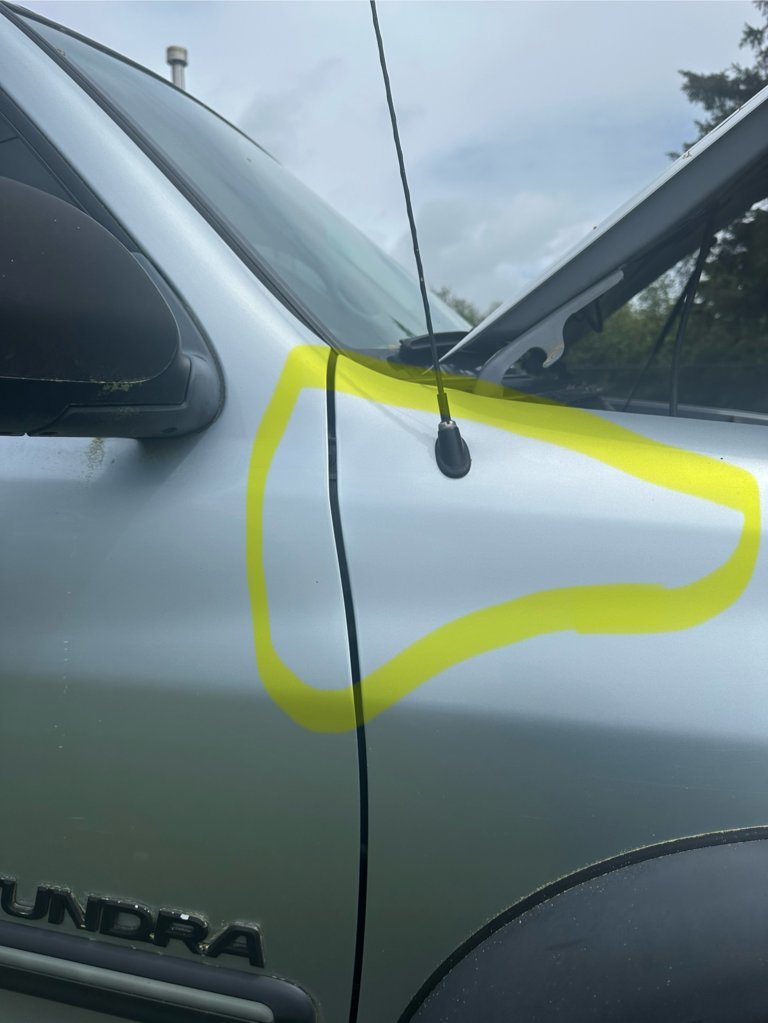

    Can you guys help me figure out how I can access the area where he’s stuck? Please see the highlighted portion of the photos. I can hear him squeaking right behind the metal. When I stick my head into the cab, I hear him kind of behind the glove box, or on the inside of the front of the door frame (above the hinge, about level with the glove box/antenna).
    Sorry in advance, but I have almost no mechanical knowledge. But I have some basic tools and know how to tinker, so maybe you guys can point me in the right direction.

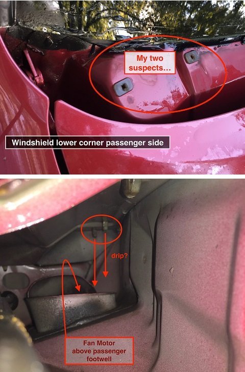

    If Rocky the squirrel is in that area of first picture, my first thought is he possibly made inside the truck thru the duct pipe, lack of better word, that’s under the windshield cowl area passenger side. If he’s there, you’ll have to remove blower motor and hopefully he’s on top of the squirrel cage, no pun intended.
    The duct opening I'm speaking of and showing, is right under "My two suspects". In fact, if you do find you have to deal with area and take the cowl off, the "My two suspects" are places one needs to address for water leakage to the inside.

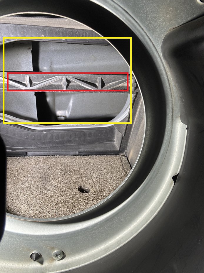

    You can drop the fan motor (3 x 10mm bolts) and probably reach up in. These pics I just took while cleaning out my fan motor under the glove box. The grey background in the yellow box is the cowl. Don't break the red flapper/bar in red.

    Is he behind the cowl cover? Wipers, few screws and some push pin fasteners. If you remove expect some to break but also good time to waterproof cowl clips.

    BubbaW, incidentally I’m also getting the occasional drips onto the passenger floor mat, probably through the route you’re describing there. An infamous problem I guess? Maybe I can gather some intel for the dripping while I’m on the squirrel mission.

    Infamous leaks are covered in great detail here, including the passenger side cowl leak: https://www.tundras.com/threads/definitive-2000-2006-cab-area-rain-water-leak-thread.70464/
