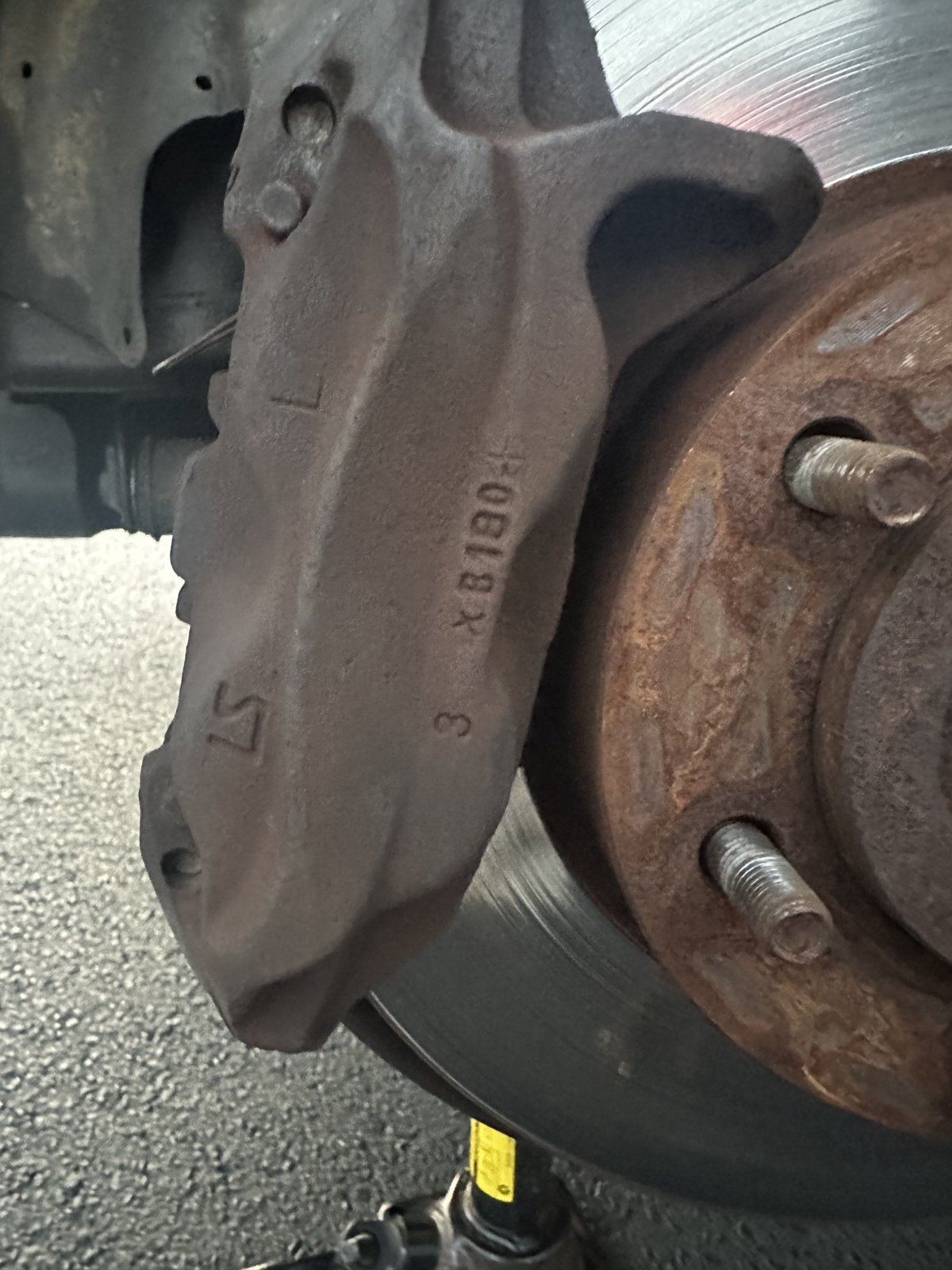

    Anyone know what’s going on here? When turning the steering wheel, I’m getting an embarrassingly loud squeal. It sounds like it’s mostly coming from the passenger wheel assembly area. 2000 SR5 V8 4.7L RWD 158k miles. LBJs were replaced at 137k, so I can’t imagine it’s those. Replaced the steering rack bushings today cause they were worn all to hell and I thought it could be that, but the squeal persists. I sprayed WD40 on the tie rods ends while a friend steered the wheel and the sound continued, so I’m not sure it’s those.
    Would love some guidance from the experts to get to the bottom of this. Video attached.

    Sounds to me like your lower balljoints are about to fail, I take it you didn't use OEM? Only use OEM replacements. Use fresh bolts each time, and replace every 100-125k miles, LBJs are a wear item and don't last forever.
    Don't fuck around, here's 15+ pages of people who couldn't be arsed to listen to very well known advice on the topic regarding using anything EXCEPT Toyota parts. You see where it landed them...

    I assure you they didn't use OEM LBJ, because I see a zerk on them when you kick the wheel all the way left, and OEM don't have that. Aftermarket LBJ you're lucky to get 10-20k miles out of them before catastrophic failure.
    Yours are about two shakes away from failing, you're already on borrowed time. They'll be failing any day now. I personally wouldn't drive that truck if I were you.

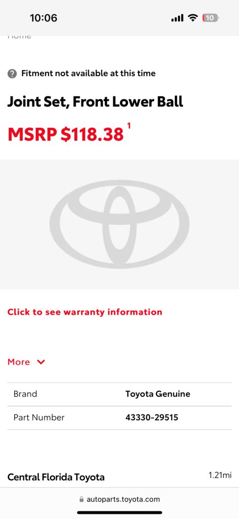

    I am trying to follow your guide for searching the Toyota parts site, after confirming my VIN it appears this is the right part. Excuse my lack of knowledge, but is there a way to know if this is both the left and right LBJ or just one singular one?

    Check this post out. Look at post #17 and read the rest for more info
    https://www.tundras.com/threads/lower-ball-joints-part-numbers.97100/

    Link to part numbers for bolts and joints for all years here LINK
