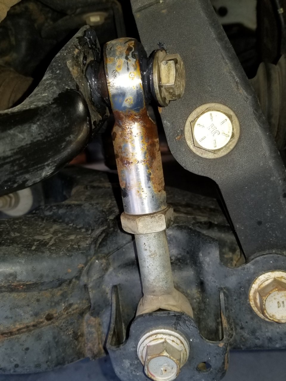

  18. May 23, 2019 at 5:16 PM
    Ibew640
    Ibew640 New Member
    May 18, 2019
    #30714
    13
    Anthony
    15 Limited 4x4
    4"BDS
    This is my long term solution to the problem as recommended by my local auto parts store
  19. May 23, 2019 at 5:28 PM
    Ibew640
    Ibew640 New Member
    May 18, 2019
    #30714
    13
    Anthony
    15 Limited 4x4
    4"BDS
    Don't bag on my rusty parts boys...

    Update:
    Its been a month. We've been camping in northern Arizona where the mud is clay like. With recent rains the mud pits were everywhere and unavoidable in many cases due to the dense forest. Of course the Tundra pulled through. Got her home and pressure washed her for over an hour and there's still mud under there.. Mudded out my driveway and neighbors gutters lol.. Long story short.. after all of that, the grease is working perfectly and still no squeaking from the sway bar links.

    Ive been told by a lift shop that specializes in BDS suspension that the connection is supposed to be metal to metal... fyi.. ive greased them once and have been camping and mudding a lot...

    Update:
    9 months later
    was in the snow
    the squeak is back
    grease reapplied
    problem solved

    Sorry to revive this but I have the bds 7 inch lift too and the squeak has been driving me crazy. It gets worse after mudding and stuff which I know has to be dirt in a metal to metal point and I’m wondering if it’s my sway bar links too. For you guys that greased it and it went away, you didn’t remove the sway bar to grease it did you? Just rub some all over pretty much?

    Just rubbed on metal to metal surface..
    Removed nothing..
    Pictured above..
