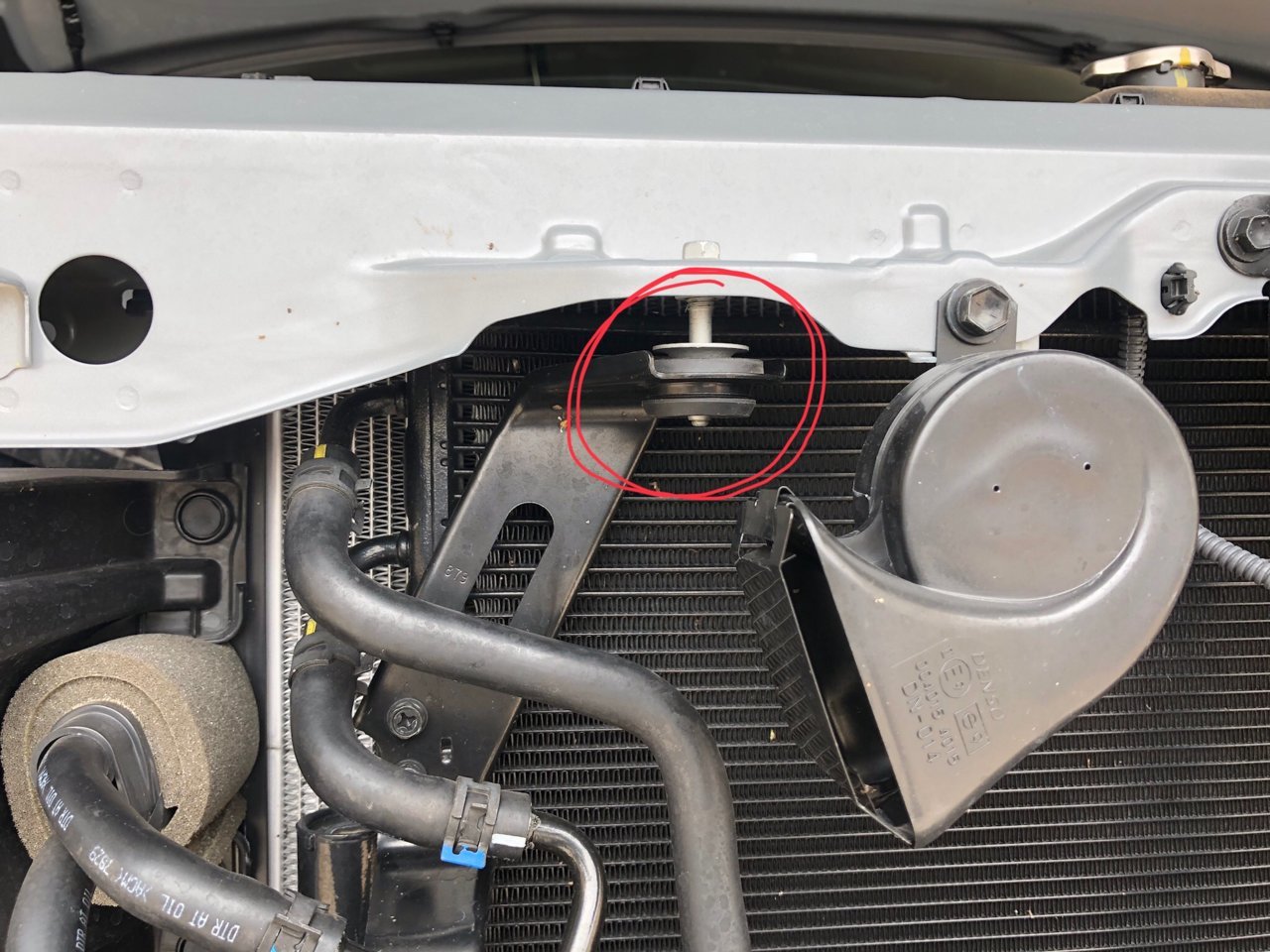

    The bushings that hold the trans cooler and condenser at the top can squeak. Adjusted mine to stop, but some lube would probably work.
