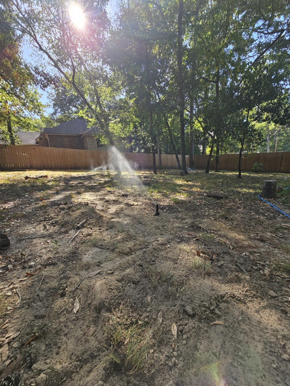

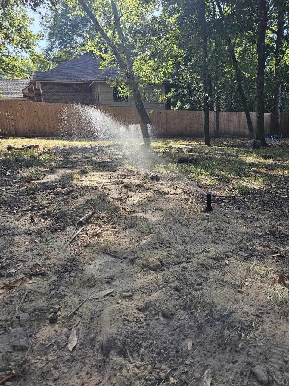

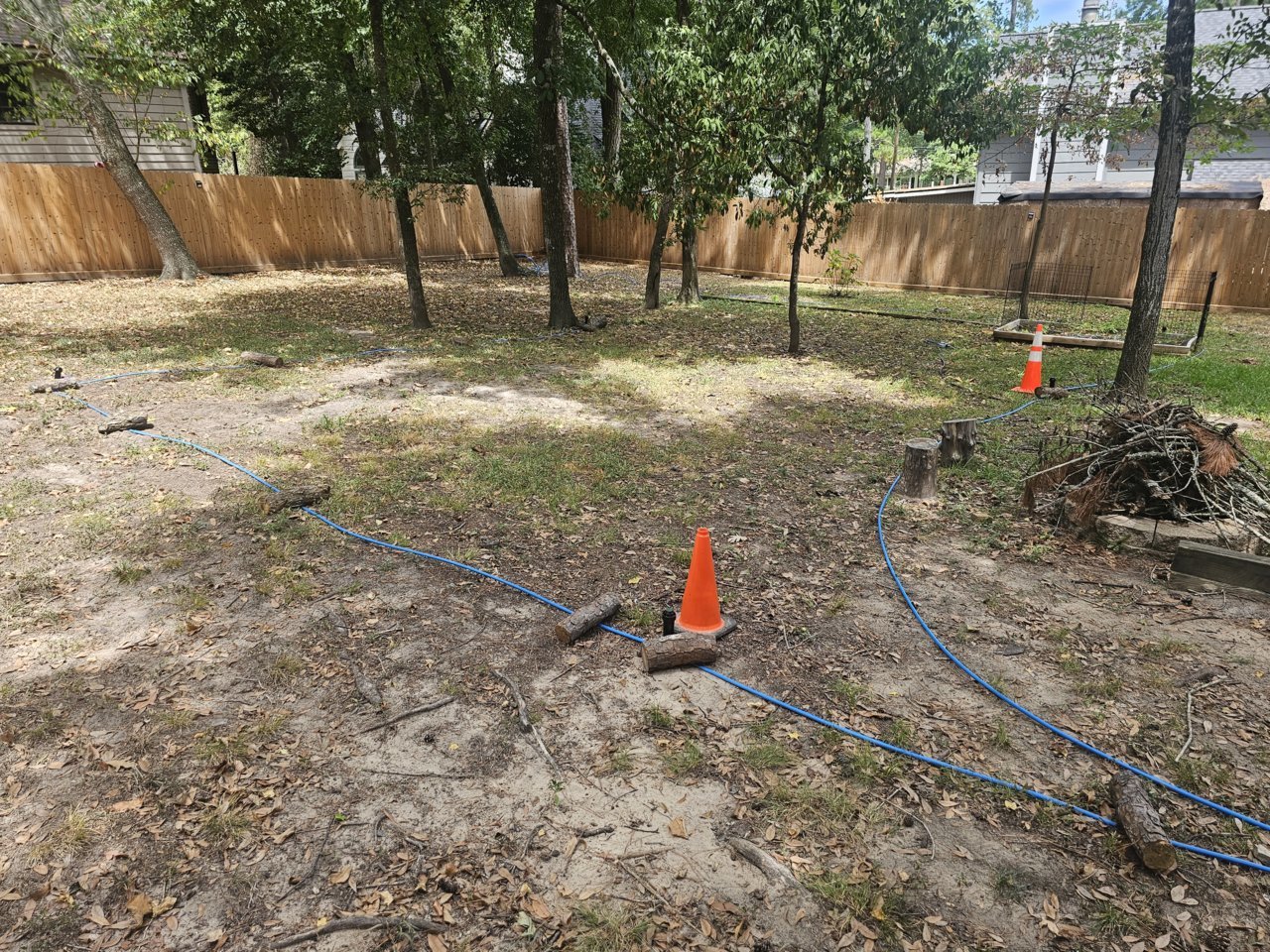

    Our grass is all but extinct and I'm tired of having to drag out the hose and sprinkler then move it around every morning and evening. Enter the Orbit dual zone sprinkler system. Problem is it's hot AF outside right now....
    Screenshot_20230806_095009_Lowe's.jpg 20230806_120612.jpg 20230806_143529.jpg 20230806_144619.jpg
    More to come....

    I hope the water pressure and volume at your source is REALLY good..
    You can rent a trenching tool at Diamond Tool Rental or similar for probably $100 for the day. Digging in the heat blows. Good luck!

    60 PSI and almost 9 gpm. I tested everything before digging.
    Also laid it out to ensure the spray patterns are good to go.
    The Ditch Witch sounds good about now lol

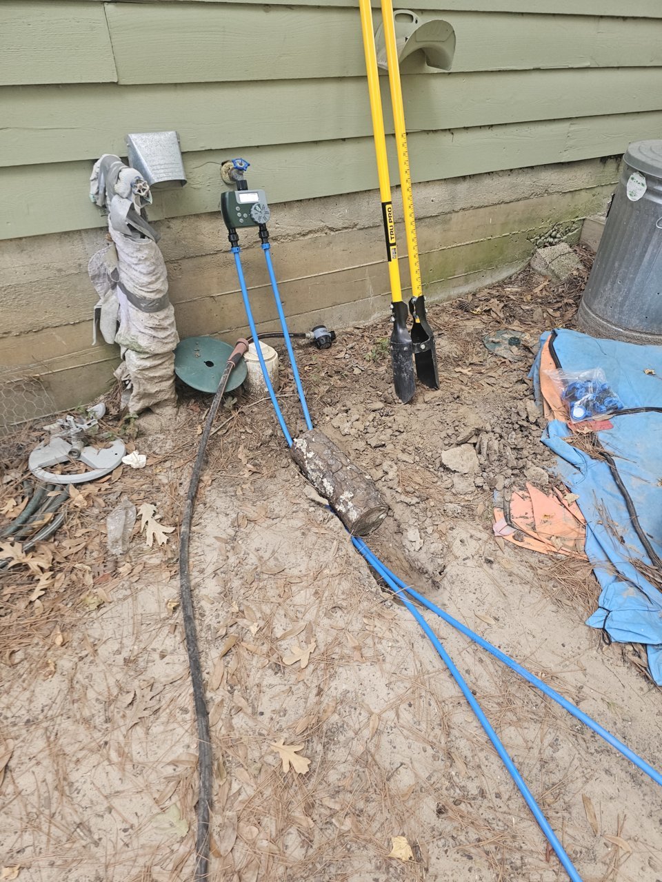

    Get a backflow prevention valve on that system. You can find all different flavors for varying prices. Well worth not having to worrying what's potentially coming back up in the system and is code in most areas.
    I've only designed and installed one system and I'll never do it myself again. So much work and it just wasn't worth it in the end. Good luck!

    Wouldn’t one of the simple hose bib checks be sufficient?

    Dont believe that is code, but certainly better than nothing, IMO. After reading up on it,, it was an easy $100 purchase for a dedicated unit, especially how I was tied into my house supply, had pets, and applied fertilizers.

    Would this suffice?

    That’s the one I was talking about

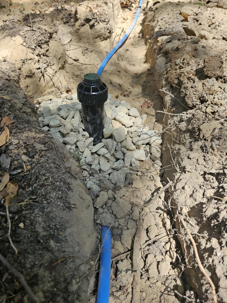

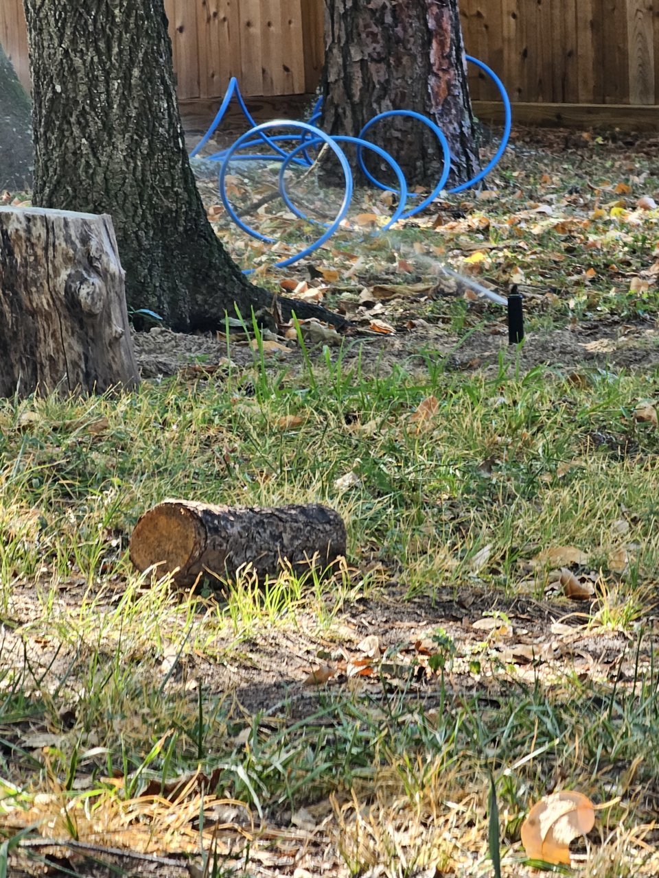

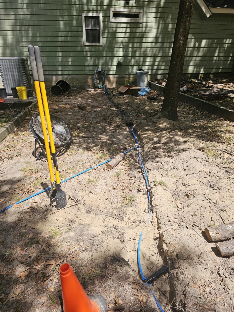

    Only completed one zone. I'm tuckered out. The other zone will have to wait. I'll still run it above ground though....

    Looking good. How many heads per zone?

    3 per zone. I calculated 22 ft spray pattern at 360°

    Swing checks are not a legal, at least in Cal, backflow device. You need a "dump" also refered to as a positive air gap or an anti-siphon to be legal.
