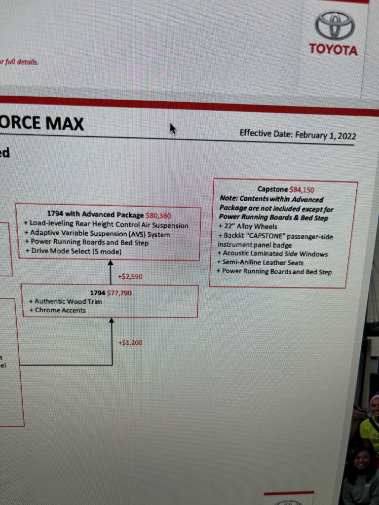

  11. Nov 26, 2024 at 4:08 PM
    Hella Krusty
    Hella Krusty New Member
    Dec 8, 2022
    #88103
    1,719
    That truck should have AVS on it. Switch it to Comfort Mode
  12. Nov 26, 2024 at 4:13 PM
    Breathing Borla
    Jan 21, 2020
    #41531
    6,591
    Northern Illinois
    have to wonder what they did to the rear air system then, riding on 22"s especially if not P rated.
    pics will be interesting

    Unfortunately no AVS

    Would the lift spacers mess with the vehicles ability to sense and or change to comfort setting ? @Hella Krusty . I can go from sport to eco, regular.
  15. Nov 26, 2024 at 4:59 PM
    Hella Krusty
    Dec 8, 2022
    #88103
    1,719
    AVS is the shocks so if the lift people tore out the stock shocks, you have lost AVS
  16. Nov 26, 2024 at 5:05 PM
    Mraz
    Mraz [OP] New Member
    Jul 30, 2024
    #120620
    28
    Not quite sure, that seems like a strange adjustment to make if they came with the truck originally just for a few inches of lift. From the videos I watched on line it appears there are switches in the dash below the nav screen that mine is missing.
  17. Nov 26, 2024 at 5:18 PM
    Breathing Borla
    Jan 21, 2020
    #41531
    6,591
    Northern Illinois
    I thought AVS was standard on the capstone , guess not?
  18. Nov 26, 2024 at 5:27 PM
    Mraz
    Jul 30, 2024
    #120620
    28
    9/10….good for me….go figure

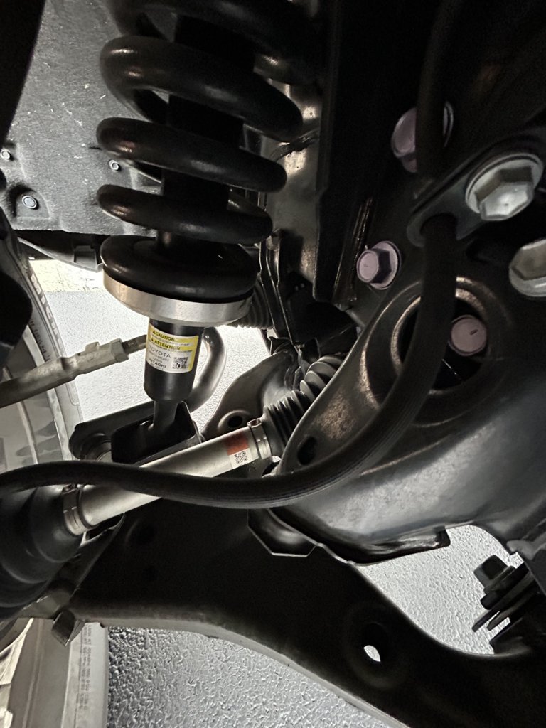

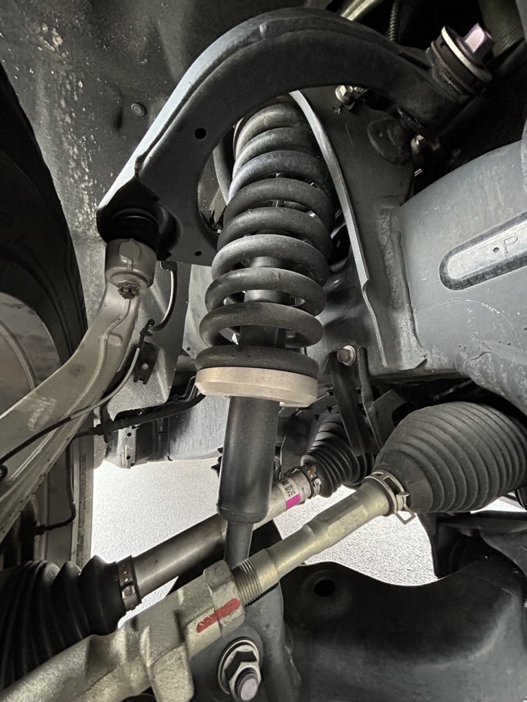

  19. Nov 28, 2024 at 7:51 AM
    Mraz
    Jul 30, 2024
    #120620
    28
  20. Nov 28, 2024 at 8:47 AM
    GoHuskers
    GoHuskers New Member
    Sep 1, 2016
    #4402
    405
    Nebraska
    '24 iForceMax, '17 RX350, '15 GX460
    That's the Westscott collar lift so it's likely you still have the oem shock and spring. I guess it's rough because your spring is already compressed.

    I thought AVS was standard on capstone , is it not?
    op photo of the rear and tires size and specs
    Are you getting too much “axle hop “ in the rear or too much bump in the front or what is specifically going on
    going back to stock and getting p rated tires no larger than 20” wheels would be best for soft on road ride , but let’s see what your working with

    I thought it was as well so I dug out my 22 order matrix. It isn't
