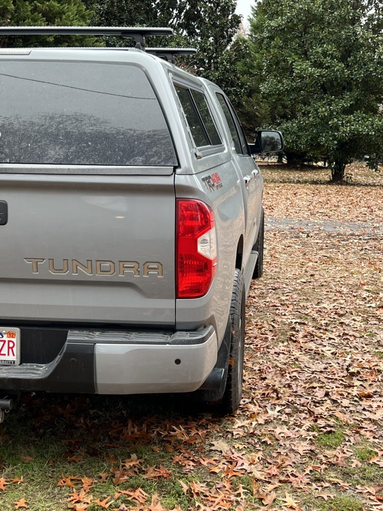

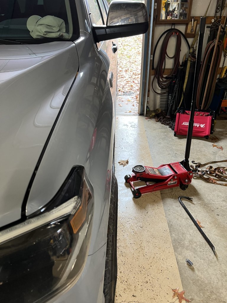

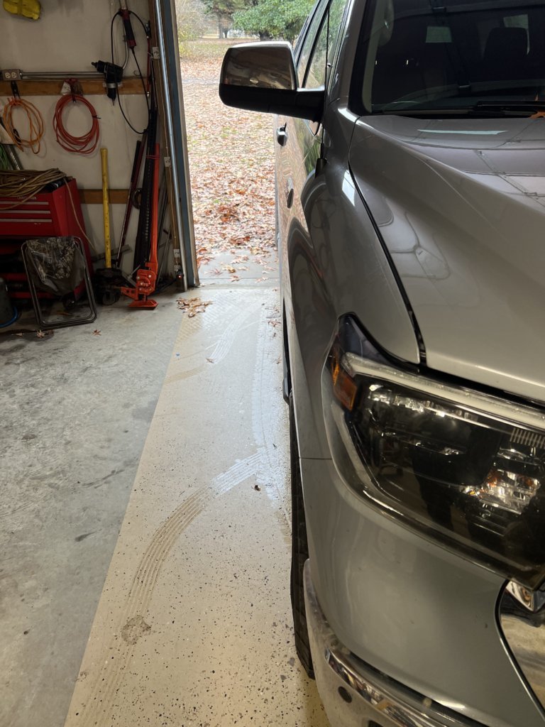

    Before
    After
    COTundra23, Black@Blue19 and bflooks like this.
  13. Mar 8, 2025 at 3:53 PM
    bflooks
    bflooks New Member
    May 9, 2020
    #46273
    1,930
    Metrowest MA
    @centex, I've also got 1" BORAs at all 4 corners. I still get a little of rubbing on the down pipe, but not nearly what it was before. That's with TRD OR 18s and 275/70 Falkens.

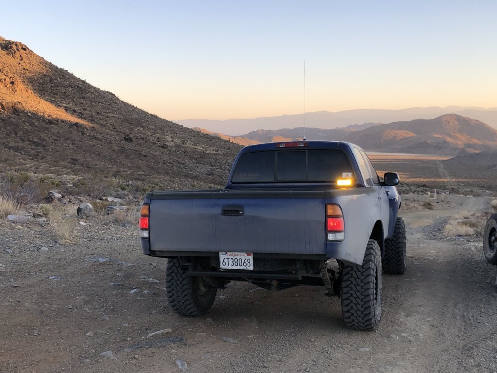

    I run 2” Bora on the rear of my first gen to clear the rear shocks that are outside of the frame. Nine years and thousands of desert miles without a single issue.

    17x8.5” with zero offset. Here’s the fitment with 35x12.50 and fiberglass bedsides, but I have spacers to clear my shocks, not to try to fill the fenders.IMG_6675.jpg

    8.5” w/ 0 offset is 4.75” BS. Add the 2” spacer and you’re at 2.75” BS. That’s a lot, usually it’s not recommended to go past 3.5” BS. But as long as you’re at the bare minimum for it to work, and you’re not shredding wheel bearings, let er rip!
