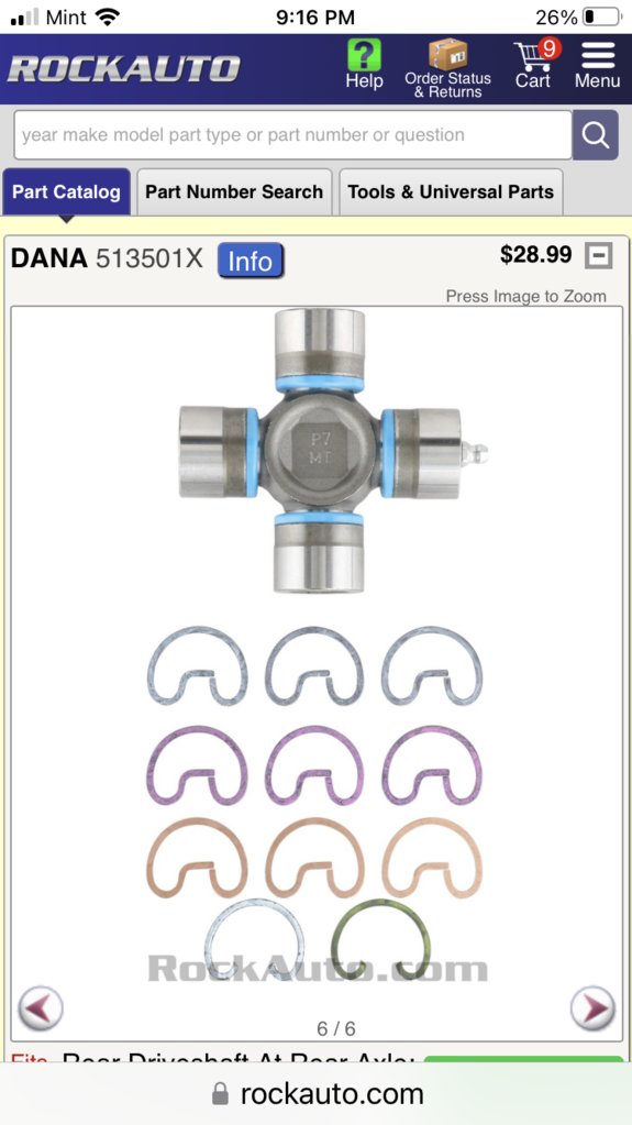

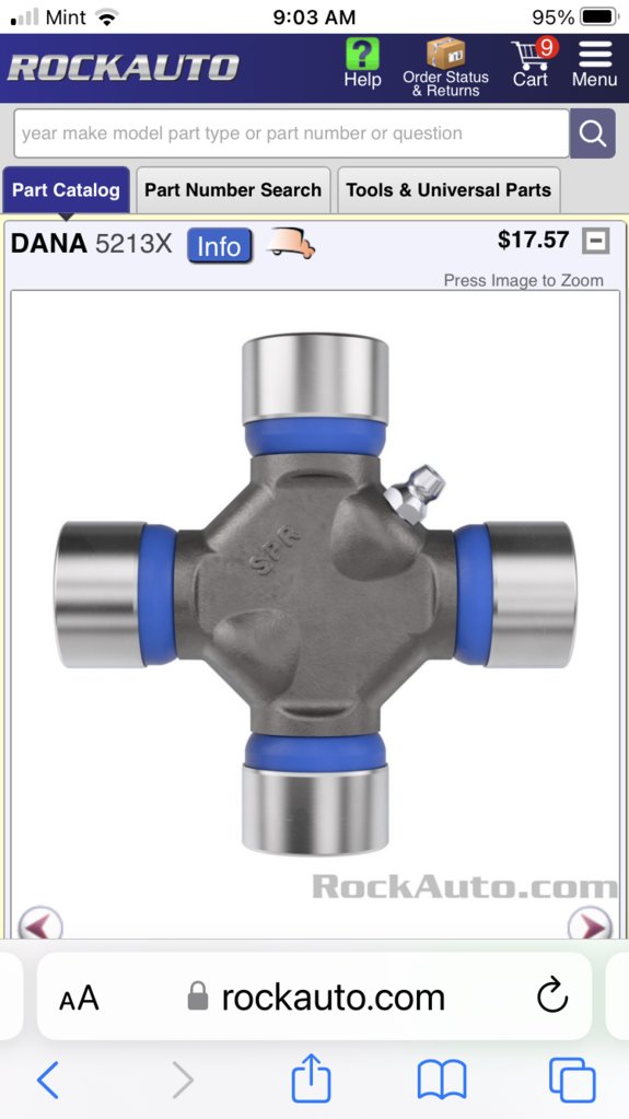

    Erozfish
    Erozfish New Member
    Mar 11, 2020
    #43826
    9
    2007 Tundra SR5, 4x4 5.7 V8
