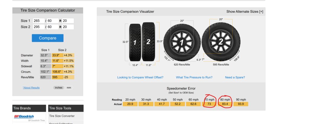

    Allegedly the Toyota Speedo is off by a few MPH as in 75 is actually 73 before you change tire size....but that tire size isn't that different from stock upload_2025-9-2_8-18-24.png
    ghostactual[OP] likes this.

    Yeah, I think after using the difference calculation I'm going to operate off the below assumption and this should keep me pretty close:
    • 0-34 (+1)
    • 35-55 (+2)
    • 55-80 (+3)
    • 81+ (+4) and slow the f down
  16. Sep 2, 2025 at 8:22 AM
    Matt2015Tundra
    Matt2015Tundra New Member
    Aug 9, 2022
    #81755
    2,049
    2023 1794 CrewMax
    Based on the tire circumferences posted above, your speedometer will always be 4.4% slower than your actual speed. So, your rough calculations are pretty close.
    The actual calculation is (speedometer reading) x 1.044 = actual speed.

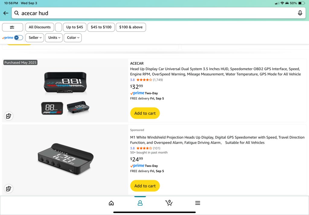

  18. Sep 3, 2025 at 9:00 PM
    G8Santini
    G8Santini New Member
    Jun 9, 2025
    #136222
    86
    25 Tundra SR5, 4x4, PremCnv, Perf. Pkg., Blackout, TRD 3”Lift, 20”TRD rims
    Heritage grille, fog lights, 35x12.5x20” Nitto, low profile toolbox, F/R tow hooks
    I have 35x12.5R20 tires so I got a HUD off of Amazon and used the Acecar version. Plugs into the OBDII port under the dash below steering wheel, & the wire hides very easily. It uses the Toyota ECU speed sensor and then you apply factors to correct for your tire size. Auto on/off, self dimming. Small tint/laminate you stick on lower windshield and image shows speed as a heads up display. It will also show tach, water temp, etc, but I just do the digital speed reading.IMG_0701.png
