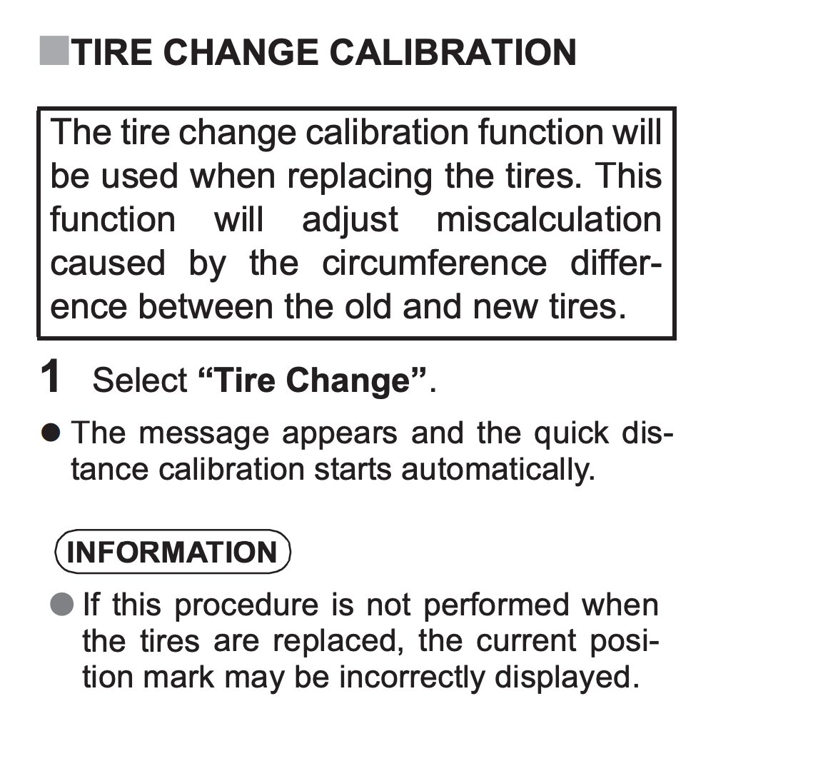

    On (maybe more) navigation radios there is a GPS option to recalibrate based on a changed tire size. I thought this also updated the digital speed display in the cluster for +2018 trucks. If not, how is it used?
