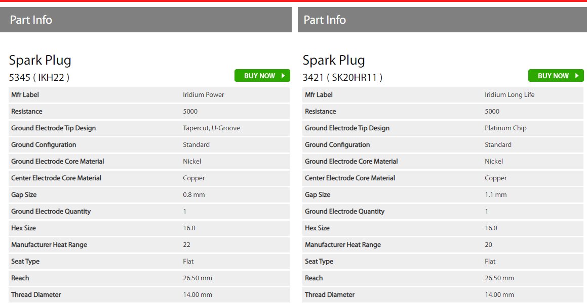

    So looking at the spec, there is a difference in gap size when comparing IKH22 vs SK20HR11 (per manual). Is this an issue?

    should be good...they're different plugs that essentially do that same thing...the gap is different because the electrodes are different...should be good to go.

    You want the smaller gap and colder plug of an lkh22 when going forced induction. Many guys are going even colder with ikh24 plugs.
    Electrode material does not affect gap size, copper, platinum, iridium, rhodium are all 1.1mm for NA engines
