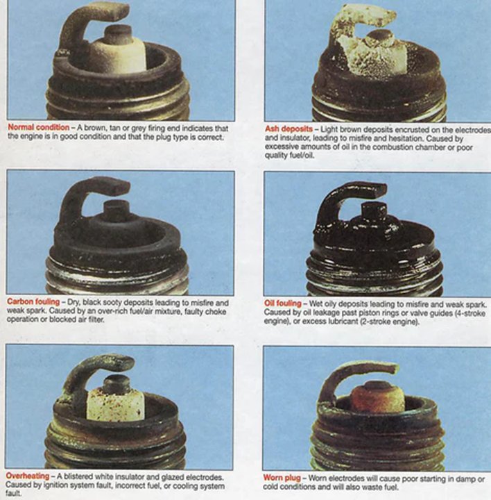

    This is not unusual for a combustion engine. Oil is what's lubricating the cylinders, you'll have some miniscule level of pass-by via residual on the cylinder wall being atomized.
    The bigger things to look for are whether the plugs themselves appear fouled from oil, running rich, or running lean. These are older style plugs but cover it pretty well. The tip on newer plugs is considerably finer pointed.
