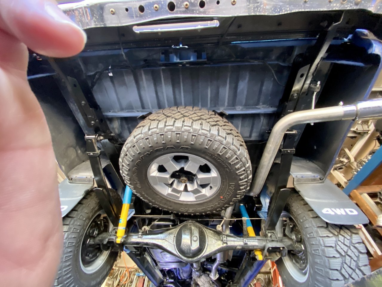

    You can get a matching 5th wheel and tire. Then you can do a 5 tire rotation and your spare would be true size to the rest of your tires and not a small donut. You can fit up to a 35" tire under the truck. I carry a 37 spare in the bed, before I had a 295/70 under the truck
    If your tires are larger than stock and you have a flat in the rear, you could be changing 2 tires so your drive axle tires are the same diameter.

    Bust out some more cash and do it rightF2CD7985-9F60-49EC-8237-F03A748CAD56_1_201_a.jpg
