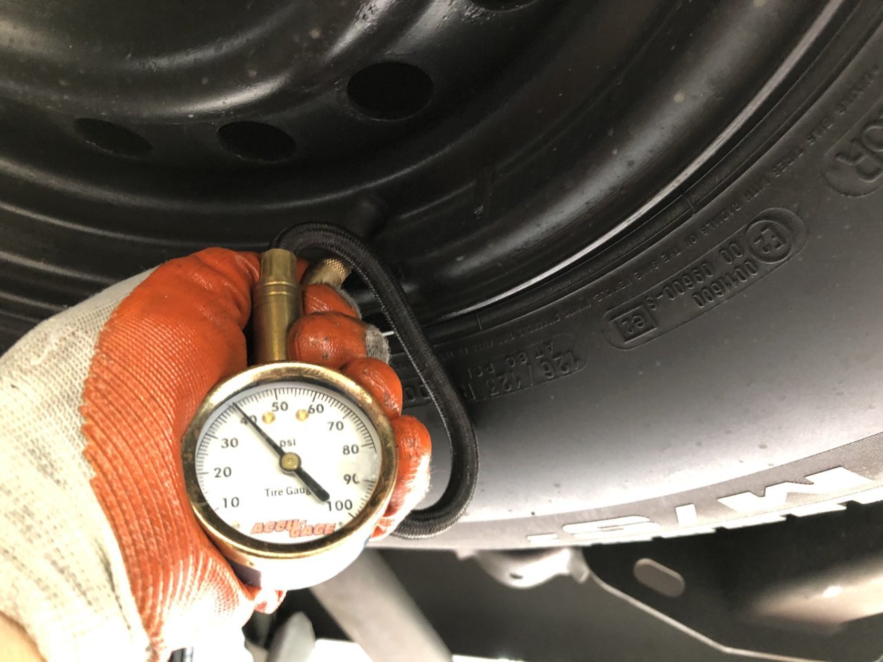

    Gents, I’m heading to Utah for a week with the family. I was wondering if the spare tire is somehow linked into the computer to tell you if it is low on air? Of course toyota mounted it with the valve stem facing the frame. I don’t want to drop it to check. Too much of a hassle. Owners manual didn’t say anything. Help and thanks

    Pro Tip: Flip your spare around so you can air it up without dropping the tire.

    They make an air chuck that has two ends at an angle to the nozzle shaft. The reverse facing one will usually work on the spare with the valve facing up.
