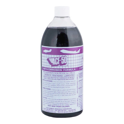

    Consider spraying it down (lubing) it with this wonderful gem from the aviation industry/recreation: ACF-50 anti-corrosion fluid. And a wonderful lubricant.

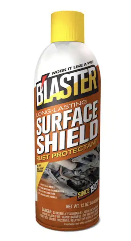

    I just sprayed the entire frame of my new Limited (1,000 miles) with this:
    The process did include lowering the spare tire, and spraying the chain, mechanism and the wheel.

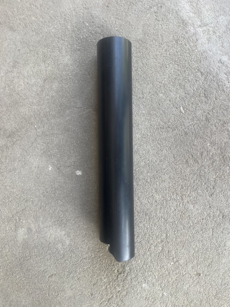

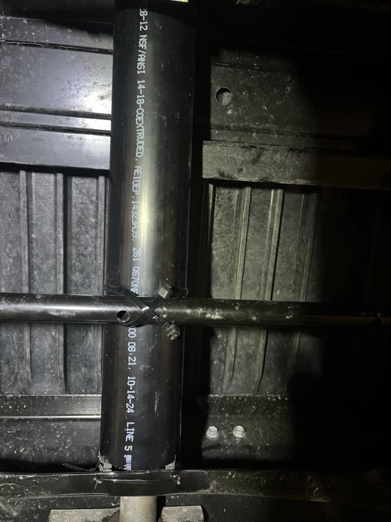

    I will admit freely that I stole this idea from the Tacoma forum and used it on my Tacoma before I upgraded to my Tundra. ( and my brother in law, a Chevy guy, says that they have a tube built in to there truck) but I made a modification that makes it really easy to raise and lower the spare.
    I took an 14 inch section of a 2 inch PVC pipe (my Home Depot sells them in two foot sections), cut a notch on one end that is one inch long and 1/2 inch deep, and rounded off the corners of the notch so it fits over the shaft where the hook is supposed to fit in. I secured it to the crossmember with two zip ties and drilled a couple small holes in the rail that supports the shaft and used a small zip tie to keep the tube aligned with the shaft. The hook slides in the “bumper” slot and is directed into the slot. It might align better if a made a little notch where the tube rests on the crossmember, but I’m thinking I’m not going to need it often enough to take it apart to make that change.

    Awesome idea!!!
