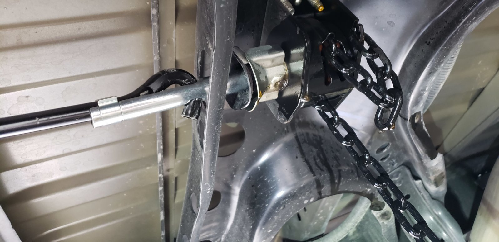

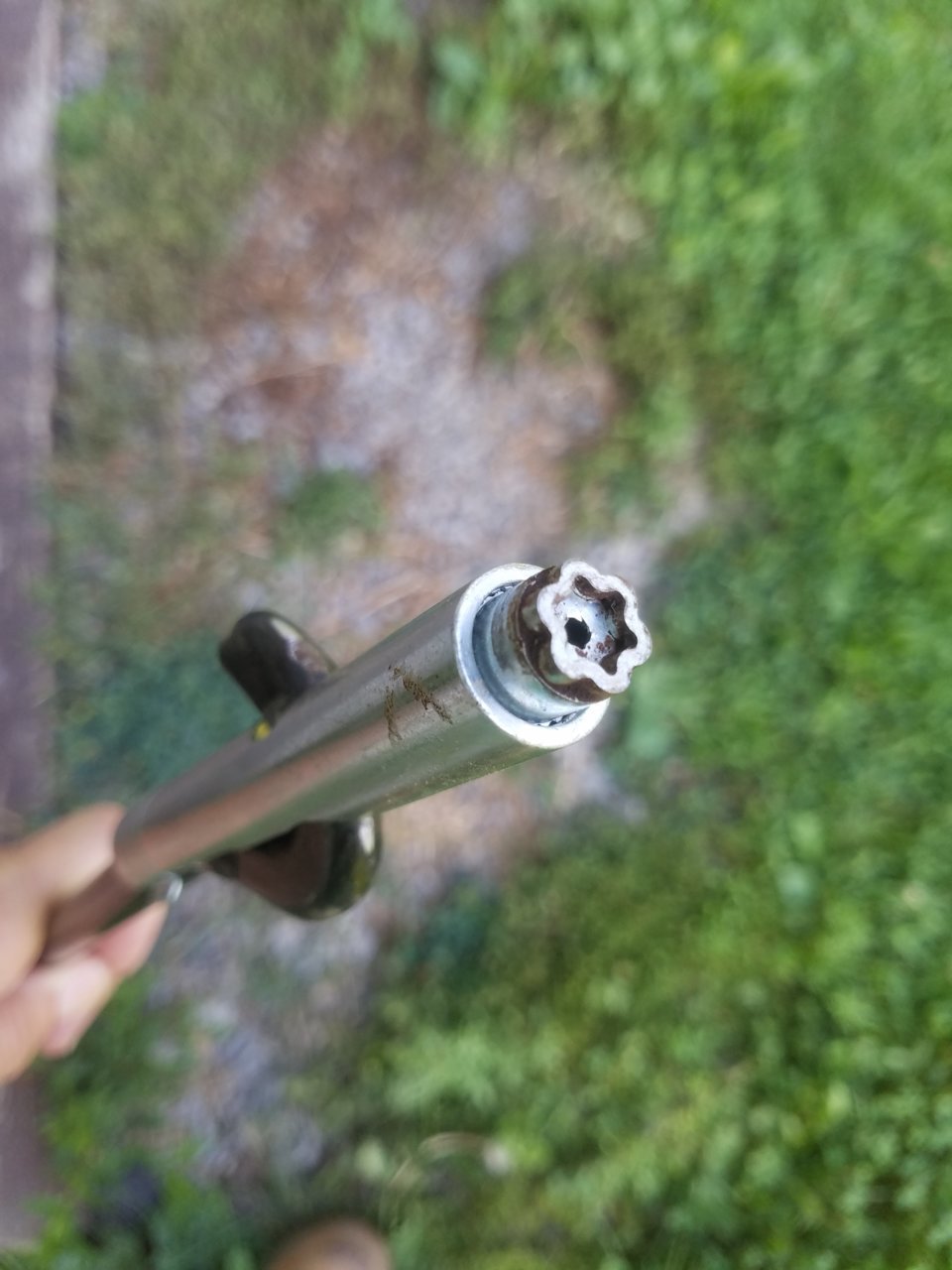

    2016 , so I went to lower the spare tire and finally realized that I need to use the "security" socket tool to lower it...I got that to fit but of course it won't turn, Soaking it with penetrating oil..Is there a way to get the regular Hook on the tool end to fit into the hoist, looks like rubber is blocking the slots...Thanks.

    That's a spare tire lock that someone installed on your truck. The trucks don't come with them from the factory.

    I think you have replace the whole hoist. Ran in to this terrible design on my buddy’s Tacoma.
    The lock appears to be pressed in there very well. May be able to get it with a bunch of work but a new hoist is only $50 so not worth the hassle and worth the price to not have to fight with the key matching up on the side of the highway or a muddy trail.

    That black hook between your hand and the security socket is what you insert into the opening to lower the tire. It doesn’t actually hook in just insert the rounded end into the opening and turn slightly to make it engage and then unwind the mechanism to lower the tire.
    Save that security lock so you can remove a tire.

    Nope you have to put the key on the end as shown and line it up blindly and by feel only to crank it down. The lock is pressed into the slot that the hook makes contact with for us that don’t have the lock.
    It is a gigantic pain in the nut sack!!

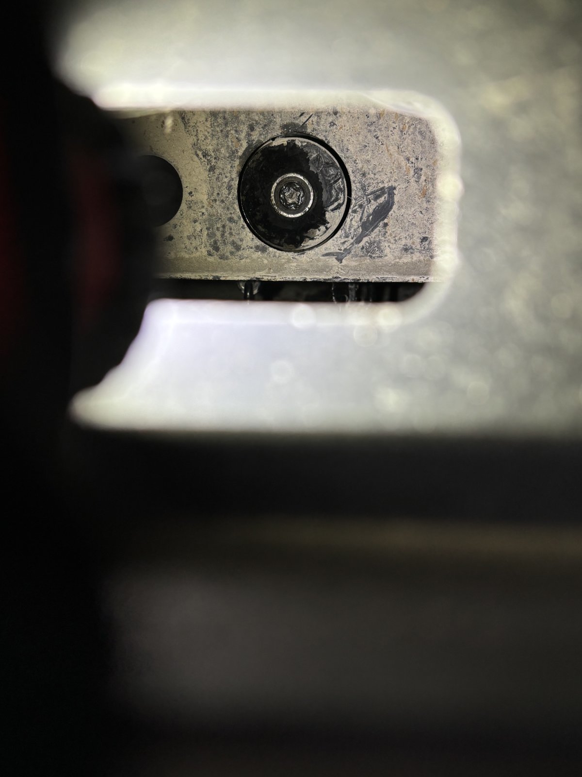

    Took us like 20 minutes to line it up properly. That picture there is no tire so you can easily see it.
    With the spare in place there is no way to see the key/lock orientation.

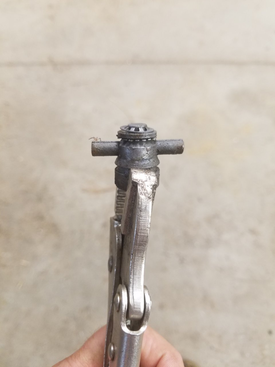

    Update, I had ordered a used one from Ebay, it got cancelled by the seller and refunded. So for kicks, I heated the outside of where the security lock fits in the hoist , grabbed security lock with vice grip, hit the assembly with a hammer and it came out.. so I'm back in business with original setup..

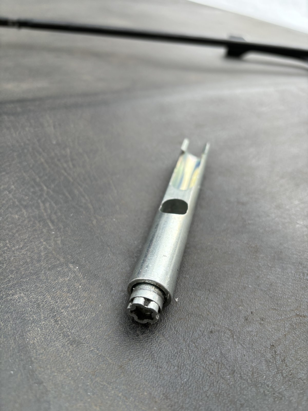

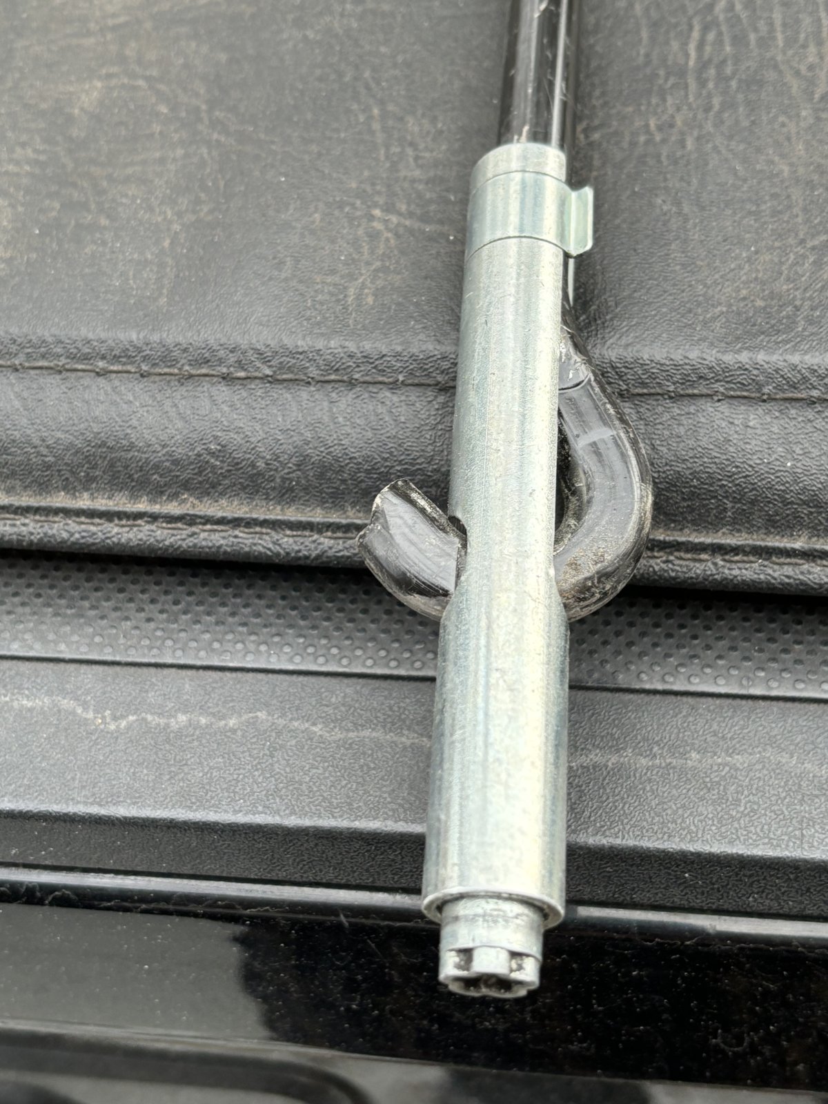

    Yeah, this took me way too long to realize than I'd like to admit. The security bit was lodged in the tire iron bag and I didn't realize it. After finally attaching it, the hoist was easily engaged. I dropped the spare on my '20 TRD Pro to prep and inspect it.
    Here's an image of the tire iron with security key inserted into the hoist

    Wish mine looked that clean. I removed my security bit..
