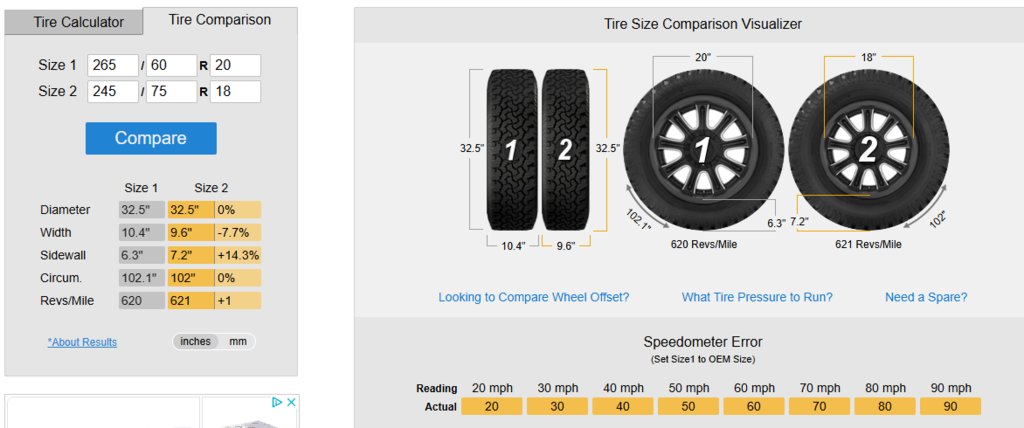

    Have a look under your truck, I think you’ll find a 245/75/18 tire, not a 265/60/20!

    Your spare is the same height as your other tires and just a .80 inch narrower.
    It's a spare tire, not a replacement tire.

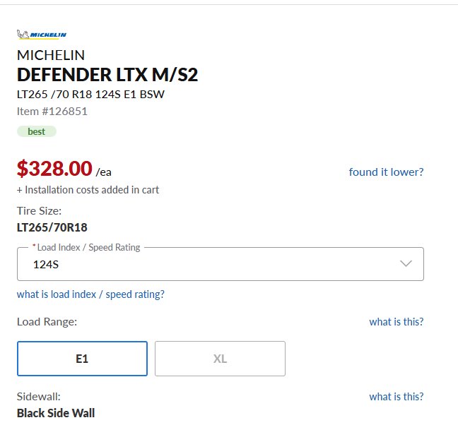

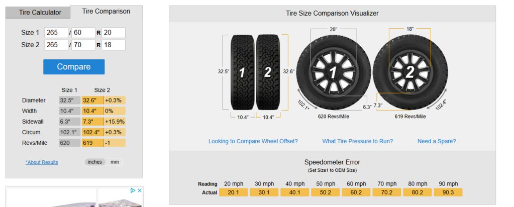

    If that width or tire rating is a problem, buy a 265/70/18 Michelin E-rated tire and use it as a spare on your 18" wheel..
    Bottom line is you are overthinking a problem that doesn't exist.
