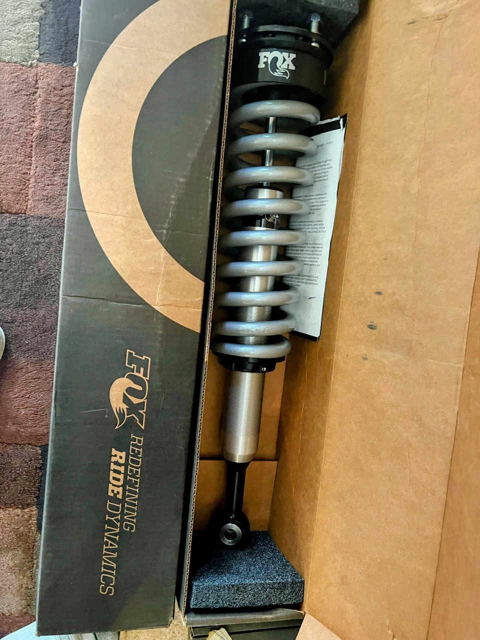

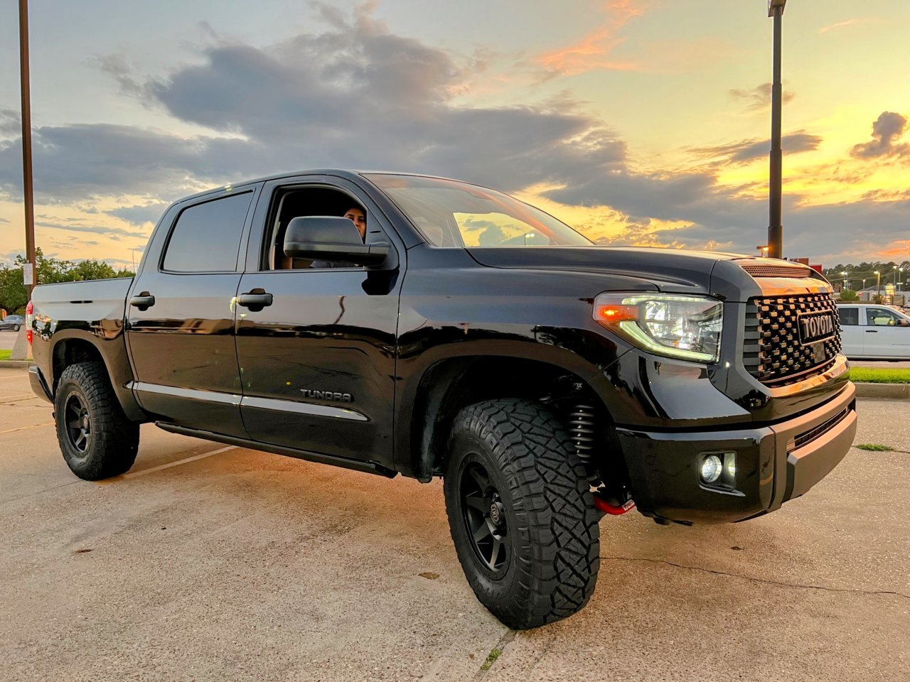

    Just wanted to share my input here in case it helps anyone out.

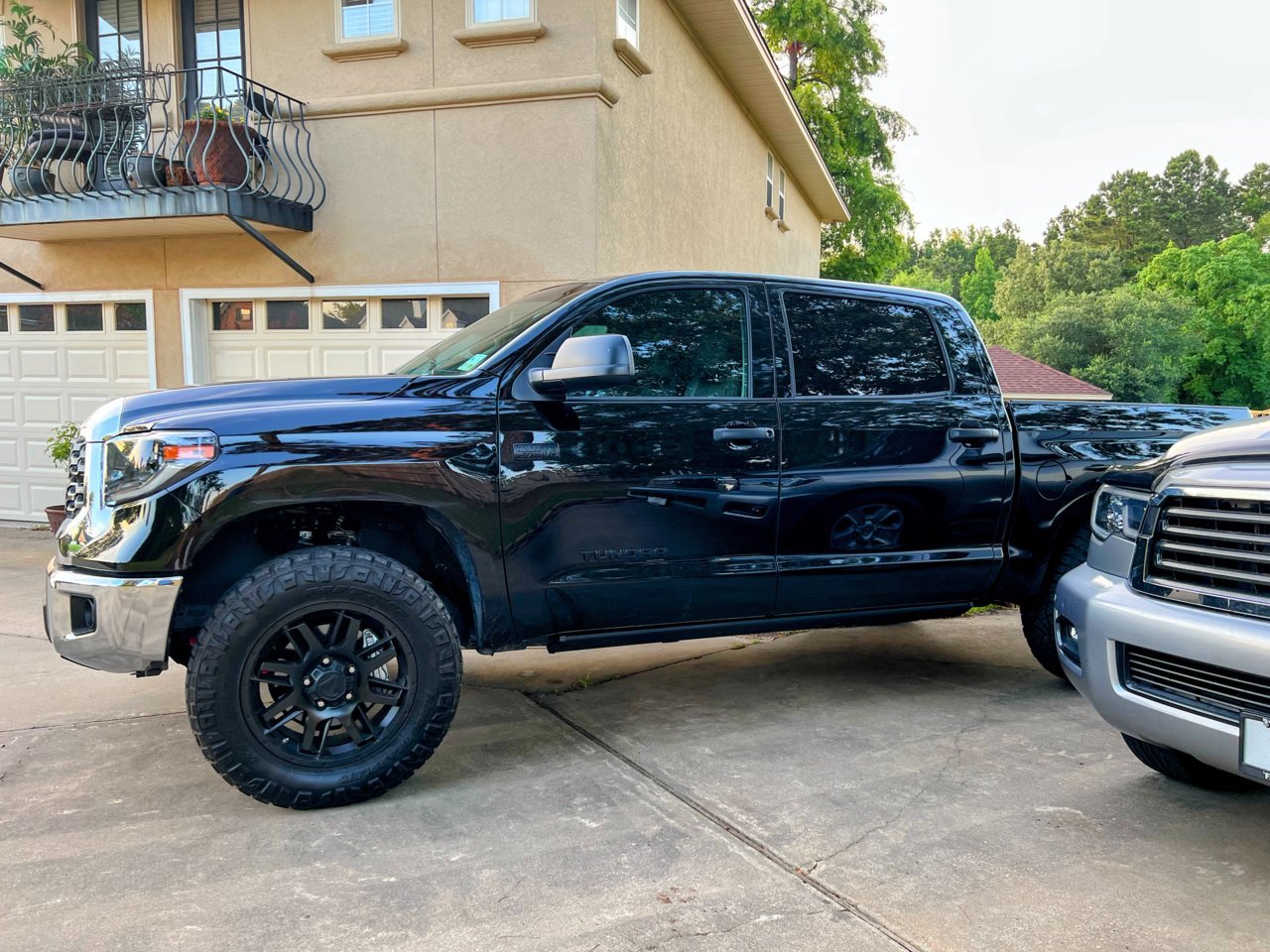

    I initially threw 2” spacers on my truck to level it out cause I knew I wanted beefier tires. I did some research on suspension lifts but felt that it was out of my budget at the time and thought these would be a good temporary solution. I was able to fit 285/65r20 nitto rg’s (34.8”) and was happy with the look but not the feel. To say it rode rough is an understatement. Even the dip backing off my driveway would feel like the truck was on stilts.
    I decided the spacers needed to go. I didn’t want to go overkill but wanted the improved ride quality so I went with on fox 2.0s with rear resis. I spoke with a friend who runs them on his f150 and he said it rode plush on street. Mine is seeing pavement 90% of the time so it’s working out perfect.
    The ride quality is super nice! It’s a day and night difference. It handles way better, soaks up bumps, and is a joy to drive. Very happy with the decision and ride quality.
    IMO the Fox 2.5s tuned by AccuTune would be my top choice if there was no budget and will be something I’ll be looking at in the future. But the 2.0s are currently doing a hell of a job for me and just thought I’d share that for anyone on the fence.

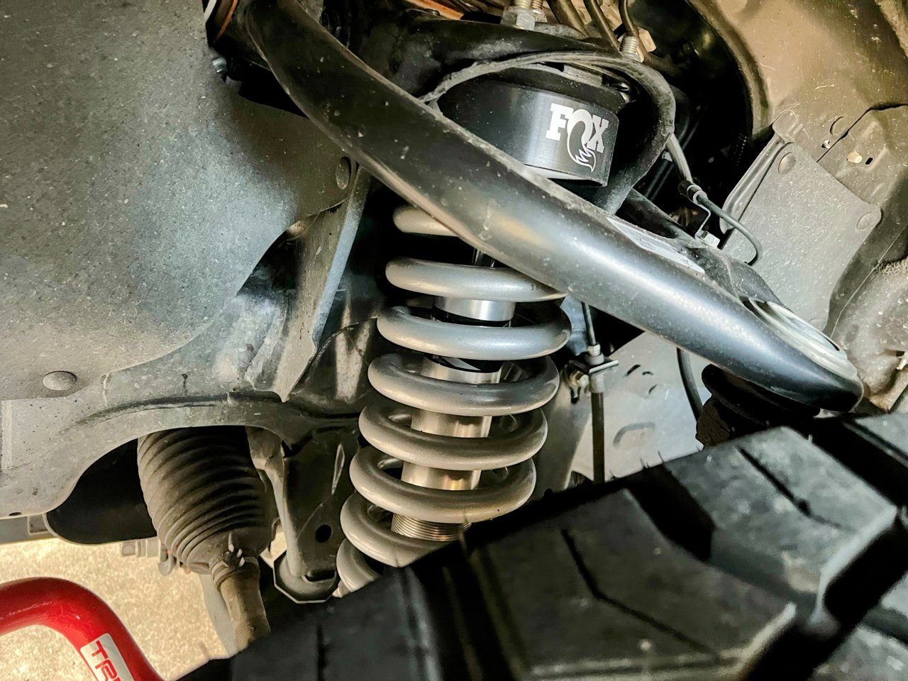

    Did you keep the spacer on top of the Fox Coilover?

    Nah I didn’t although I can see how that pic looks like it. This is how they came out of the box.

    Nice set up. What wheel and tire combo are you running?

    Thanks, man! Running 285/75r17 nitto ridge grapplers on icon rebound 17 inch wheels
