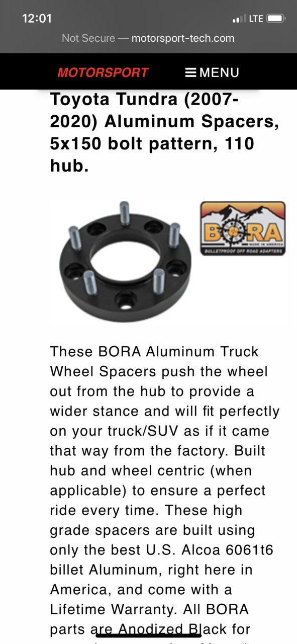

    I just bought the 2020 SR5 TRD Offroad Tundra...
    I am currently out working, away from home and my wife went to have some Cooper STT Pro tires put on stock rims (275/70 R18) and asked about adding the 1" spacers on my behalf.
    The salesman told her, "they haven't came out with spacers for the 2020 yet"...? Then offered after market rims for the same look. Was he just trying to up-sell? It's my understanding that Tundra's have 5x150 lug pattern and that these spacers are available in many different brands.
    I'm new to Tundras and a new Trundas.com member... but I am loving this truck already! Even though I have not even seen it in person yet. Thank you for the many forums covering all aspects of these powerhouse trucks!... as I have spent a lot of time reading forum conversations and admiring many of your beautiful Tundras!

    These are what I’m running

    From the Manufacturer (Owner) at Motorsports Tech (BORA Spacers)
    Lenny Stahl
    5:09 AM (1 hour ago)
    to me
    Our website has spacers listed for a 2020 tundra. They have been the same since 2007 so he’s either an idiot or he’s pushing for the wheel sale.
    We don’t really recommend sizes when it’s just for aesthetics. One guy might love the look of a size, the next one might not.
    If we recommend a size and you’re not happy then we have to eat the cost of spacers, shipping and labor.
    Now a 1.25” Is pretty popular with a stock 275 tire but it comes very close to the mud flap in front. Most guys just remove it. 1” would have a little bit more room but the tips of the studs could need to be trimmed slightly if they don’t recess back in to the wheel. Now most OEM wheels do have pockets but it’s always safe to double check before heading on down the road.
    Hope that all makes sense.

    Bora are good spacers. You don’t want to trim the studs in case you want to remove them later. I removed my front mud flap.
