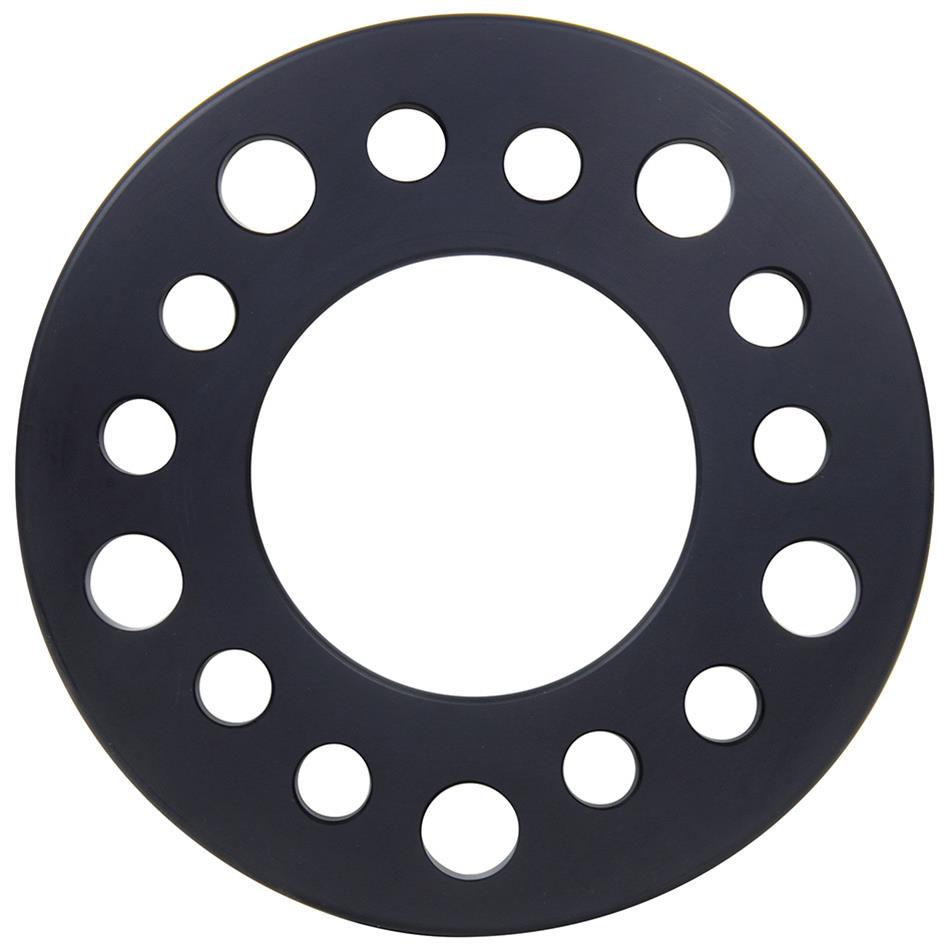

    Theres some confusion here. All wheel adapters are spacers but not all spacers are wheel adapters.
    These are a wheel spacers.
    Wheel adapters can be used to mount different lug patterns, however they can also be used as spacers with the same lug pattern as you currently have.
    The spacer shown above is where the laws are typically concerned since you may not get enough thread engagement with the spacer mounted.
    Spacers IMO are a bad plan, adapters are fine as long as they're installed properly.
    focal, Sunnier and Hbjeff like this.
  24. Nov 16, 2019 at 12:44 PM
    #24
    Hbjeff
    Hbjeff New Member
    Jan 20, 2019
    #24845
    5,149
    Huntington Beach
    2010 DC 5.7 2wd
    Omg those old slide on spacer are still made? Those are terrible
