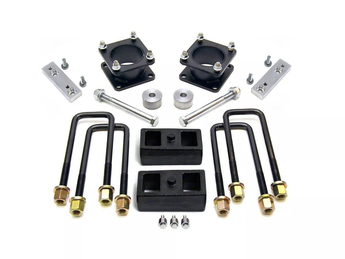

    A spacer kit and a leveling kit are the same thing. The only difference is that a leveling kit is just a spacer up front and is a smaller lift. A spacer kit is usually a 3 inch lift and will usually have a block in the rear.
    Allen.Tee[QUOTED][OP] likes this.

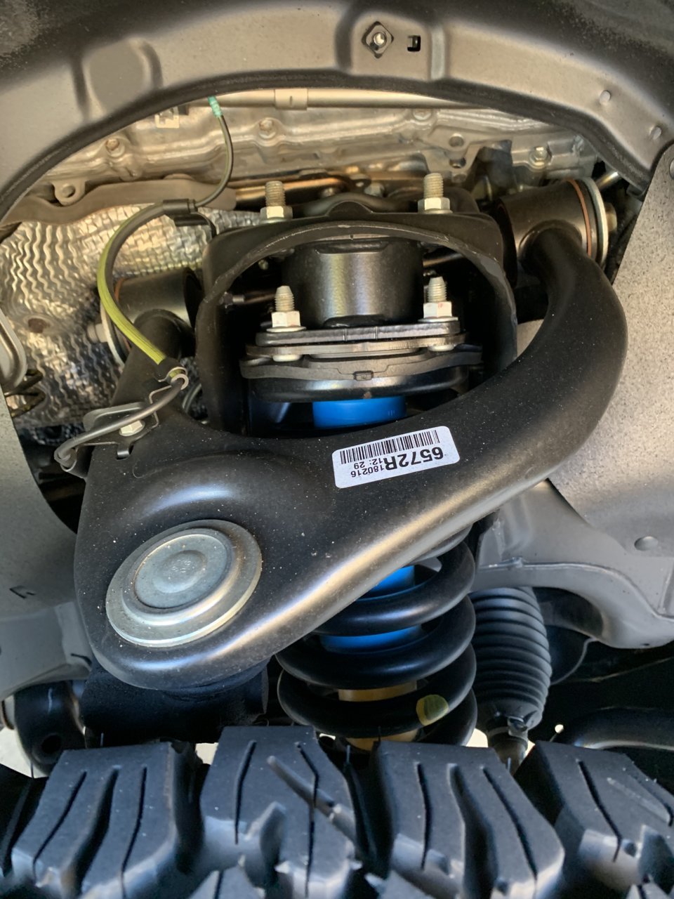

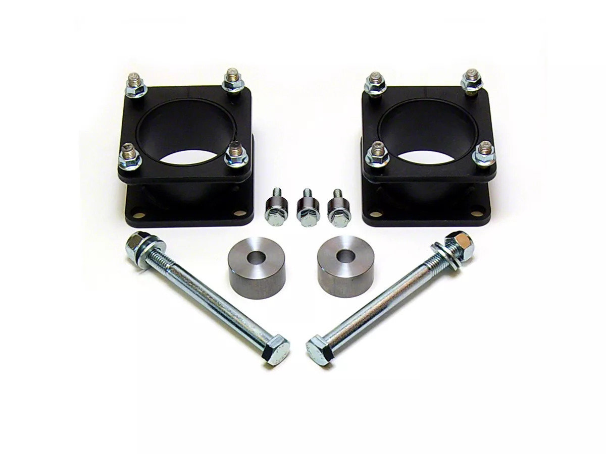

    Pic 1 is a spacer kit. Pic 2 is a leveling kit.
    Allen.Tee[OP] likes this.

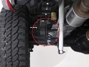

    Post a picture of it...most likely you will have a 1.5 or a 2 inch block.

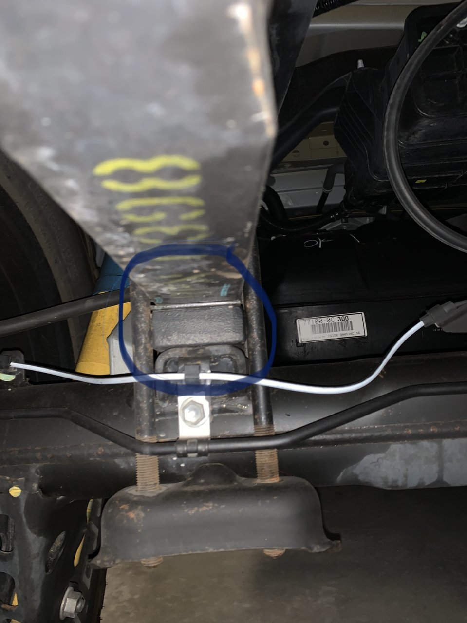

  16. May 28, 2021 at 10:22 PM
    Allen.Tee
    Allen.Tee [OP] New Member
    May 25, 2021
    #63506
    35
    2018 Cement Tundra TRD OR 4x4
    None, don’t know where to start.
    Is it this? I circled it.
  17. May 28, 2021 at 10:25 PM
    15whtrd
    15whtrd Mr. Blonde
    Sep 20, 2015
    #1829
    9,375
    Sean
    SoCal
    Yep. Looks like you have a 1” block
