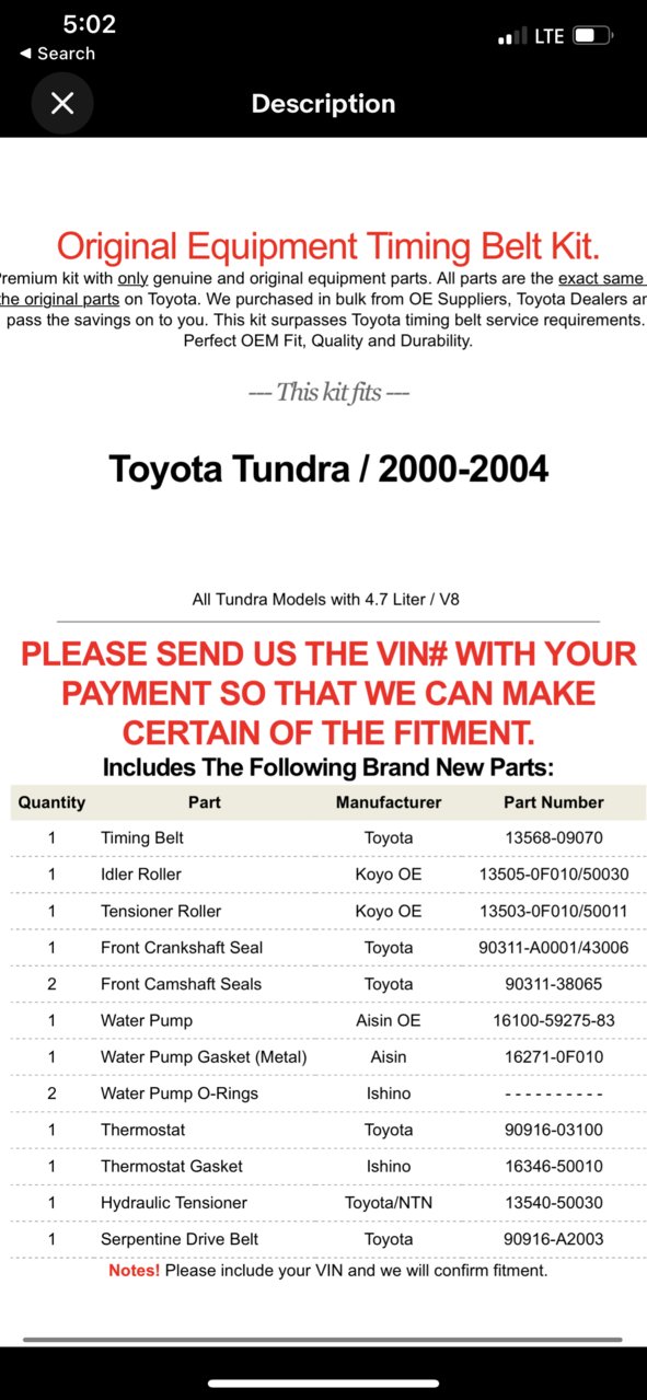

    Also attached is a list of the new parts that went on with the timing belt job.

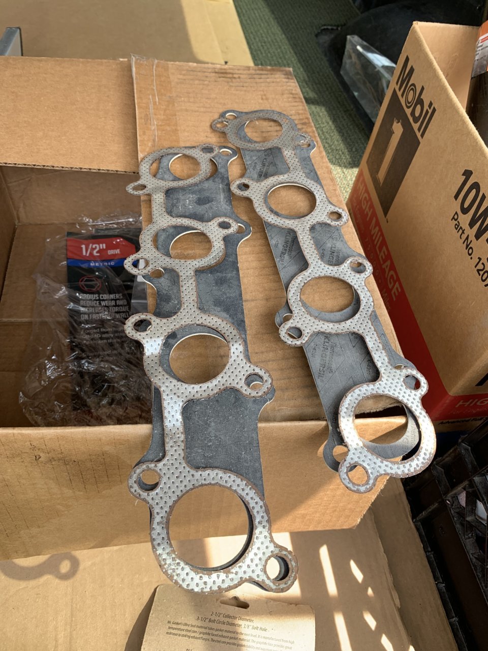

    I just realized that the headers I put in are actually 'pacesetter' brand. I got them from someone on fb marketplace with that gasket I used included.
    The gaskets on the underside are what I used, no I did not double stack them.IMG_7517.jpgIMG_7496.jpg

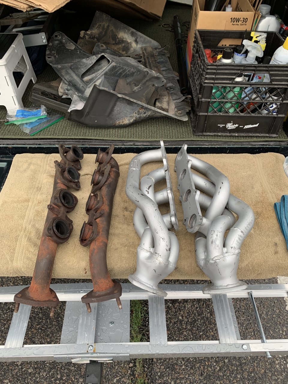

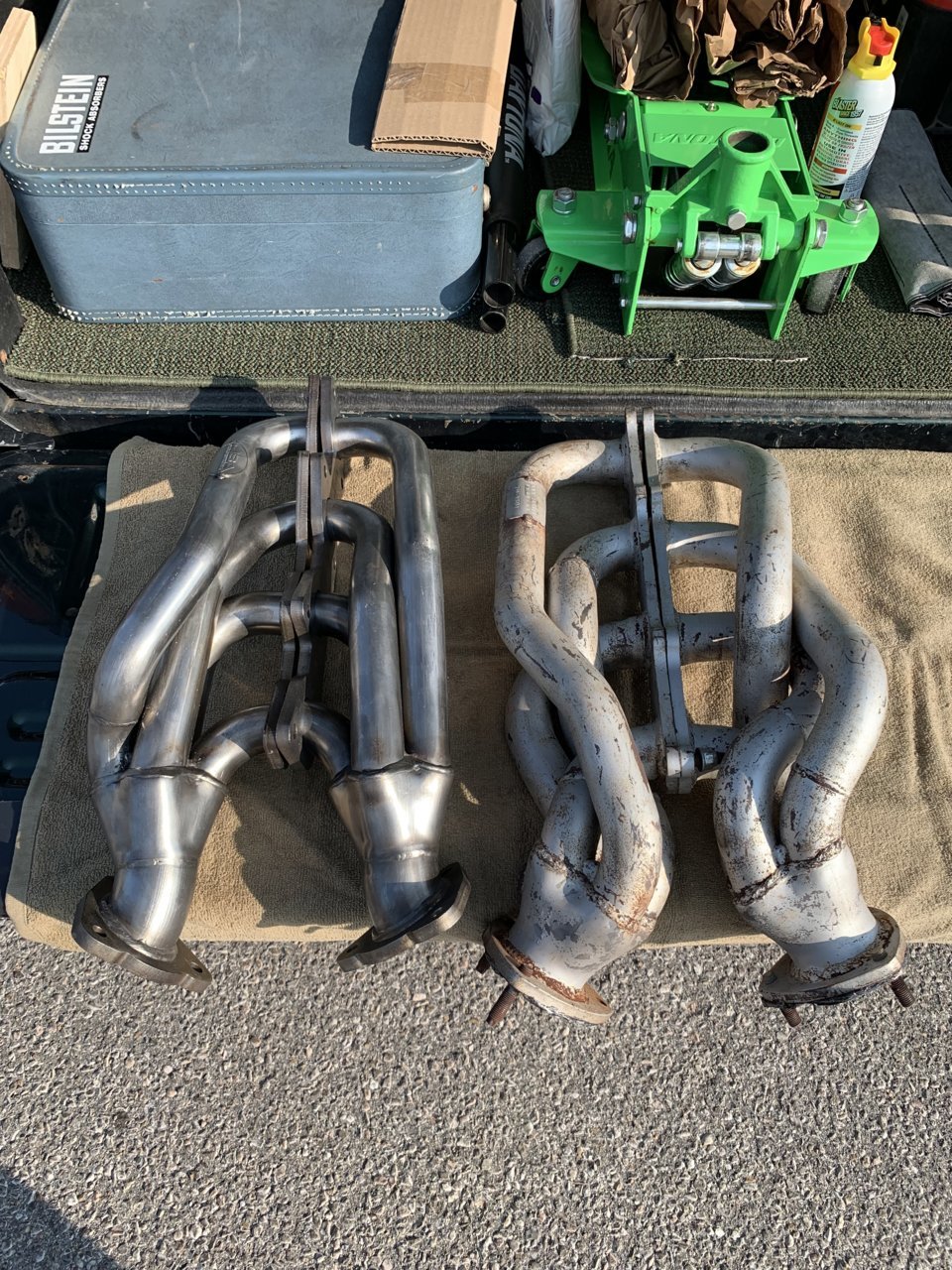

    JBA (Left) vs Pacesetter (Right) for anyone curious
    I believe the fb marketplace guy I bought the pacesetters off of said he paid someone to coat them. The corrosion shown is after 2 months/2k miles on my truck.
