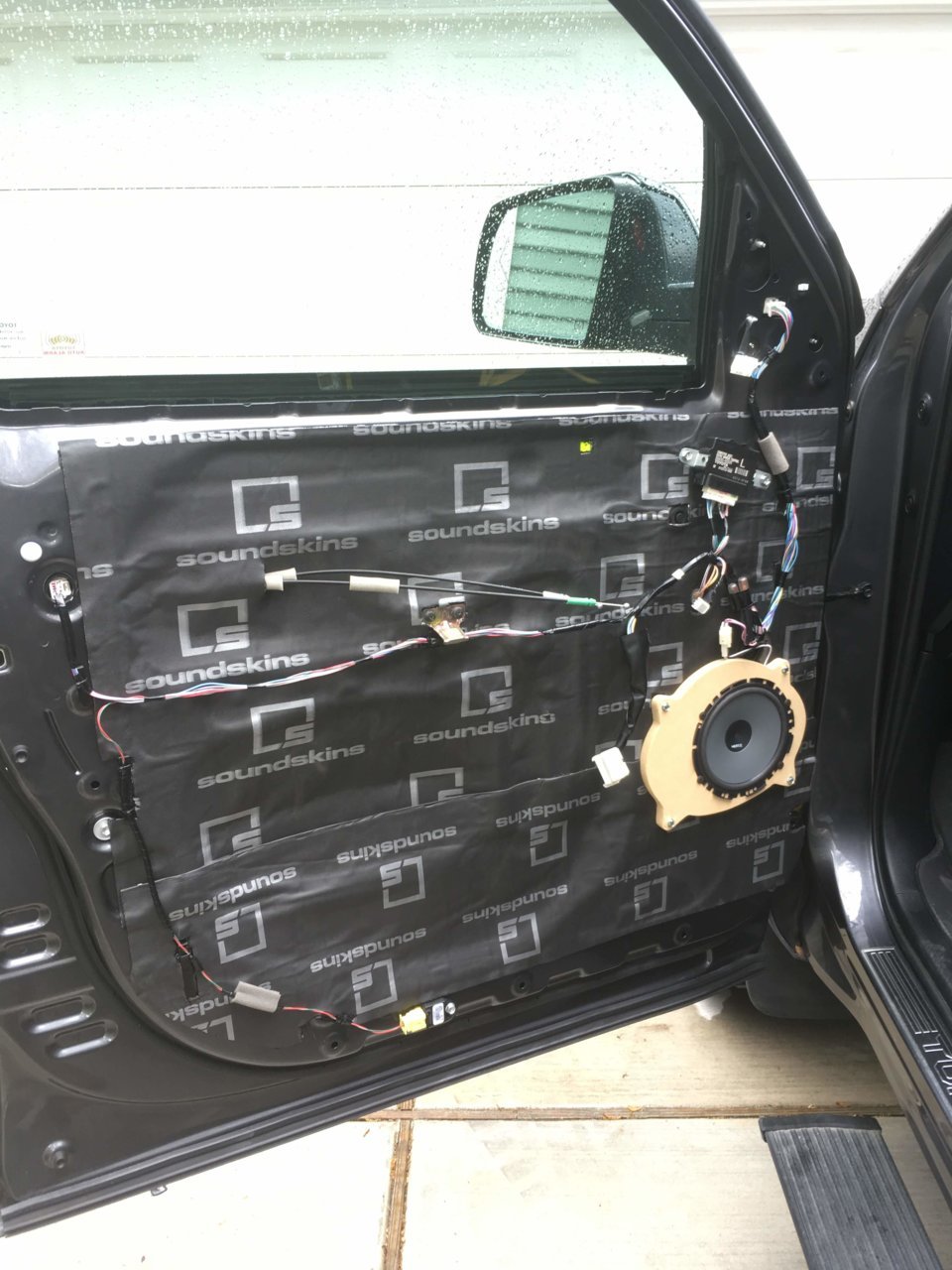

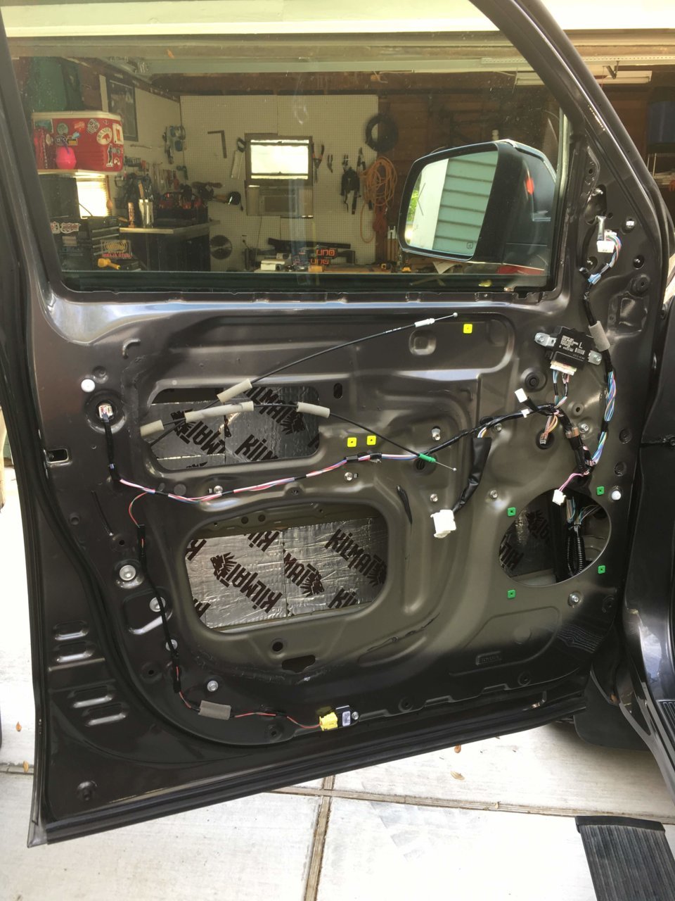

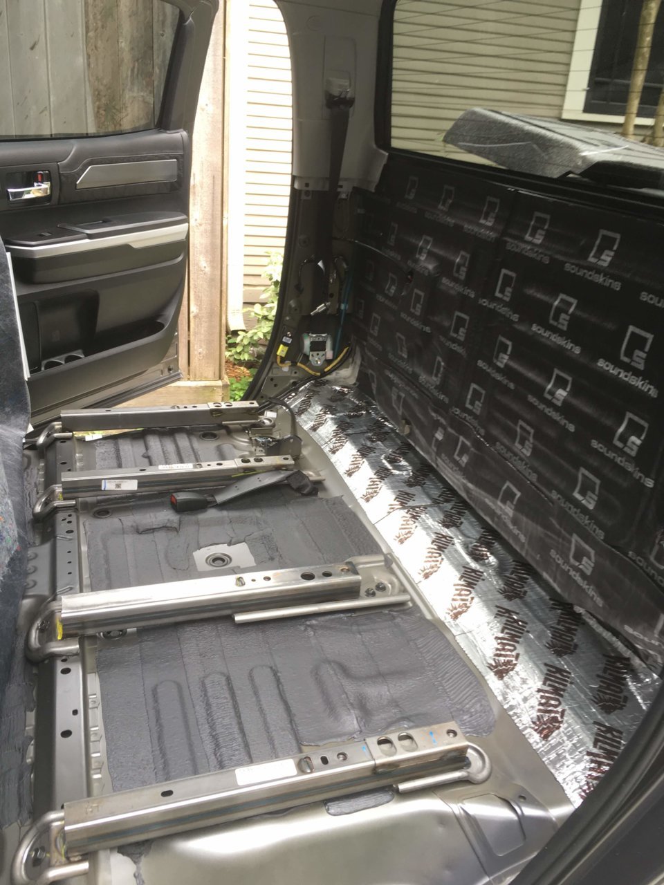

    I am going hardcore, Kilmat cheap lining on the outer door skins, but full Soundskins on the inner wall. I want this thing quiet on the highway as well.
    I put some of the kilmat in the back tailgate while I was at it too.
