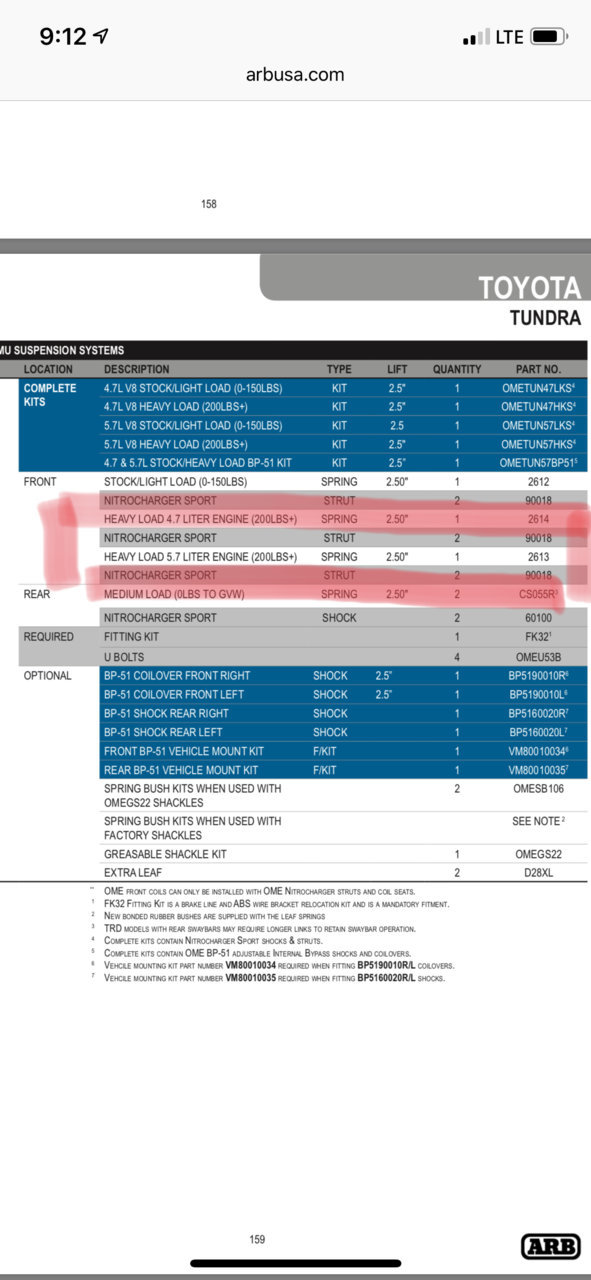

    Hello, my name is Bentley, and I now drive a silver/ grey 2014 Tundra crewmax 4wd limited. I purchased it used with 70k miles from Larry H Miller Toyota. I want to thank you all so far and in advance for having this forum, it has helped me a lot. So far I have done the storage mod under back seats, and recently OME front lift. I asked for the 2.5 to 3 inches 2612 springs but ended up getting 2613 springs by mistake from parts, which put me at 4 inches. Working to get that straightened out this coming week. Again thank you.

    My name is Marc,
    I’m the parts manager at LHM Toyota.
    The 2613 should only be 2.5” lift.
    Matter of fact all of them are only 2.5” lift.
    Give me a call this week.
    I’ll get you taken care of.

    I have that same OME setup with the 614's. That will put you around 2 3/4". Definitely at least 2.5"

    You guys always take care of me that is why I keep coming back. Yeah I will, I was told to get a hold of you tomorrow to get things straightened out. Thank you for replying. Yes they are all 2.5 inch lift depending on the load on the front end. ( The 2613 is a heavy load spring, while the 2612 is a stock load up to 150 lbs. )

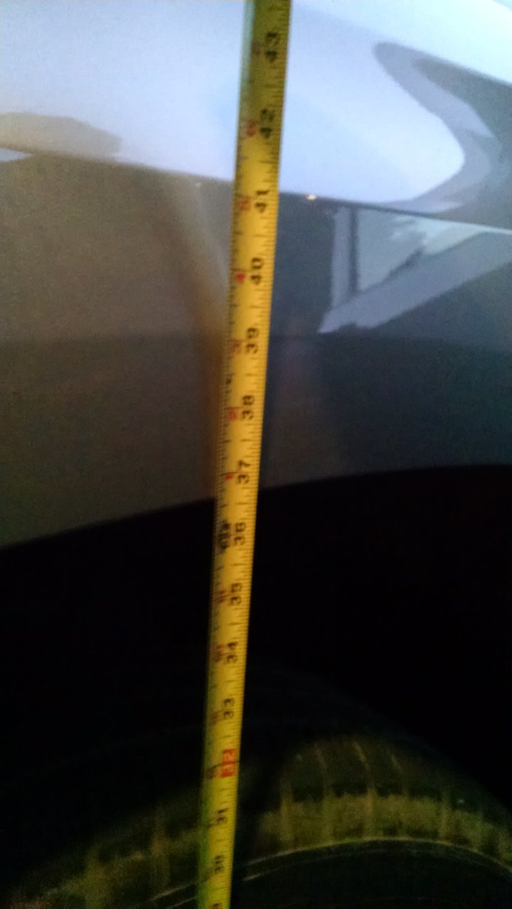

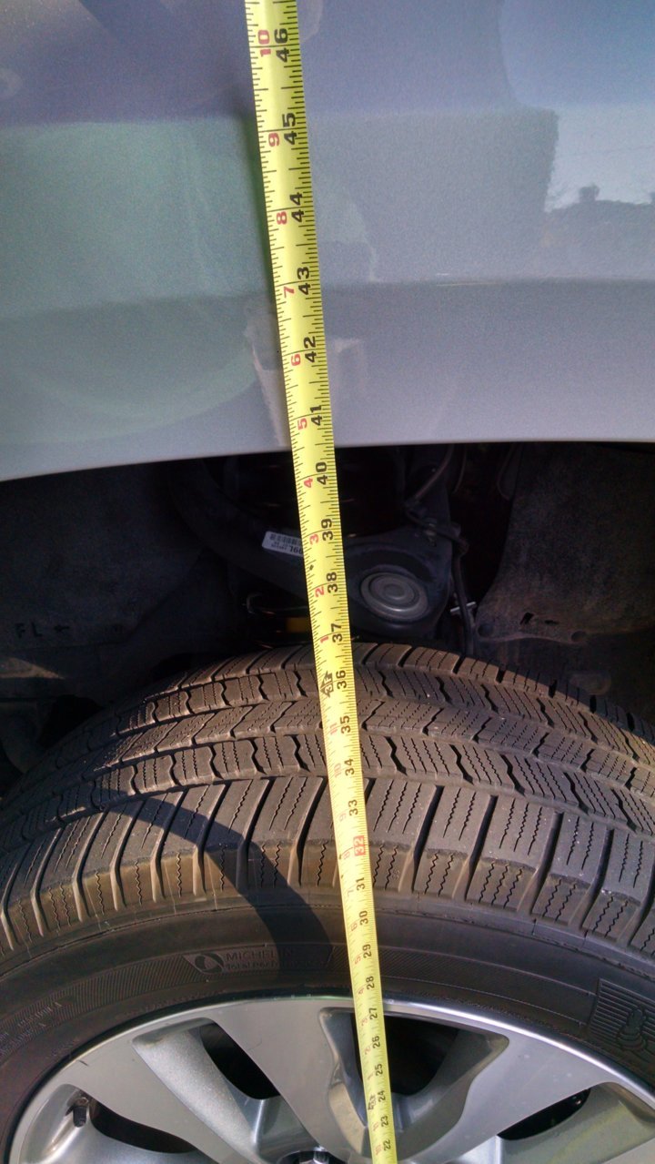

    This is before. . . the second is after.

    Maybe the coilover was assembled incorrectly? Thats a significant difference, looks like stock tires still as well.

    After I posted the pics and what I thought the problem was the Parts manager from Larry H Miller Toyota contacted me to help resolve the issue I was having. He then reordered the part and set things up for them to be reinstalled, at no charge to me, when I went in for my tranny flush this past Saturday. He then followed up to make sure things went well and I am satisfied. All I can say is AWESOME CUSTOMER SERVICE! They always take care of me when I go there, and that is very important to me.

    He had the 2613 springs, which are the heavy loads.
    They were just too stiff for a stock truck.
