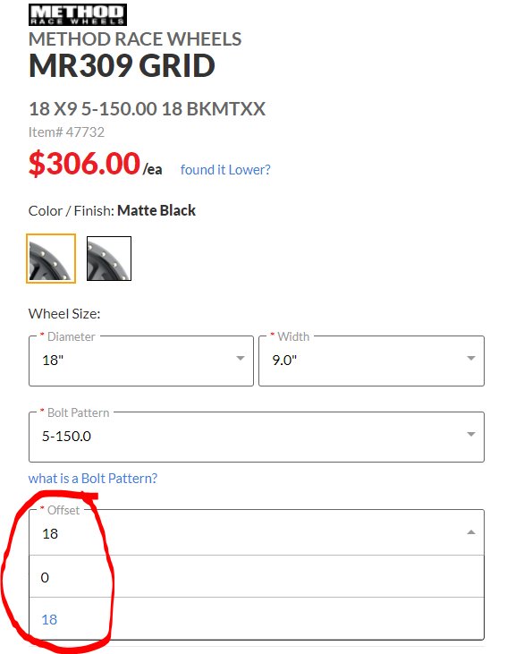

    I was looking at method grids
  4. Jun 21, 2020 at 9:36 AM
    32,923
    What offset?

  10. Jun 21, 2020 at 9:47 AM
    32,923
    According to Discount Tire's website that wheel is available as with 2 offsets. Both are going to stick out more than the +25, so you will probably have more rub than he did.
    csgaddy[OP] likes this.

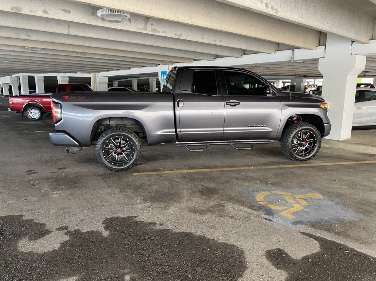

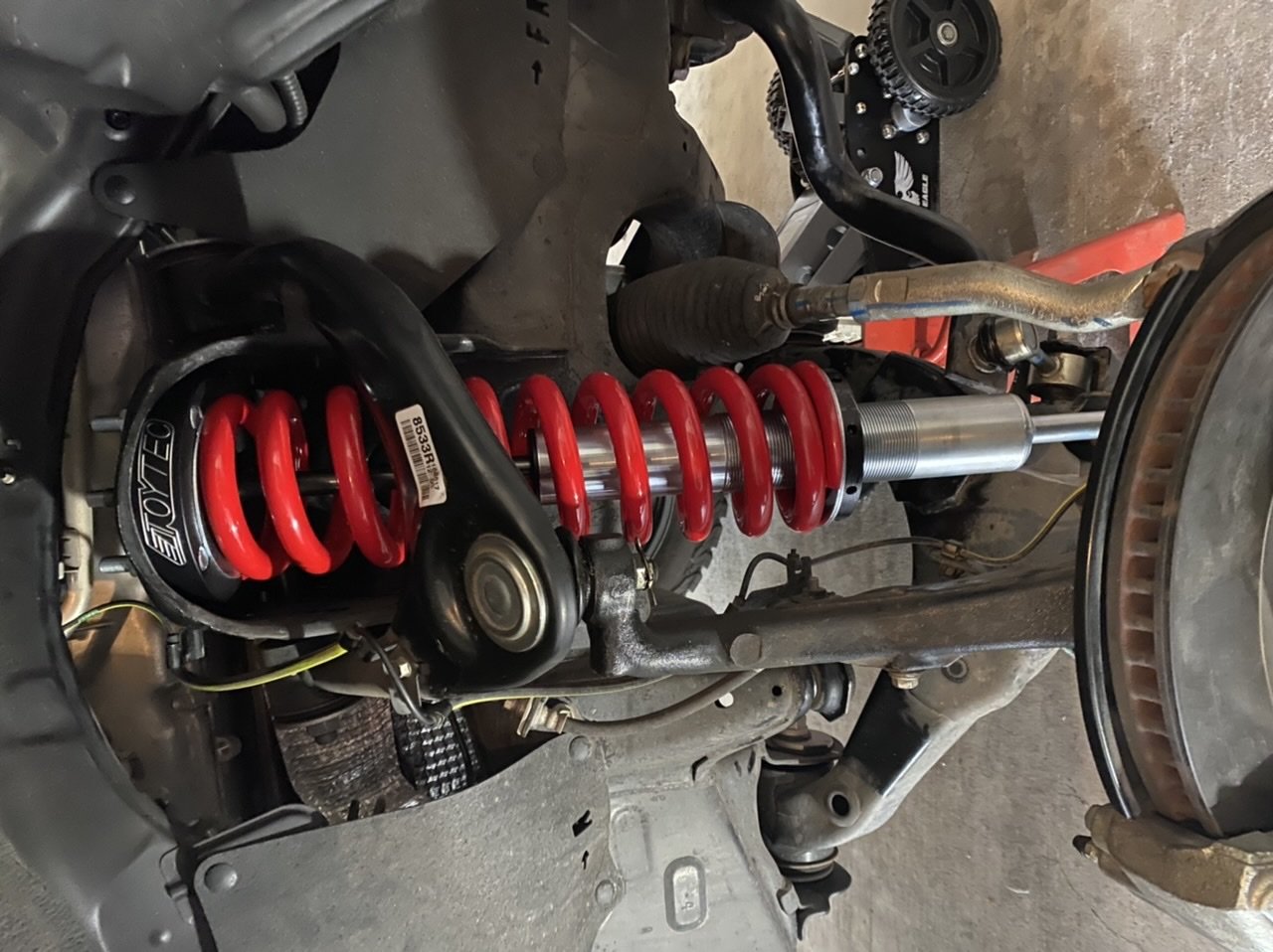

    I have the Toytec Boss in the front and have been pretty happy with them. Glad I went with something that was adjustable on the truck because I have had to make minor adjustments to dial them in since installing. My wheels 20” with +20 offset and tires are currently 285/55.
    40C3E2AD-DD9A-472E-8516-D256C0BC6CC0.jpg F937845E-ED08-438B-AF94-FB1D2676EEC8.jpg
