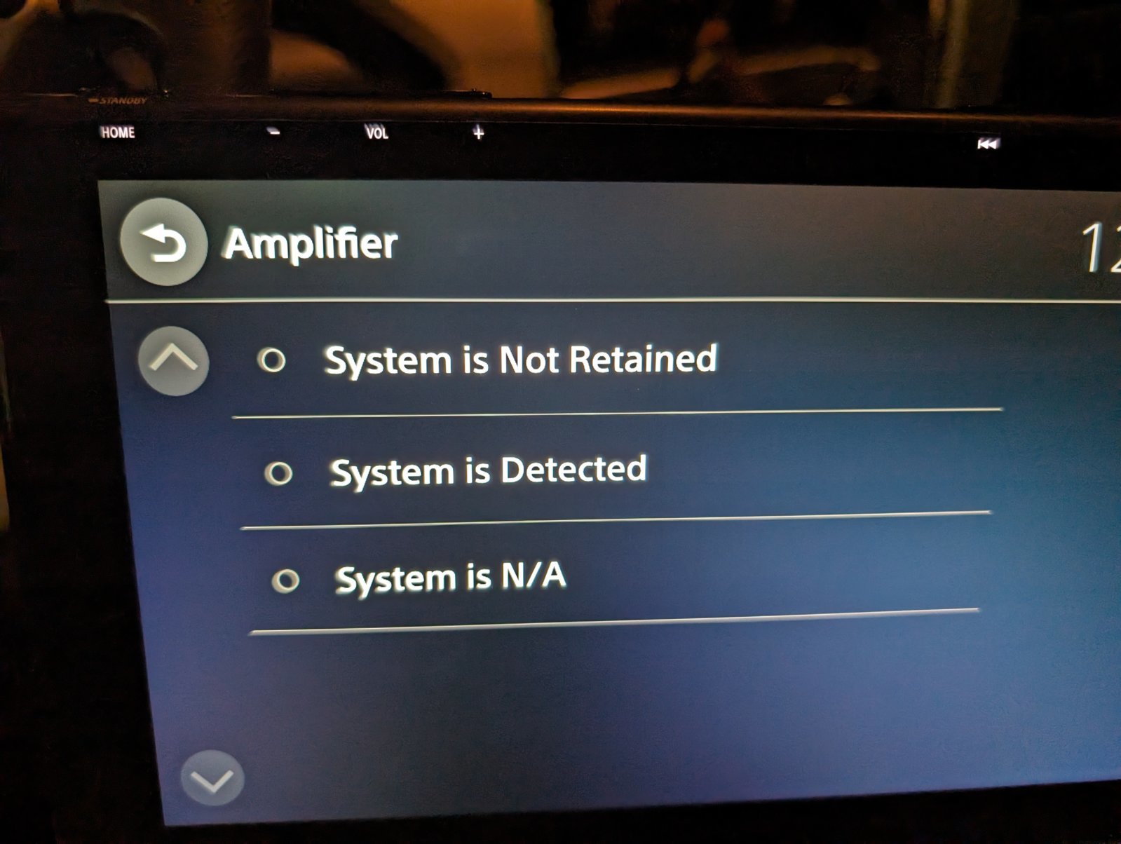

    Reset the Maestro twice, no luck.
    It's showing this in the system settings.
    Am I missing a firm wear update? I'm unable to toggle anything.

    Everything plugs in, everything works, except I get no sound. Checked all the settings, ensured Mute cycled. Nothing. AMP is not firing up. AMP and sound system work fine with the factory head unit, which has gone back in several times now.
    I'm guessing it's something faulty with the Masetro RR. As above, it continues to show in the menu "amp detected, not retained, N/A" and in another screen shows AMP inputs as OFF and I'm unable toggle on.
    I've reached back out to TG and I'll reach out to Maestro. I'm thinking the unit needs reflashed via laptop.

    Caught CS at MAESTRO, they ran the serial and the unit had been flashed for NON-JBL. Sent me a link with a video, followed it, flashed JBL and it works flawlessly.
