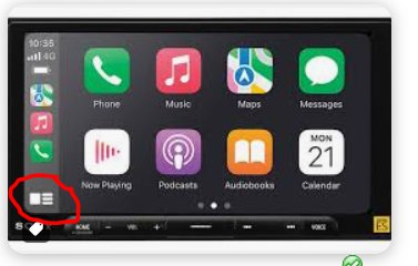

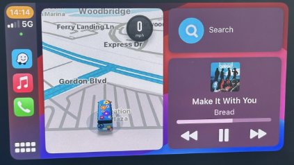

  7. Jan 10, 2025 at 8:14 AM
    Snert
    Snert New Member
    Jan 31, 2024
    #111218
    681
    2021 SR5
    If you have music playing on say Spotify for example, and a route on Google Maps, clicking this split screen button in the corner:
    should make the screen split and look similar to this:
    This is only for reference/I grabbed a screenshot from google but it looks more or less the same as my 9000ES/the carplay split screen looks about the same on any head unit, looks about the same on my wife's CX-5 head unit.

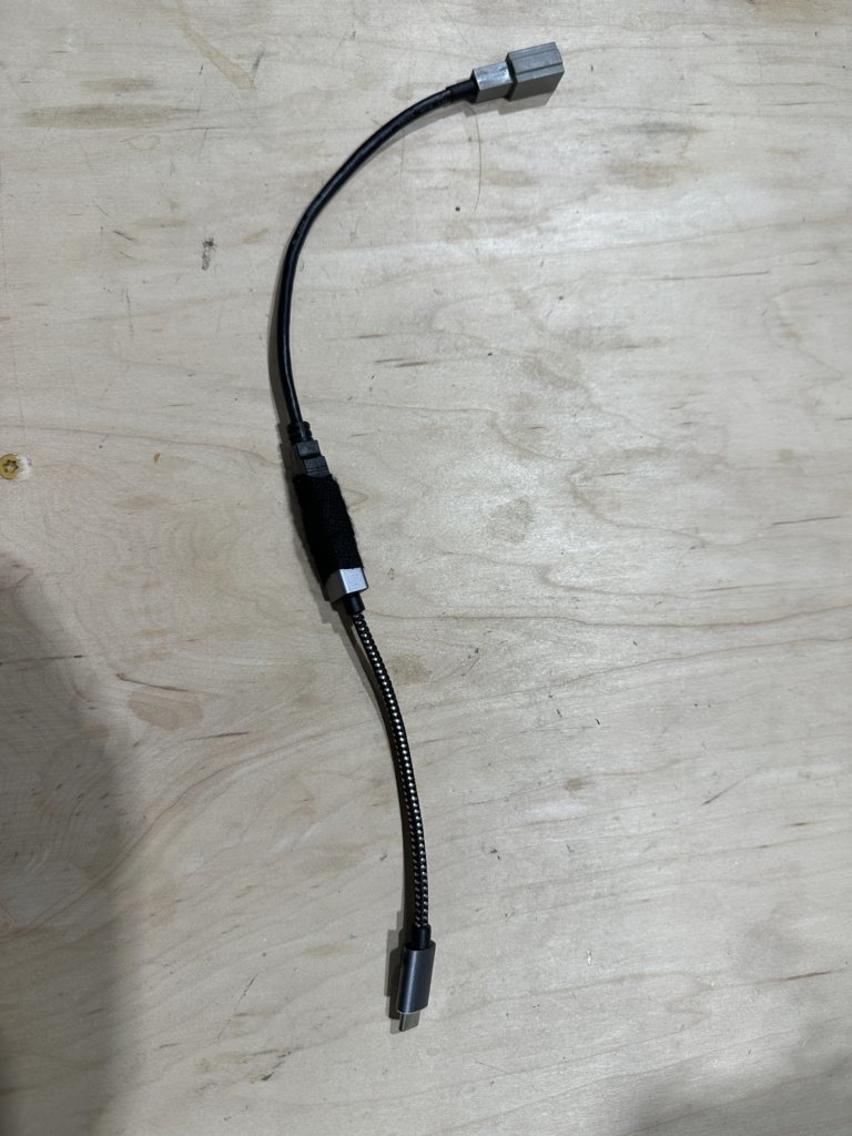

    Ok so they only sent me on of these cables .they are now sending one .So does this just plug into the ubs-a that is on my 19 tundra dash by cigarette lighter . If so after hooking up what do I use to make sure it works. Phone or what else. Will it show Phone charging? Hate to put together again an find out it's not working. Thanks IMG_1513[113].jpg
  16. Jan 13, 2025 at 12:39 PM
    BuckWallace
    BuckWallace Ball don't lie.
    Nov 25, 2017
    #11160
    1,884
    Oregon
    Sierra 3500 AT4 L8T
    The small end (USB-C) will plug into the back of your new Sony head unit, and the other end will connect to what is likely a loose plug behind the stereo. The loose plug is what feeds to your USB in the dash. The bad/annoying news is you or your installer will have to pull the head unit back out to get it plugged in.

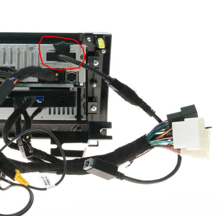

  20. Jan 14, 2025 at 7:41 AM
    Snert
    Snert New Member
    Jan 31, 2024
    #111218
    681
    2021 SR5
    This is the back of the 9000ES that I have but 9500ES should be the same, USB will plug in back here: upload_2025-1-14_9-33-38.png
    other end will plug into the only USB slot/cord it fits with. To be cautious I'd disconnect your battery negative before pulling the radio, wire it up, set the radio back in but don't bolt it in, reconnect your battery negative and start the truck, and then plug your phone into the USB data port
    The other two USB slots are charging only so be sure to plug into the correct one.
