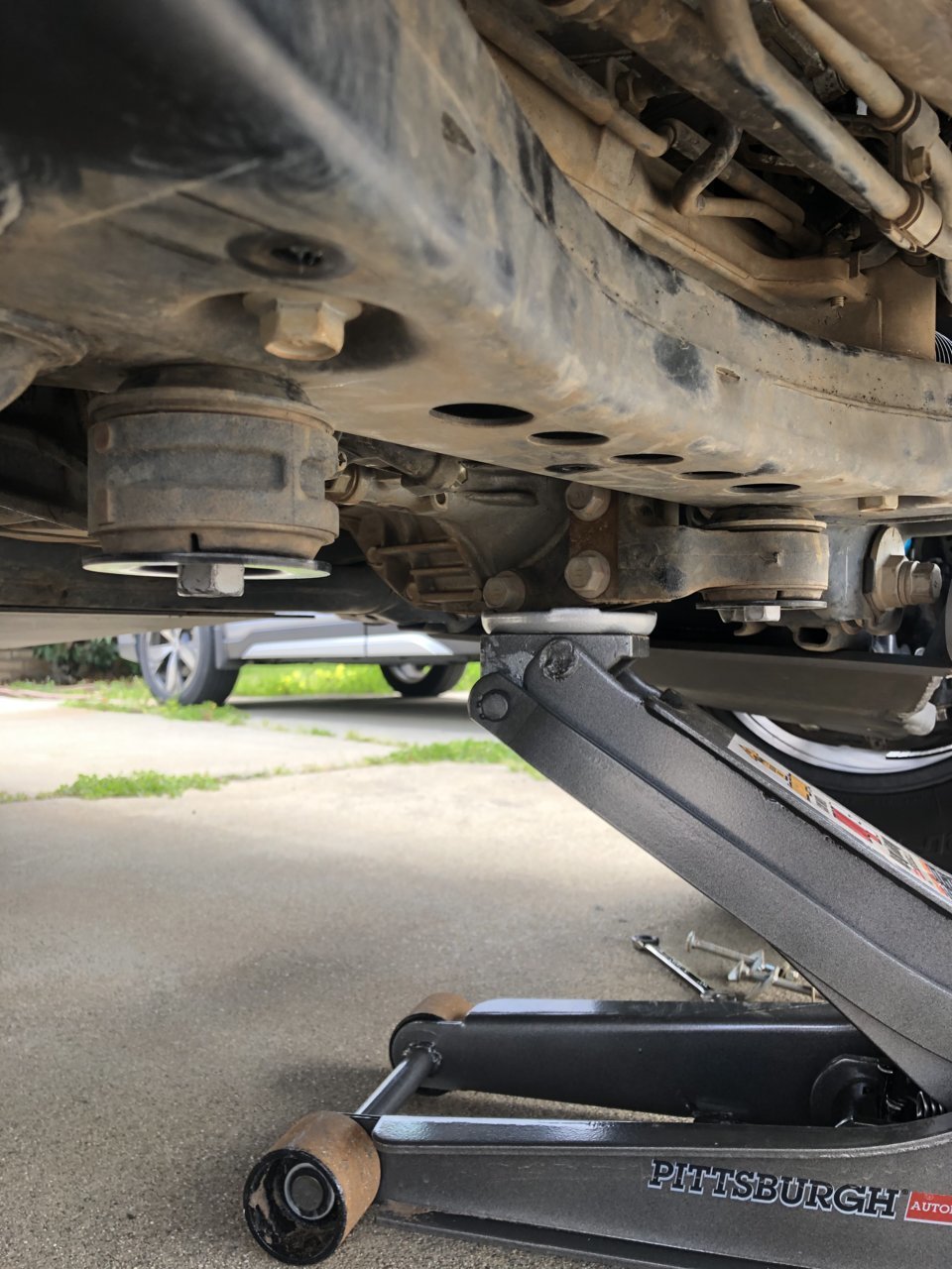

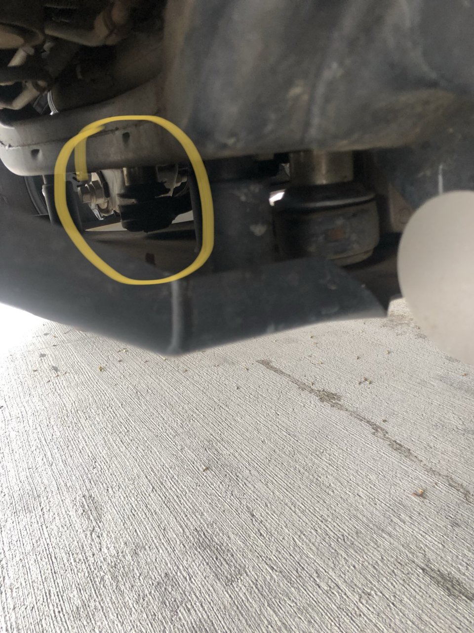

    Yesterday I was cleaning the truck from my off road trip and noticed a big gap on the passenger side where the 2 diff mounts are. The bolts are tight, 4wd works great, no weird noises, just doesn’t look right. Does anyone know what’s up with this?

    Looks like your diff drop spacer was installed wrong.

    looks to need tightened up

    I installed it about 4 years ago, don’t remember it looking like that tho.

    Bolts are both super tight.

    Is there a bushing right there it looks like it’s shot .

    do you really need them ? I would just remove both.

    That’s what I’m thinking. Gunna pull the skid and take a better look tomorrow

    Probably not. Might just remove it tomorrow

    if you have a moderate lift and your stock bolts, just put it back to stock. Good time to inspect those bushings as well. If you go back to stock remove the skid drop spacers as well.

    Just have Kings set at like 2.5. I still have the stock bolts. Gunna remove them Today

    Blown bushing.

    All fixed! Removed the diff drop

    It looks like your isolator didn’t mate properly with the bushing when you torqued it down last time. I would also make sure the mount bolts are tight. Those are the bolts that fasten the arms that hold those bushings.
