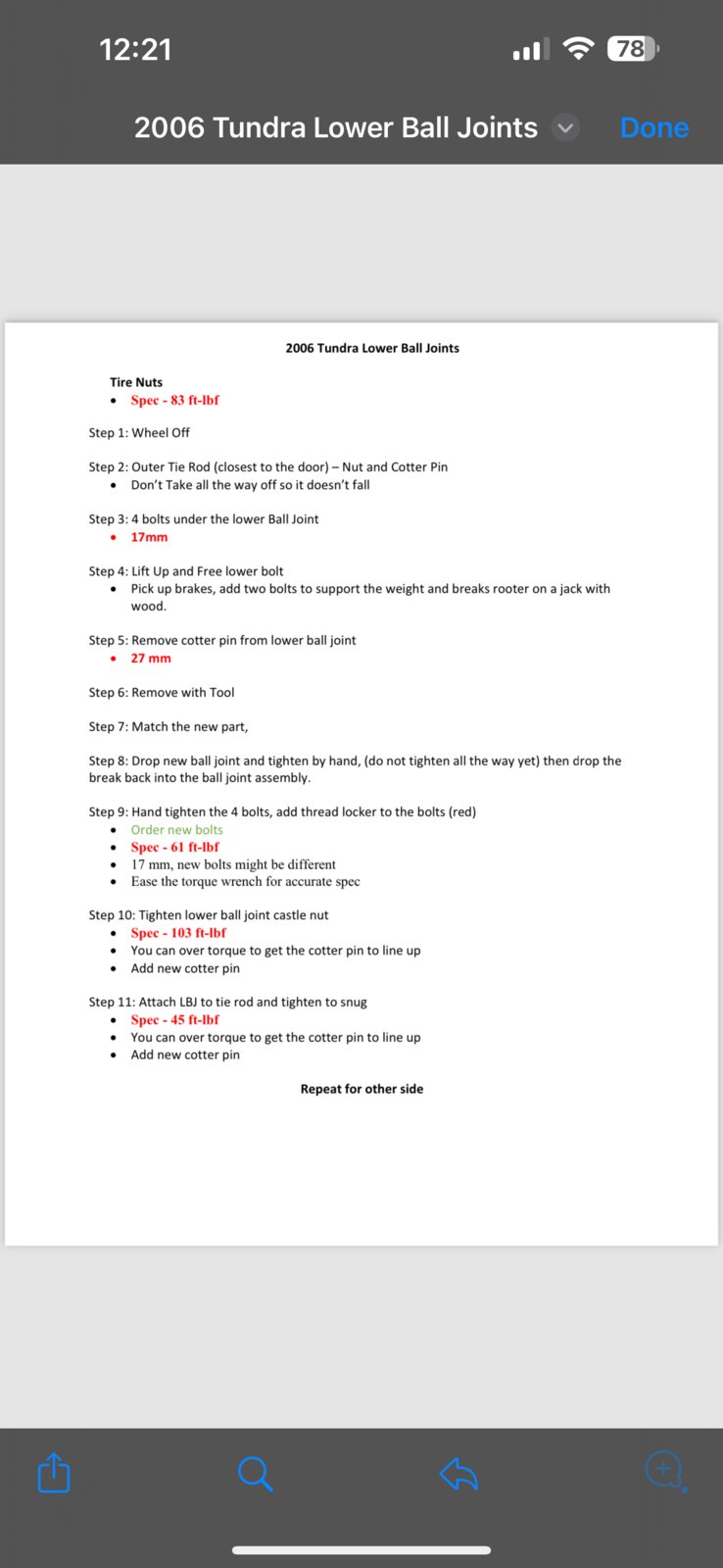

    IMG_8327.png Here are some torque specs and instruction I wrote for myself like 4 years ago. Excuse the typos and grammar
    G_unit3000, woods and Bought2Pull[OP] like this.

    I recommend printing out the torque spec sheets, here are some images to use for 2005-2006, in reply #24: https://www.tundras.com/threads/torque-specs.53443/#post-3353761
    NOTE: Those torque specs show 59ftlb for the LBJ bolts. That is apparently a typo, and high, but it's what many of us here have used with OEM bolts, with good success. I used blue Loctite along with that 59ftlb torque number.
