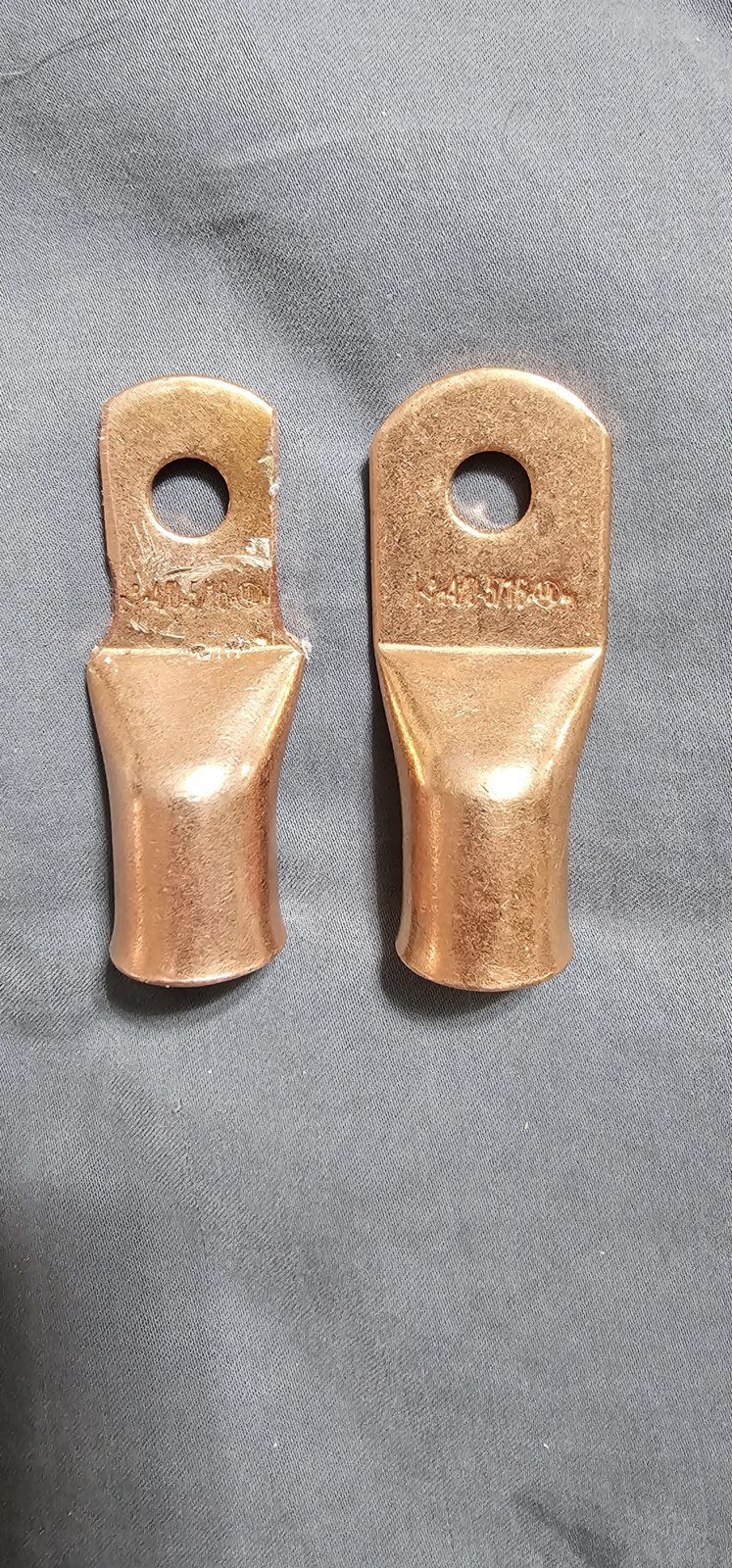

    Below is a picture of a 4/0 pure copper battery connector that I have modified, beside a normal connector, in order to still be able to use the plastic terminal guards on a Renogy 3000w inverter. Kinda crap that a 3000w inverter isn't compatible with 4/0 wire connectors, but that's life. Anyway, does anyone think I am creating an even bigger safety hazard by grinding material off of the copper connector? Thanks in advance.

    I would first try to modify the terminal guard or find a different copper lug brand that fits.

    It possible that the pic they have is for a smaller gauge lug though.

    It’s a heavy wall 4/0 lug though, crimping that probably a PITA
    edit: never mind, it says solder

    No issues, send it.

    Yeah, you will he okay. If it makes you feel better, I frequently set up a 4000 watt directly next to my battery with even less meat clamped onto the inverter posts. Runs air compressors, worm drive circular saws, sawzall, etc. without issue.

    The best solution is to find a lug that works. But if you must use your modified one, make sure the lug is tight to ensure a good connection, and check it after the first few heavy uses to see just how hot it gets.

    The solder or crimp will invariably be the weak point. I would run that without any hesitation.

    I’ve never done 3k watts with a modified terminal but plenty of 1-2k watts and all is well. I’d send it without worrying.

    Thank you! I just bought two of them for the inverter connection. I did, however, buy the 3 crimp lugs instead of the "heat and seat" type. It'll take a few days, but I'll let you know how they work. Good find, and thank you again!
    I may try to do a controlled and heavily observed test on being able to modify like that. Worst case scenario is I burn the place down. I have insurance, so that ain't so bad!

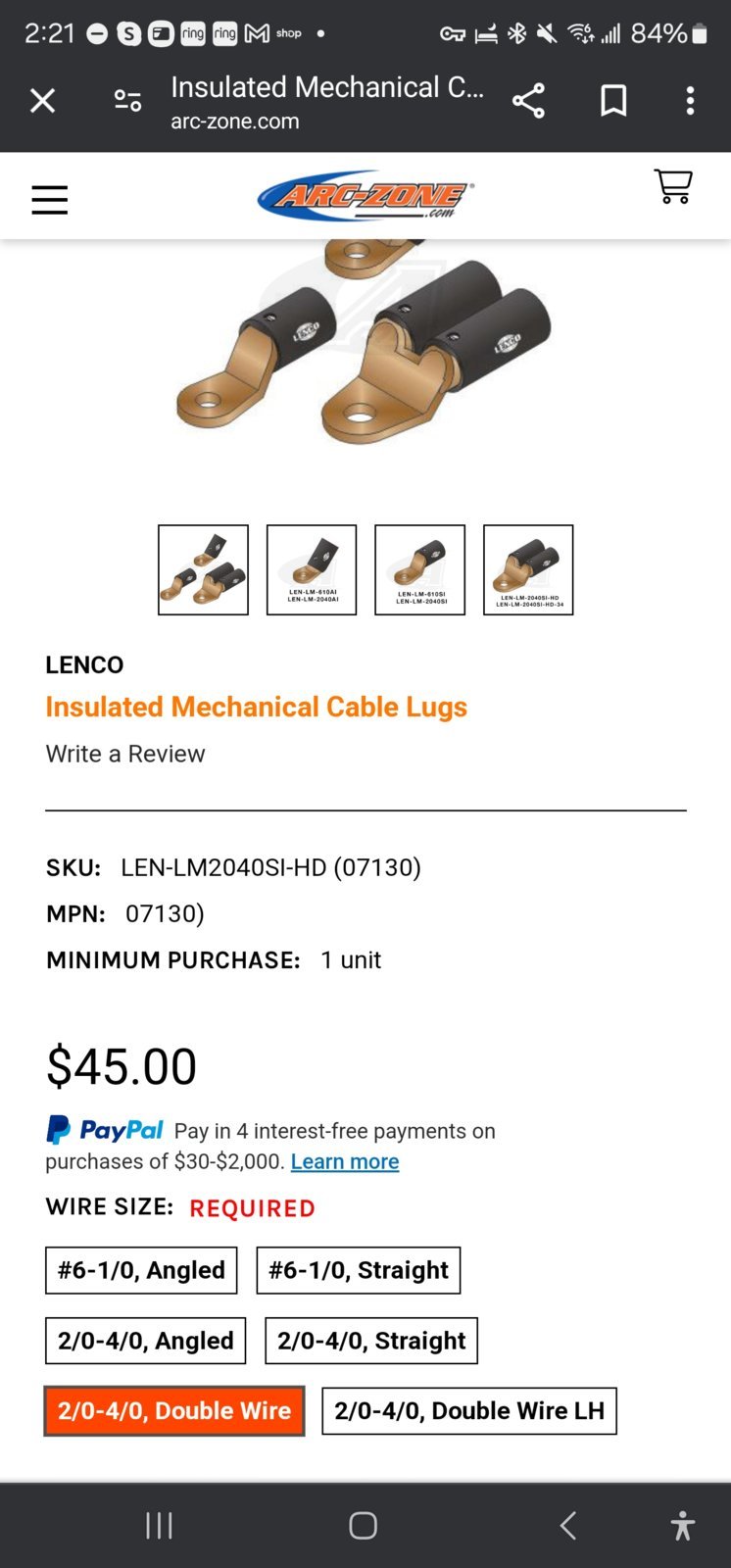

    Found the answer to my own question of "I wonder if they make battery connectors for dual wires?" They do, but for $45 each, they can keep them!
