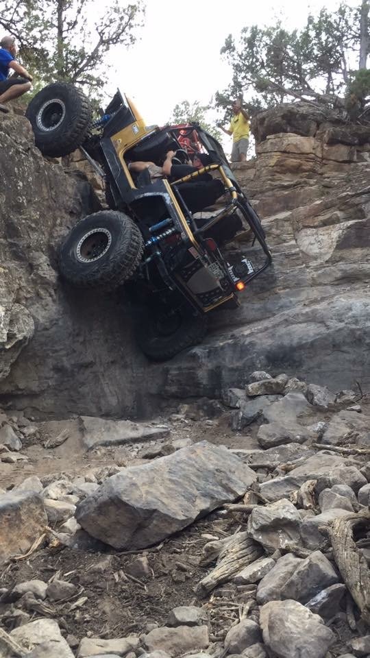

    Here is a fine example.
    Start at 4:30 (unless you want to watch it) We wheel this trail a lot.

    So I just watched that video in its entirety. WTF, you guys do that? Holy balls. We are in different worlds, but I'm kinda pumped. I don't even know what those trucks are, to be honest. I thought Jeep frame, saw a Chevy CAD logo. IDK. But, Ive watched some manufacturer vids of those shocks. I wish I was working with those. Needless to say, I think you know what you are talking about. Thank you. EA
