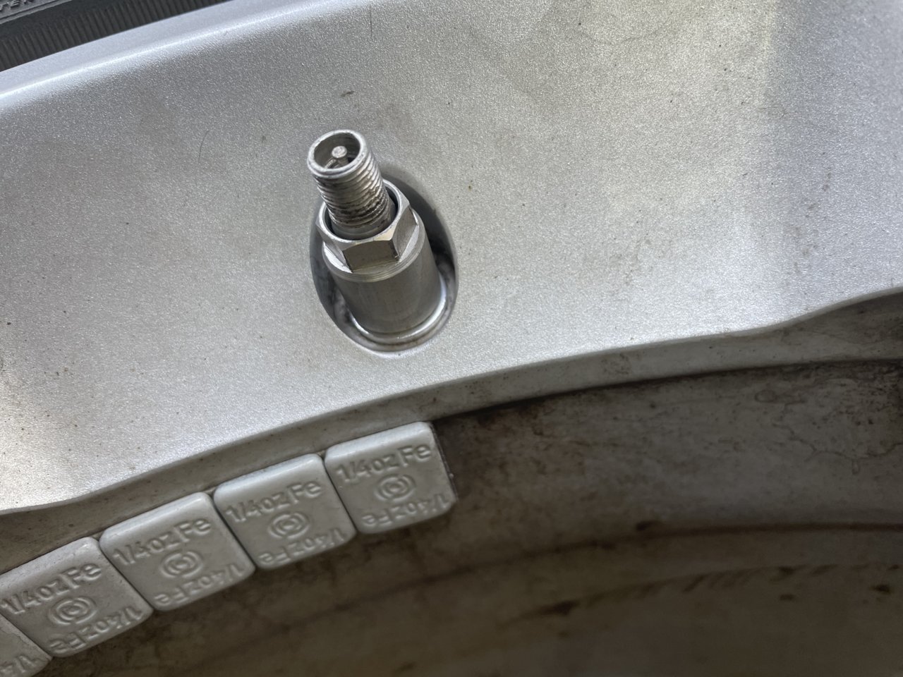

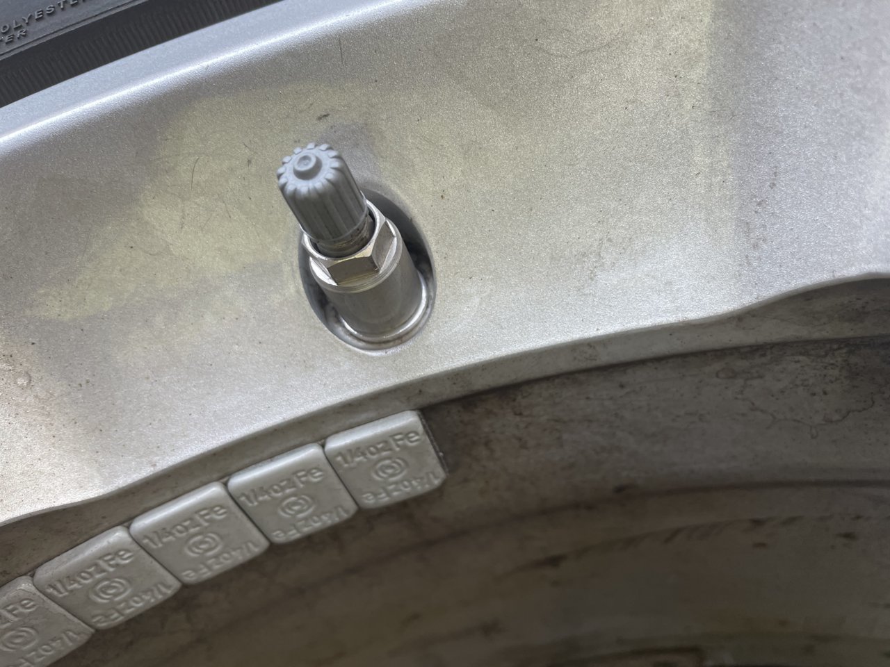

    I do not believe so.
    A6EDE6C1-A73C-474E-8FBB-E469B9100C86.jpg B4DF8FB2-AD23-48A7-95E8-5652B77FD0CD.jpg
  21. Aug 26, 2021 at 11:17 AM
    JeffMac
    JeffMac [OP] 2 Words, 1 Finger
    Oct 31, 2019
    #38081
    280
    Jeff
    South Florida
    2015 Black Tundra OVTUNE
    Suspension: Bilstein 6150 Front Max Setting CB Shim 2x Driver 1x Passenger Bilstein 5160 Rear CB +3 Shackles Firestone Airbags w/ Daystar Craddles Engine: OVTUNE - 87 w/ Torque Modifier SABM w/ K&N Filter TB Coolant Bypass Fumoto Drain Plug Wheels/Tires: ProComp Bandidos 0mm Offset Nitto Exo Grappler AWT 285/70/18 Exterior: TRD Pro Grille Spyder Headlights/Taillights Ecoological Bumpershellz LED everything Tinted windows Bakflip MX4 Tonneau Cover K-Source Tow Mirrors Interior: Pioneer AVH-W4500NEX Radio 2x 10” Pioneer Subwoofers 1200W Pioneer Mono Amp 2000W Pioneer 4 Channel Amp
    Currently at 30 min of spinning this tire around looking for any leaks. Nothing found.
    2421D548-BC6D-4B3F-911F-75BD5F7B1A8C.jpg 04CF1E79-F8FC-42E2-ADA3-A7D591547F5B.jpg
    YardBird likes this.
  22. Aug 26, 2021 at 11:24 AM
    32,914
    The rock or object would be in the cap; not the actual valve stem.
    JeffMac[QUOTED][OP] likes this.

    I have a jeep that had a annoying leak after getting tires replaced, it would leak down to 15 to 20 psi, sometimes it took weeks or days. So after a few moths i found time to find out how it was leaking. It turned out to be the rim and it was a small fracture under the weight clip, most likely happened from when they pulled the other weight off. The rim is aluminum and the cheep way i found to fix it was every few years i give it dose of tire slime and it's made it over 8 years. (Knock on wood)
    A bottle of fantastic also works good but maybe try spraying it on with the weight on the tire in case you have a fracture or a bad casting for the rim. Good luck..Screenshot_20210826-211004_Google.jpg
