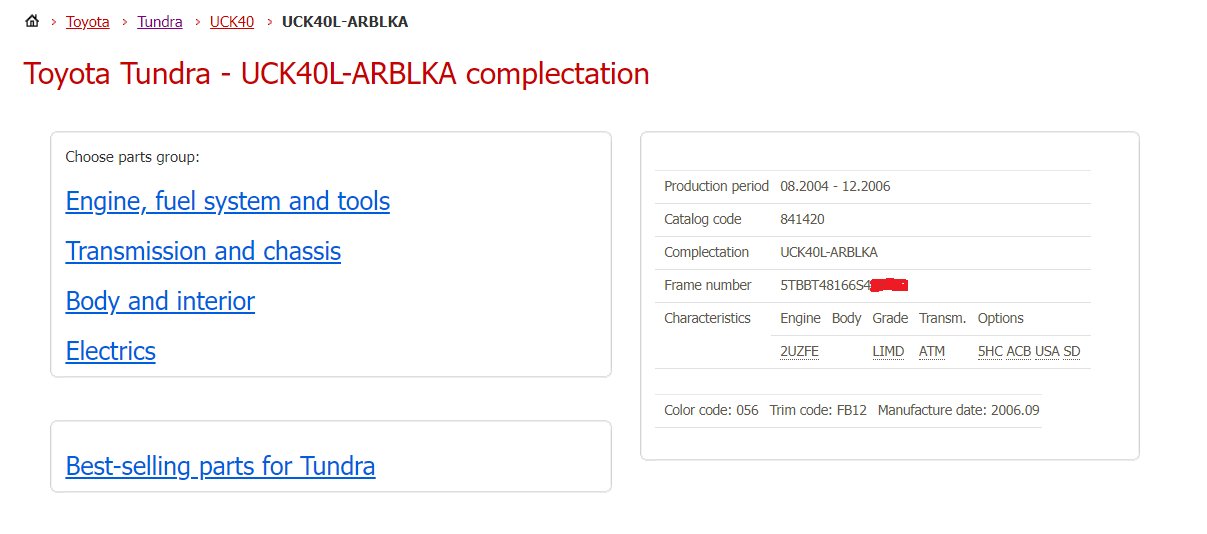

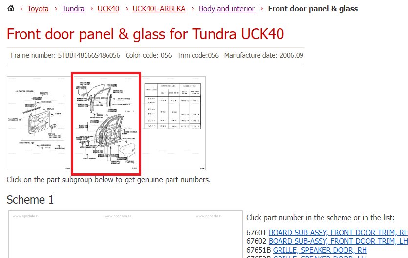

    For DC 2006, here's the parts page for you to verify these numbers are correct with your own eyes, since I could be mistaken.
    I'm a bit confused, so you may want to ping a dealership. The 1st link to Front Door shows two part numbers for the front motor/regulator. The 2nd link, for rear door, shows both rear and front motor/regulator, but the fronts are universal and there are two diff't part numbers. Weird. Actually, the regulator is just the scissor arm. But in that case, I can't find the damn motor for rear then.
    Front door: https://parts.toyota.com/a/Toyota_2...DOOR-WINDOW-REGULATOR--HINGE/841420-6754.html
    Rear door: https://parts.toyota.com/a/Toyota_2...DOOR-WINDOW-REGULATOR--HINGE/841420-6757.html

    Best bet is probably to pop the door card off, take the part number off the existing motor and seek out a replacement that way, if I'm being honest.

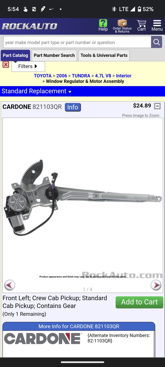

    Unfortunately it shows the only left side one is without the track? It's pictured at all with the "x". We shall see if the little feet that glide in the track will go on to this new part..

    I'm not sure what you mean regarding the track. But all of these regulators "scissor" out, that picture you posted above is of the "scissor" fully compressed down. It will extend like in the other photos. See this link below for the Aisin part (which personally I would use), it shows the regulator extended upwards more:
    https://www.rockauto.com/en/moreinfo.php?pk=11348037&cc=1432861&pt=15596&jsn=15

    I figured it was just closed but thought it was weird that every other one, though they weren't for the drivers of a double cab showed it with the 2 tracks the scissors glide in... trying to avoid getting an incorrect part or whatever.
    I'm not seeing on the 1 you just posted that it shows what side it's for. But if I punch it in to Toyota it shows right side. Wtf am I missing?

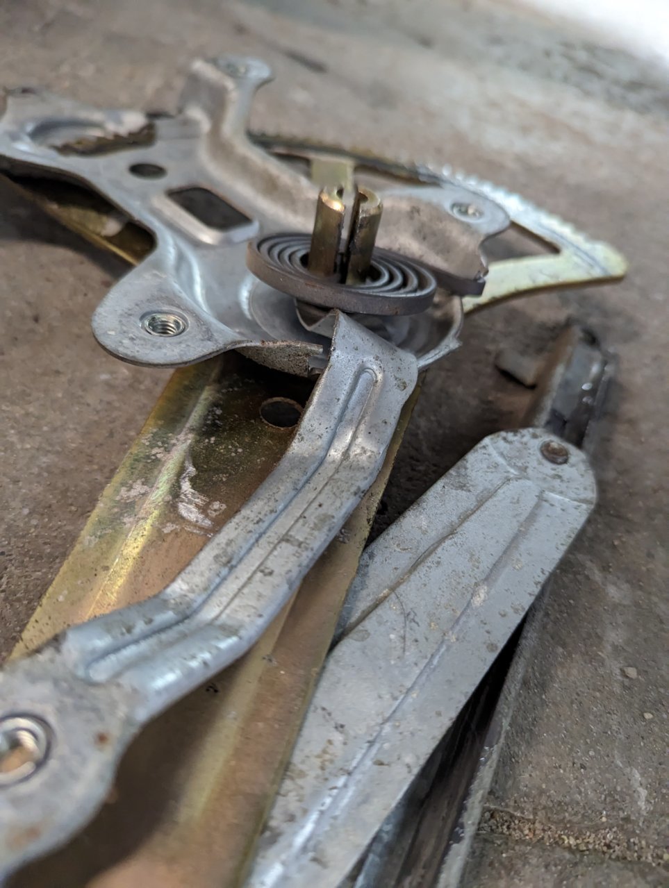

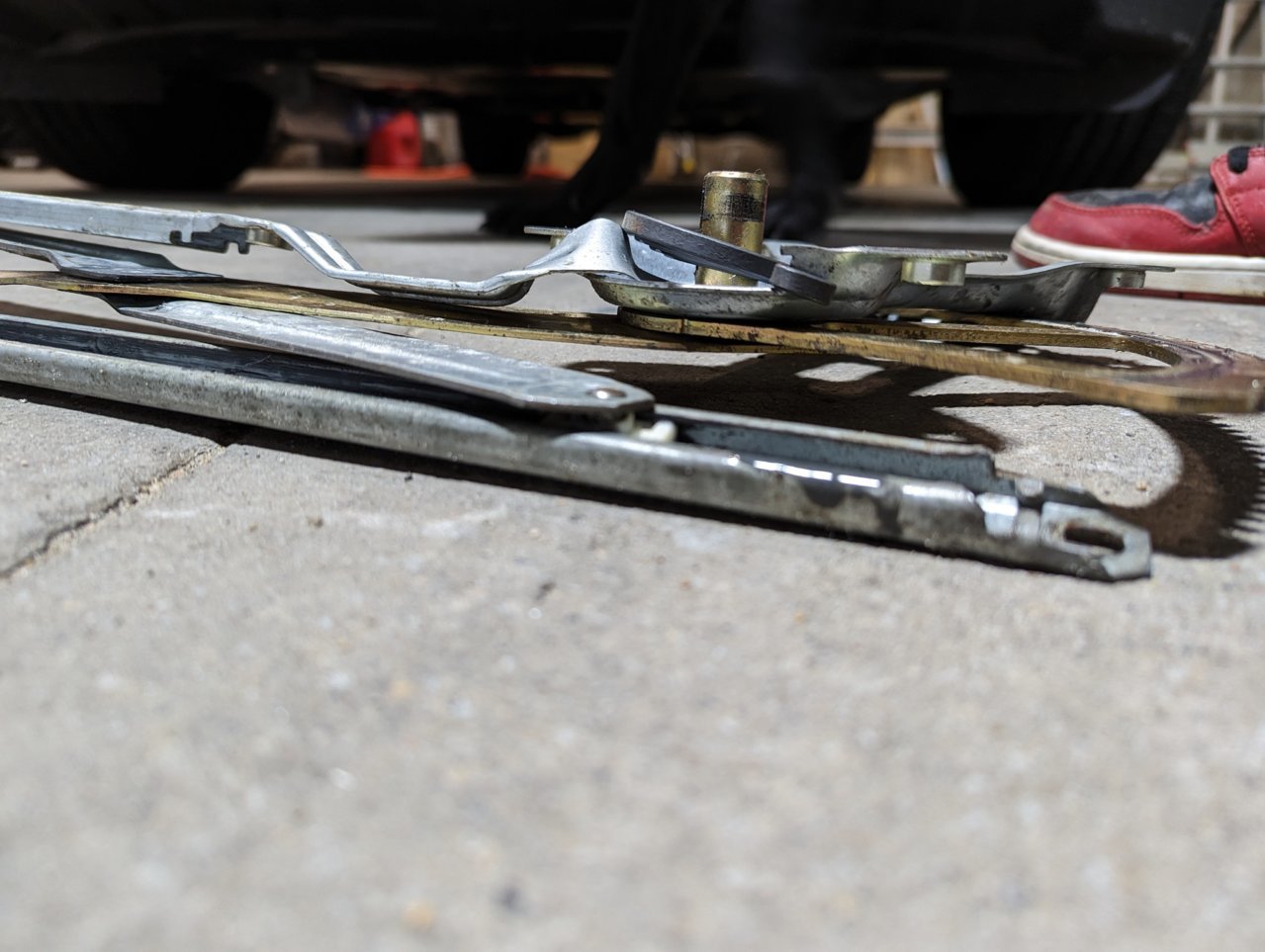

    I apparently forgot to take pictures when I did that. I had an arm that was very bent causing allignment issues and had to close the window by pushing on it from the outside.

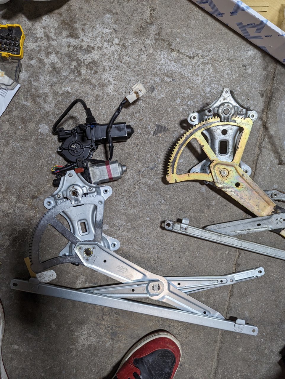

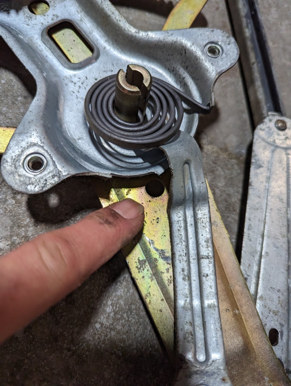

    Bought the Aisin regulator and a dorman? Motor from RA. Even though the motor I thought I purchased says it is to OEM/ exceeds yada yada it wasn't gonna work. I did replace the regulator though.
    After replacing the regulator ( sort of a tricky fuck) as it's not exactly the same but not rocket science. I tested the window. At first it was exactly the same, slow in the same spot then smooth. After pushing in on the door some while rolling up and down it seemed to be a touch better. Sprayed some lithium spray in the tracks, was in a pinch thought I had silicone but didn't. That did seem to help. Way better than before but just can't figure out what exactly is the damn problem. I'm thinking a combination of 2 things? This regulator that I replaced and dirty shitty tracks in need of lube. The old regulator had to be part of it unless it was made this fucked up but I find that hard to believe.

    Just an update as I'm still struggling with a window that's about the same but seems to shift forward more when rolling down. Going to trouble shoot some more here after a while.

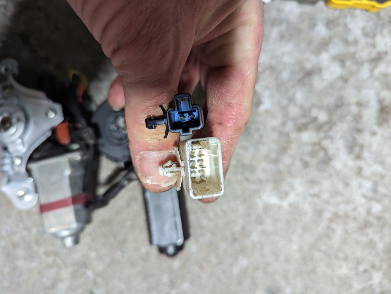

    I replaced the regulator but couldn't use the motor as it has a 2 pin connector. Went through the b.s. on RA website....blah blah. After calling the manufacturer of the part it turns out that the motor is for a regular cab or access cab. So if you order part #471103 Cardone for your DC it ain't gon fit! Waiting on a reply from RA lack luster or lack of CS.

    I went through the AC/RC vs. DC regulator thing recently searching parts for someone else. Or was it on this thread? I forget. I also saw the parts were diff. That's why I reco'd contacting the dealership, I think. If you have the OEM replacement p/n, it's easier to find the aftermarket comparison. Even if OEM is discontinued.

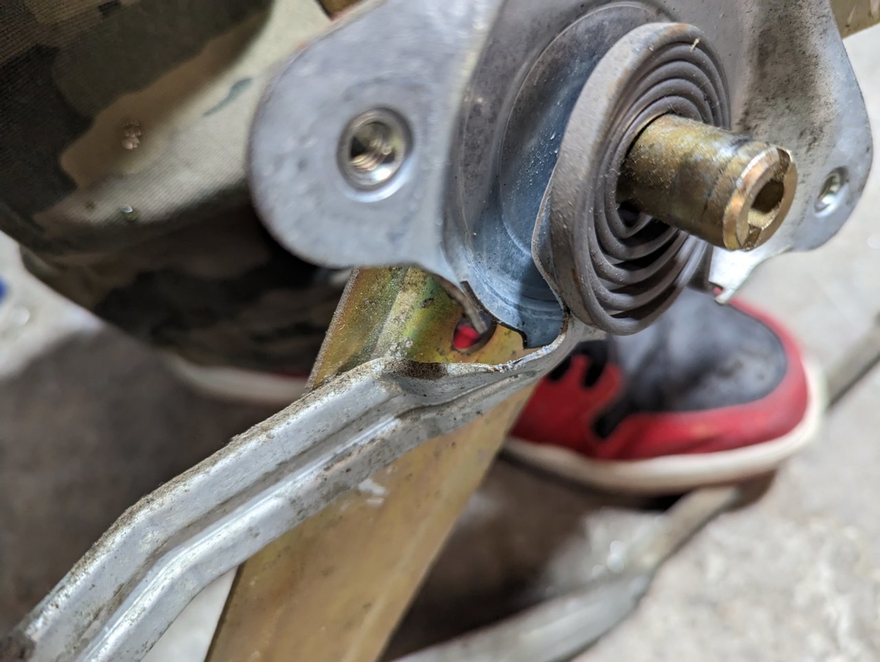

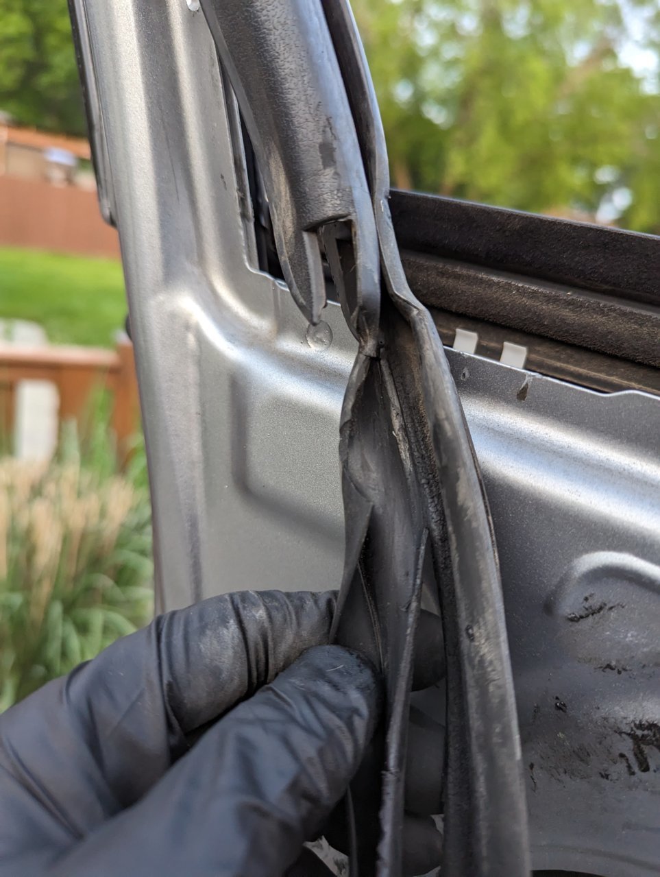

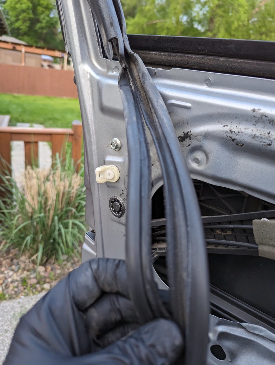

    So I thought I had this whole the ng fixed with the sly-gluyde shit. Apparently that was a band-aid. Dug in deeper today as I had a little rattle manifesting and driving me nuts.
    Got to tinkering around in there, pulled the glass out to see better at what I thought may be the problem without taking pass door panel off to compare. Turns out I have found the problem because the regulator and motor move just fine without the glass in. Rubber in the track torn assuming it's allowing it to grab with grime and dirt and bind up in the track and it all makes sense with the picture. Just need to see. If I can track this part down now.

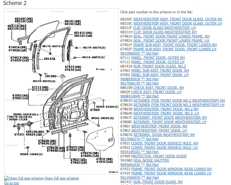

    Is there a part number in any of the corners of that? Should be molded into the molded joint either in top left corner or smaller corner at the front of the door. Good find!
    If that part, is what I think it is, it will most likely be made here at my factory in service area #1

    Upside: That part is available, at least it was for mine. Additionally, installing a new one supposedly fixes the window-rattles-when-2/3-closed-or-less problem. It'll be cool to hear you confirm the latter.
    Downside: It's pretty gd expensive.

    I didn't wanna pull it all the way out until I had another one because of the stiff part closest to the b-pillar. Seems like once you deform.it it doesn't wanna go back to original shape.
    Where do you work? I assume I can't order from there lol.

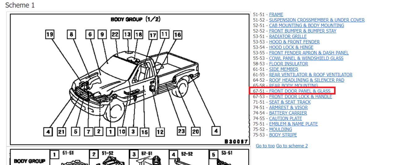

    Yeah, RC/AC windows shaped different than the DC, so you'll need the part with Double Cab, or lacking "without double cab" language. There is another parts system you can use for exploded diagrams, I'd need to dig a little bit to pull it up. It's the one linked to PartSouq or something, I think. Or the Russians. EDIT: Yep it was the Russians. Give this part lookup tool a shot using your VIN (VIN = "Frame number"): https://toyota-usa.epc-data.com/tundra/
    Once inside you'll want to pick Body and Interior.
    Then Front Door Panel and Glass
    Then click the 2nd pic and choose from the parts in it.
    It gives you a part number when you click the links to the right of the picture, OR if you click the actual part reference number inside the exploded diagram.
    Hi06silver[OP] likes this.
