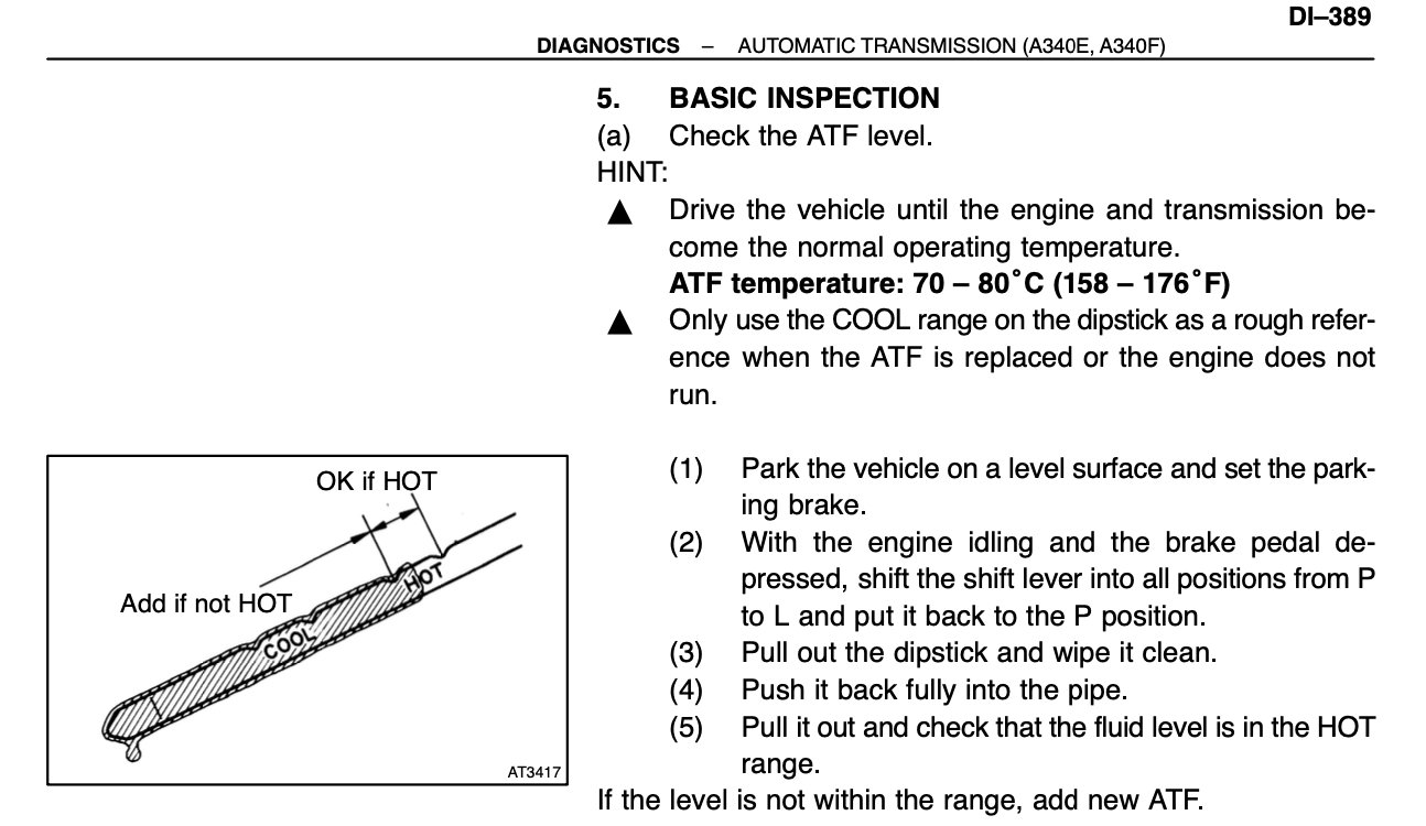

  7. May 30, 2024 at 6:36 PM
    JakeJake
    JakeJake Slippery Snake
    Jul 19, 2023
    #100515
    1,413
    2000 Tundra AC 4X4
    You should run through the full range as described and recheck.

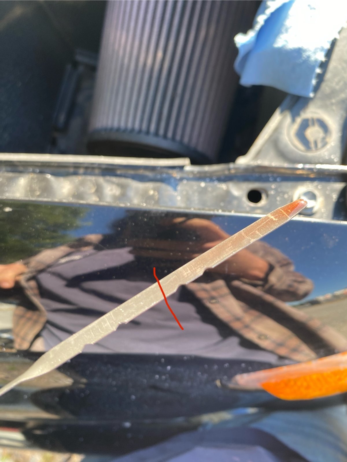

  9. May 31, 2024 at 4:54 AM

    level is here

  11. May 31, 2024 at 5:40 AM
    w666
    w666 D. None of the above
    Dec 17, 2019
    #40020
    1,765
    Maryland
    04 Access Cab SR5 V8 4WD
    Looks like you're nearly 1 qt low
  12. May 31, 2024 at 5:43 AM
    JakeJake
    Jul 19, 2023
    #100515
    1,413
    2000 Tundra AC 4X4
    At least.
    Just to confirm this is idling at operating temperature after manually shifting through the range?
    FrenchToasty likes this.

  14. May 31, 2024 at 6:03 AM
    Zach_795
    Zach_795 [OP] Master Apprentice
    Dec 17, 2021
    #71903
    76
    Virginia
    2002 4.7L Limited 4WD
    K&N Cold Air Intake PowerStop Z36 Extreme Performance Brakes, drilled and slotted, red calipers and drums Midland 75-822 CB w/ 3’ FireStik antenna JBA Silver Ceramic Shorty Headers BFGoodrich T/A KO2 LT265/65R17 tires 4Runner Sport 6 spoke 17” wheels Remote control exhaust cut-out Ruthenium spark plugs 12-hole injectors 20% tint all around 35% windshield Weathertech mats and window flares Grille guard with twin spot light bars, wired to high beams 2.5” RC lift front and back KSP Upper Control Arms Full led replacement 6000k
    Yes

  16. May 31, 2024 at 3:03 PM
    Zach_795
    Dec 17, 2021
    #71903
    76
    Virginia
    Put a half a quart of dex 3 in it and drove home from work, everything seemed back to normal. Got almost back home and was driving up a hill at about 60 no cruise, and it wasn’t slipping, felt fine. Then the check engine light started flashing. Before I got to the driveway the light went off. Got to the garage and the stored code was P0305 (Cylinder 5 misfire detected). Went and re-created the scenario I just did, same result. Cel came on going up the hill and went away after. Tried again with the O/D off and the light never came on, but the motor bogged slightly. (I cleared the code before each attempt). Pulled #5 spark plug and ignition coil they both look fine, both are less than 10k old.
    What the hell is going on?
