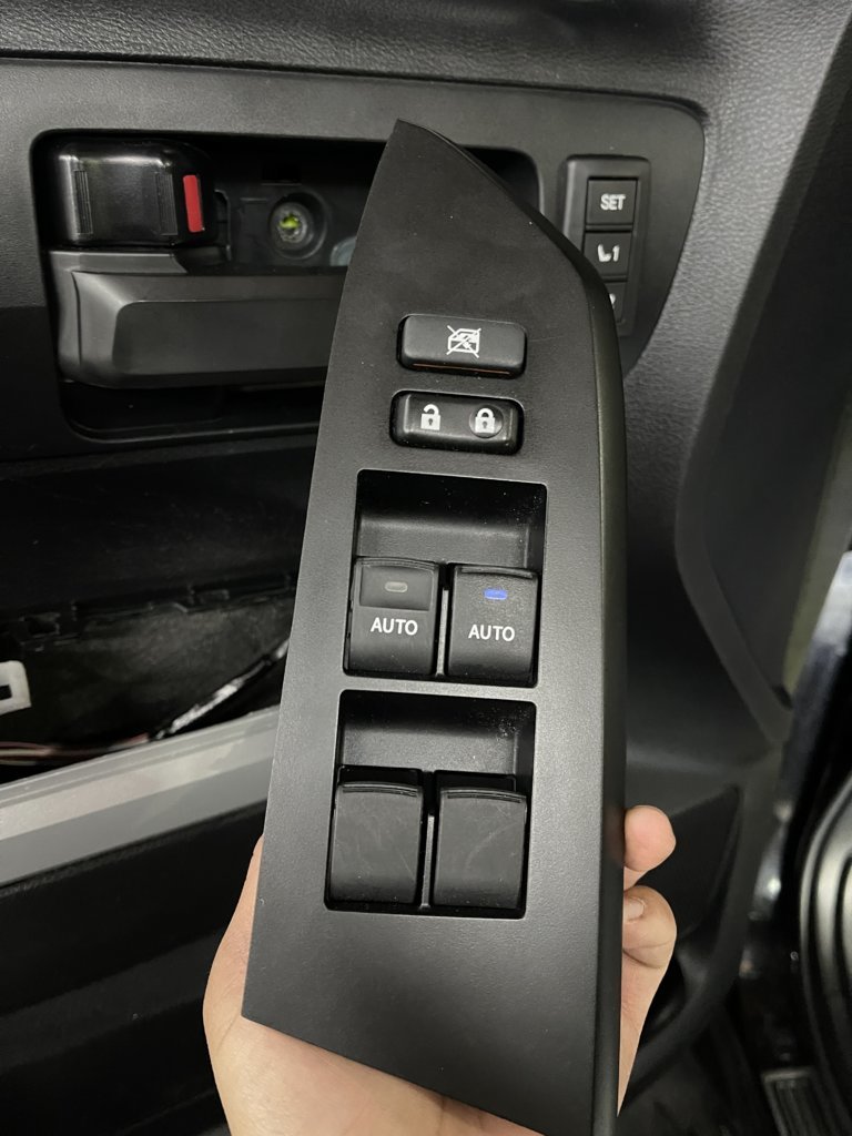

    I got done with the deadening project and after putting everything back the driver side window switch will not light up or roll down. It will control all the other windows fine. Just the driver’s side not working. I checked all the wiring after pulling the door card off. Nothing is shear or broken wire. Is the switch dead? Picture below show only the passenger side lit up blue. The driver’s button is not.
    Any idea?

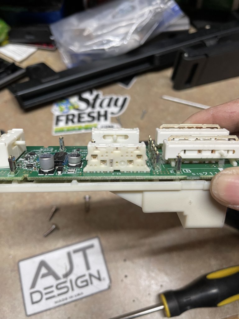

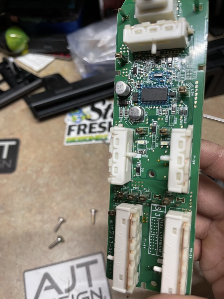

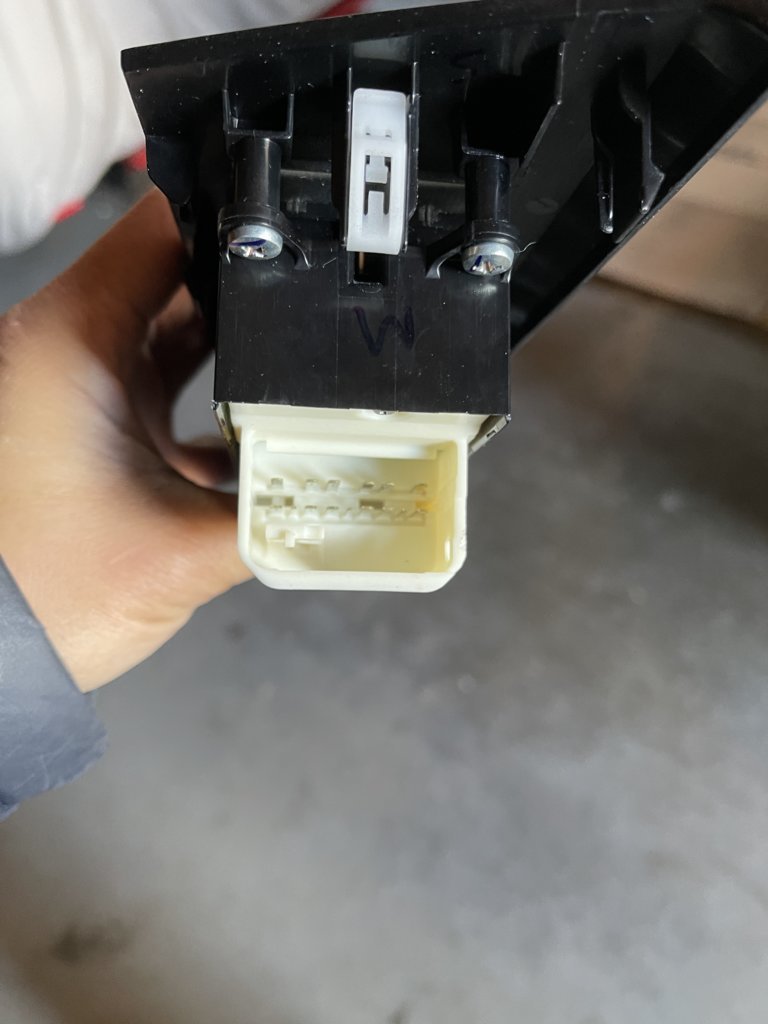

    Even checked the odd ball 30a square fuse with purple tinted lid and all 4 have continuity. All the 20a door fuses under dash are good. The 20a Power No. 1 from the engine fuse box is also good.
    Still dont understand why everything else on the master switch works except for the driver’s side button.

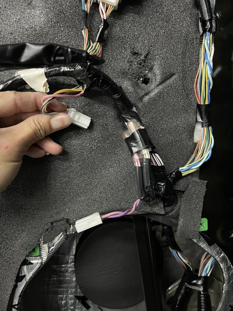

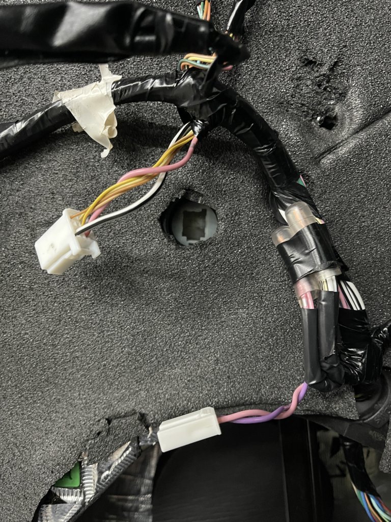

    Solved!!
    i forgot to plug in the power plug for the regulator motor. Had covered it with Dynaliner and totally spaced it.
    Wasn't til i watched a YouTube vid on how to replace the regulator motor, when it show you need to remove this plug that’s when it dawn on me. That I AM an IDIOT!!
