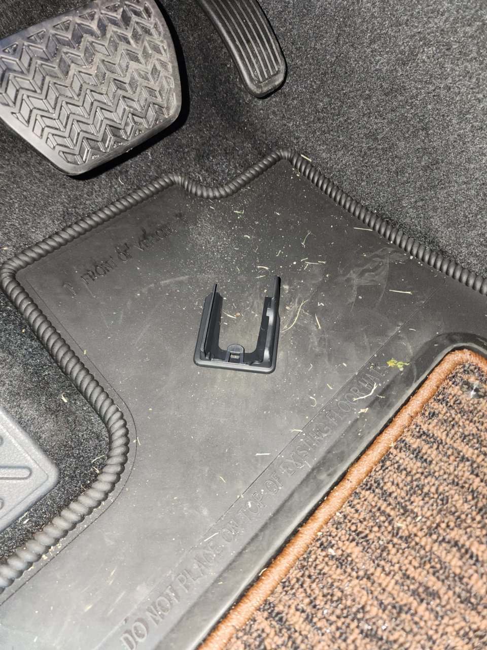

    Brand new 2023 1794, less than 150 miles on it.
    Opened the car today to go somewhere and this was exactly where it's pictured. Looked under dash didn't see any obvious place it goes.

    Left front end of the Driver seat track. Compare to the Pass Side

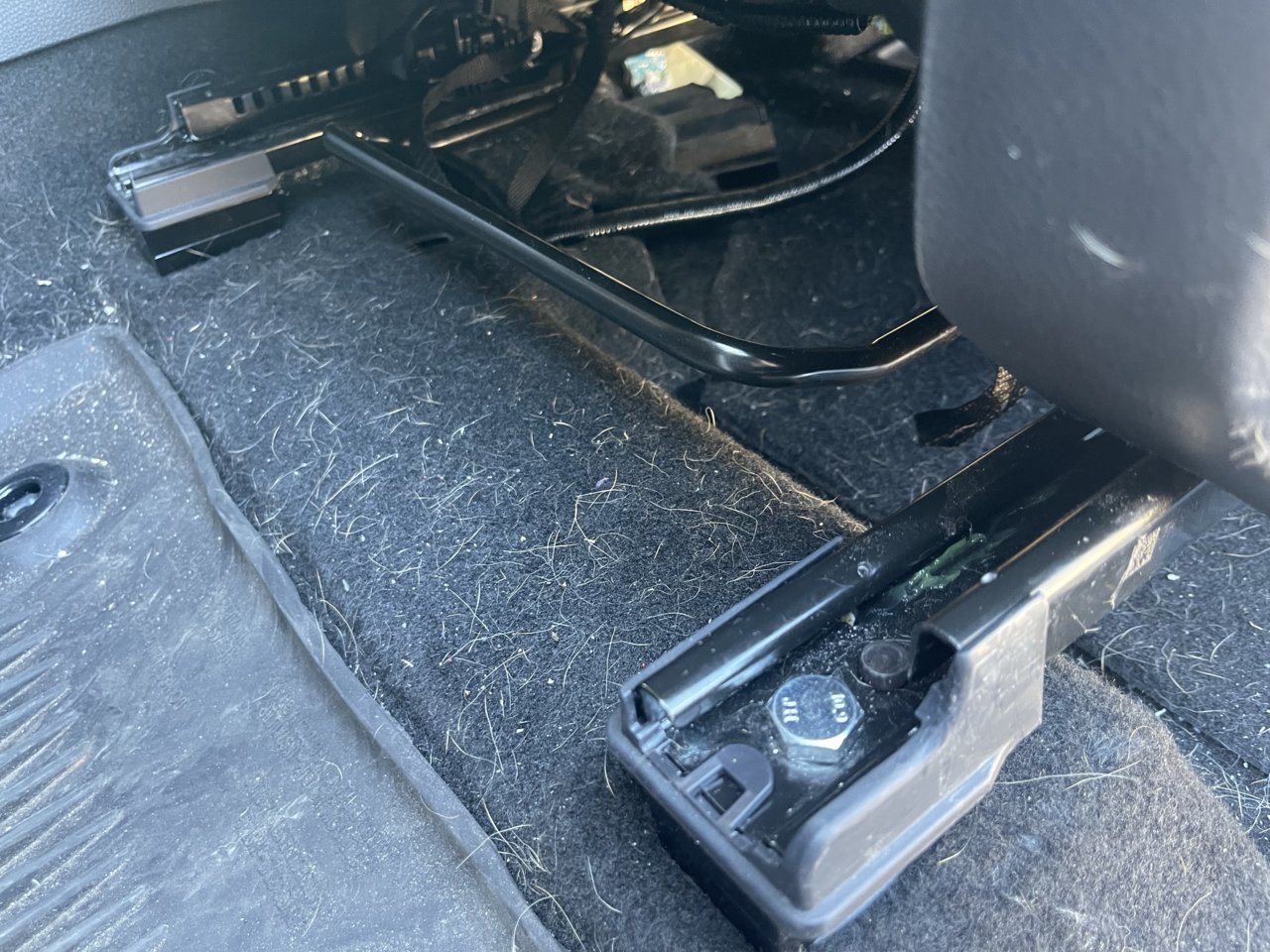

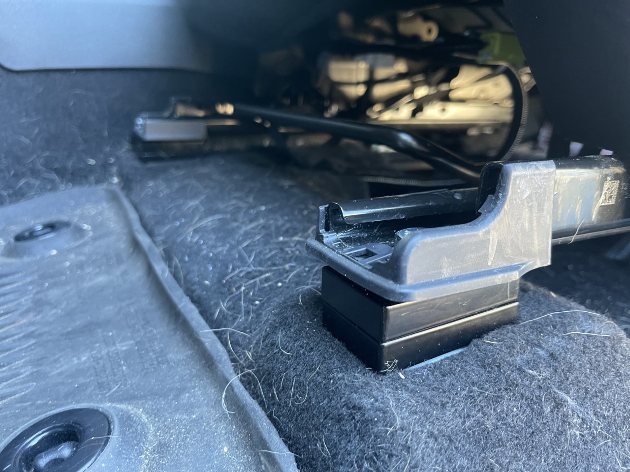

    Here’s a couple of pics of that trim up close.
    I snapped some pics of the install of my @DesertDoesIt Seatjackers for my build thread. They show the trim pieces and where they attach to the seat rails.
    Hope these help.

    Yeah. It’s funny but I do understand it. There is nothing but a tiny, plastic friction clip holding this on.
    It’s easy to kick off. Especially if you’re a tall person who has the seat far back on the slide rails. When you have the seat slid back, the front of the rails (where this trim is) is very exposed.

    Thanks so much everyone.
    I'm gana reinstall. Seems really odd to me but stuff happens.
