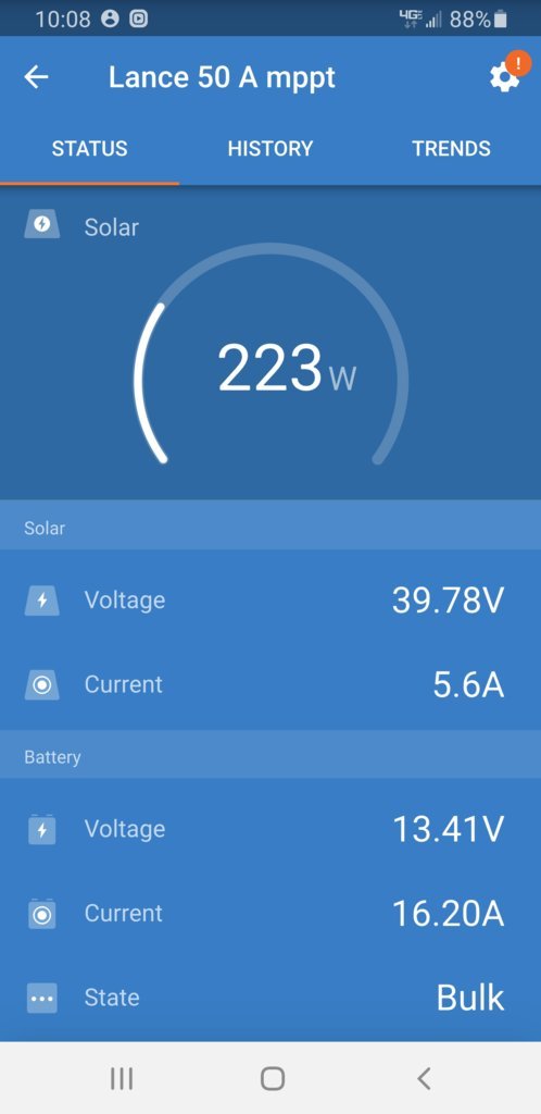

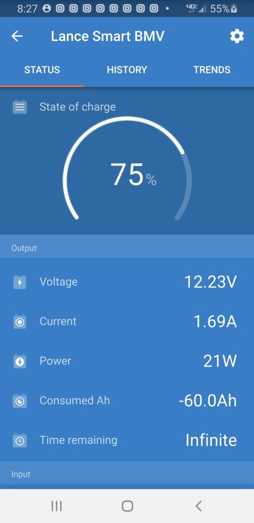

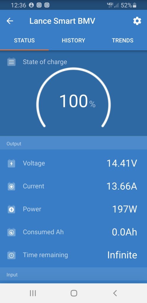

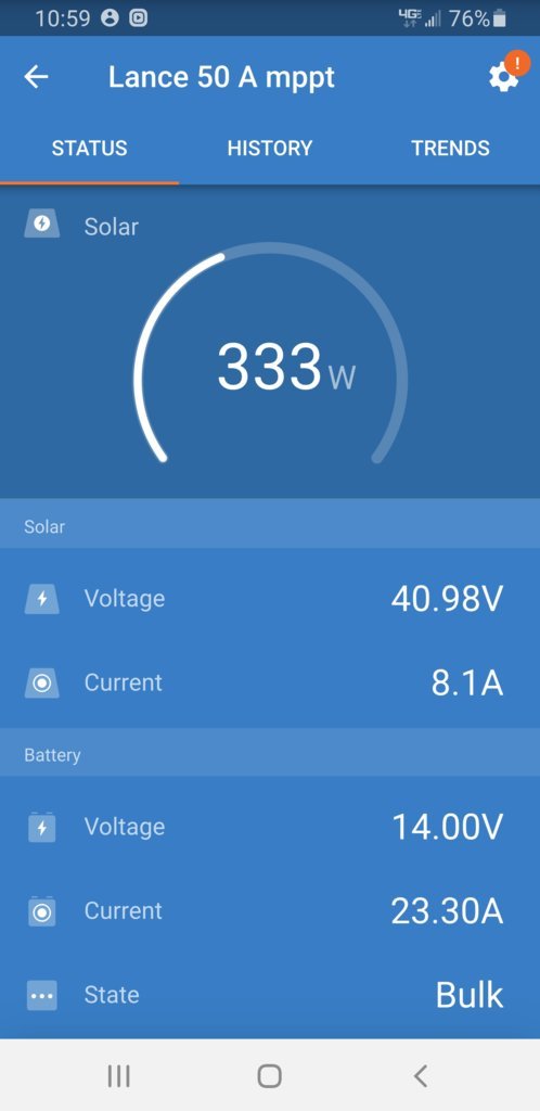

    So the first trip out after getting the rooftop system installed was a really interesting demonstration of that.
    We were camping down in Borrego (Southern CA desert) and it was clear but with BIG clouds that would blow over.
    I have the Victron app and a smart shunt so you can see everything on your phone real time - output, consumption, state of charge, voltage, amps, draw, everything in real time or historically.
    You could watch the output drop when a big cloud blew in front of the sun and then bump back up when it cleared.
    This was in January, so the sun was about as low in it's arc as it gets.
    I think the highest I saw that day was maybe 380W (out of 600W of panels mounted flat) and when a cloud would pass it'd go to 225-250W
    That's why I opted to go with the 600W (three 200W panels) instead of the 400 (four 100W) I initially planned on. Cheaper to add a panel than mess with tilting brackets. Unless you're on the equator in July, you're rarely going to see the full "rated" output of your panels.

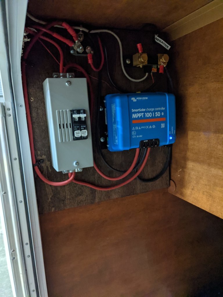

    Will you be charging the trailer batteries too? If so you definitely need a controller, and if you get one get a Victron.
    If only charging the Ecoflow, I THINK (and I could be totally wrong on this) but I think they have an internal controller. DO NOT take my word for this.

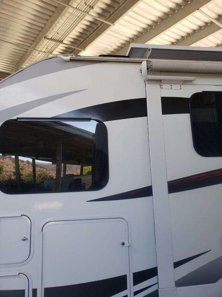

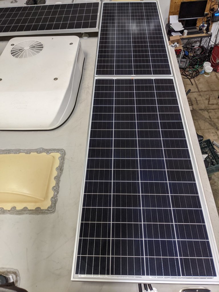

    Best thing I've done to the trailer since we bought it!
    I started with two Grp 24's, got a 100W portable solar suitcase, somewhat manageable but problematic if we ran the furnace much or left to go exploring (I didn't like leaving the suitcase out unattended)
    Upgraded to two Grp 31 batteries, much better but still same suitcase issue since we go do stuff during peak sun hours. Reasonable reserves but power was always in the back of my mind.
    Added the exact things on your list and now the only time I think about power is to occasionally look at my Victron app and laugh like a Bond villain mad with power. Muah ha haaaa!!

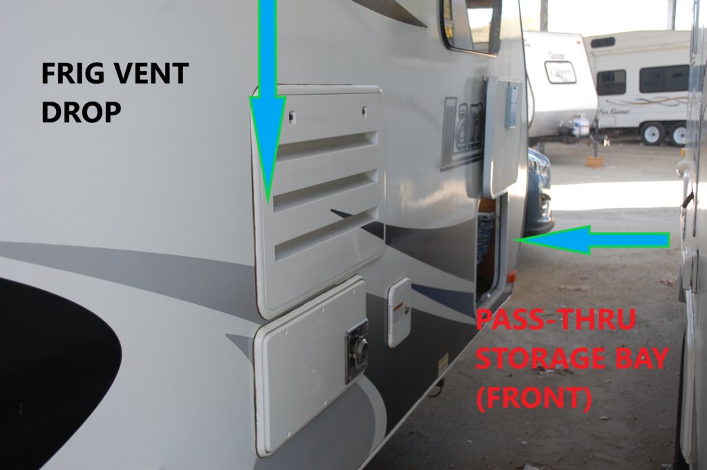

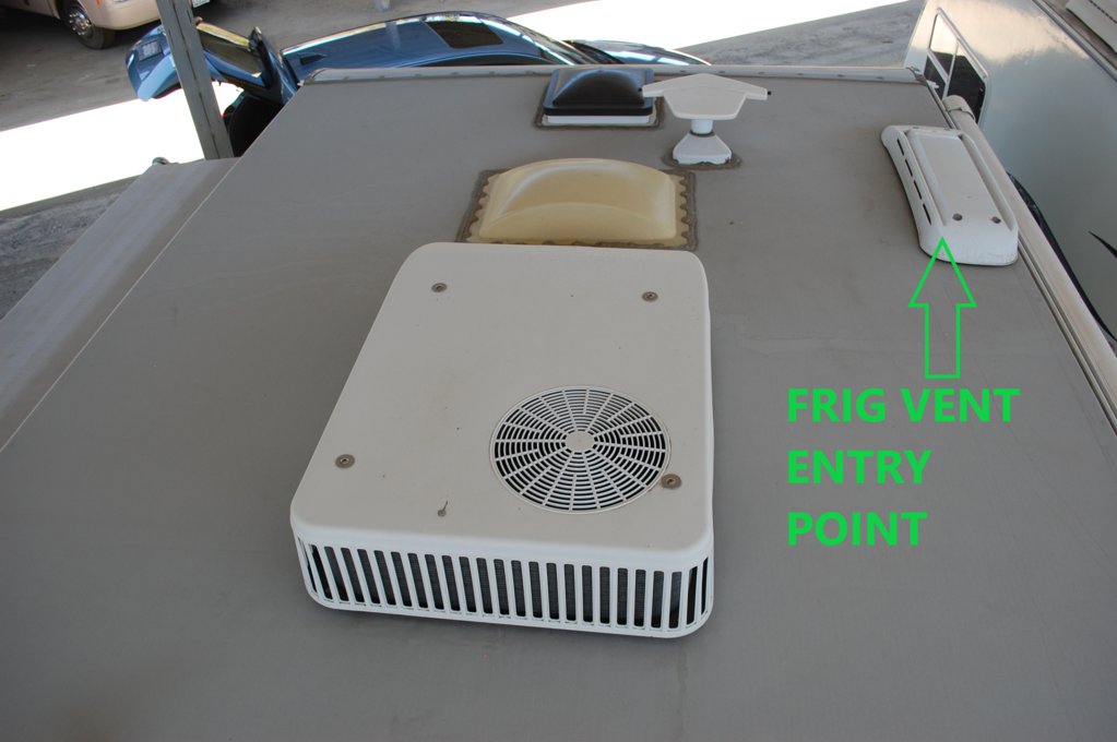

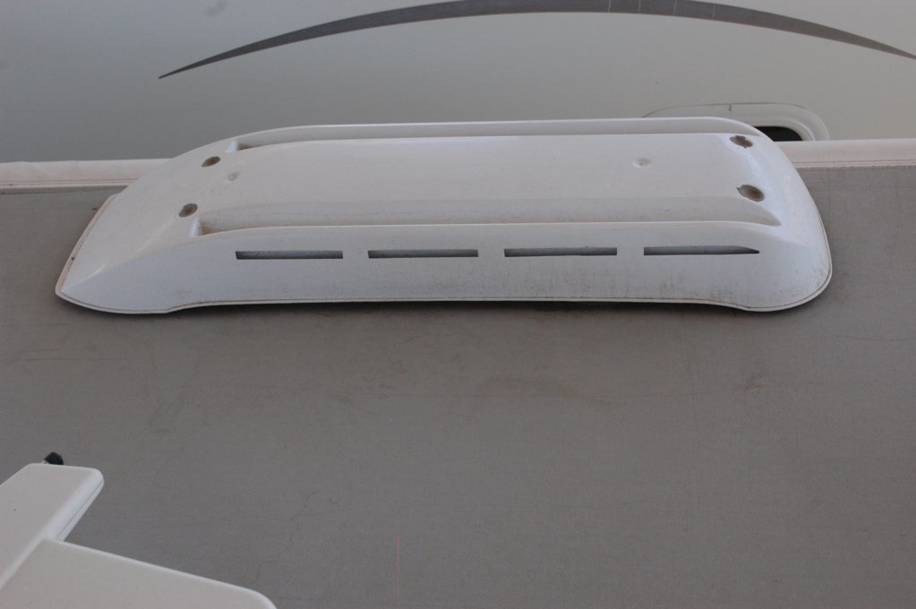

    Anyone know a decent way to pass solar wires inside? Right now I'm using a flat cable through the window, not really ideal. But gets the job done.

    My installer used a cable gland.
    This one was made by AM Solar who was one of the best RV solar outfits around, but my understanding is that they closed up shop. I'm sure there's other versions though.
    Renogy sells one: https://www.renogy.com/renogy-solar-double-cable-entry-gland/
    This route does involve a hole in your roof. I dunno' what trailer you have but you can usually get a roof schematic from the mfg.

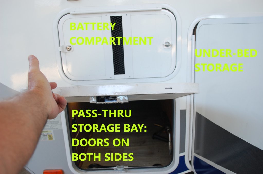

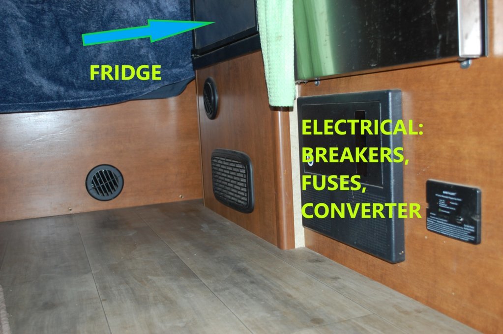

    The good part about using the entry gland and putting it where they did is that it's directly above an existing wire chase and very close to my battery compartment, so it probably cut the length of my wire run from panels to controller in half.
    Thank goodness wifey was scared of me drilling holes in our perfectly good roof and suggested we just pay a professional, 'cuz I wasn't looking forward to doing the install, but had I gone with the initial plan of doing it myself, I probably would have come in through the frig vent and down, then across in one of the storage bays. This is how the Lance units that are done at the factory route it, and they put the controller by the frig with the other monitor for holding tanks, etc.
    Not ideal as it lengthens the wire distance from charge controller to batteries, but with an upside of no new roof penetration since you just come through the side of the vent.
    Forgot I still had all these pictures from when I was in the planning stages.
    Trailers are all different in layout and routing, but the general principal is the same so maybe these will be of some benefit to someone.
